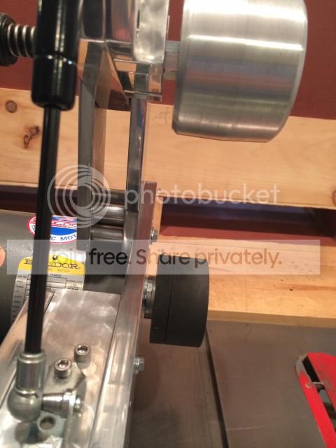

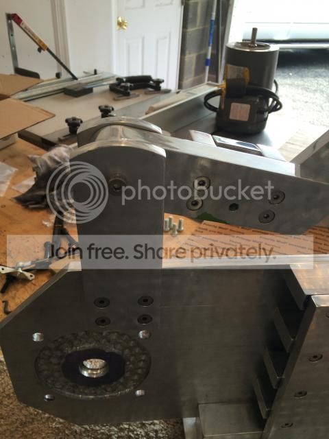

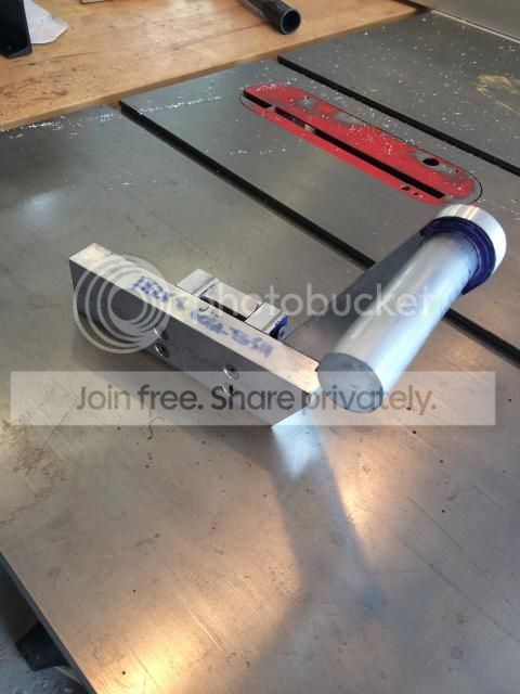

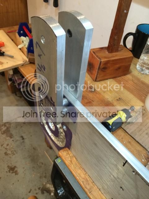

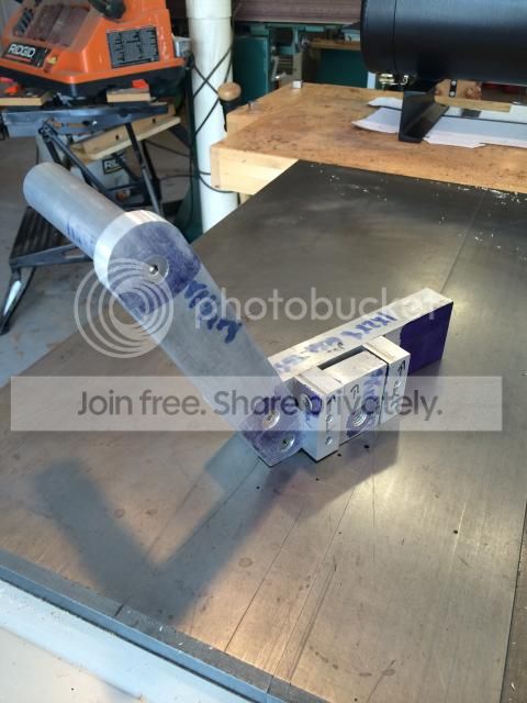

A rough tracking mechanism. This was the first component I have made for this grinder. The mechanics and layout is very similar to the KMG with the exception of the elevated handle.

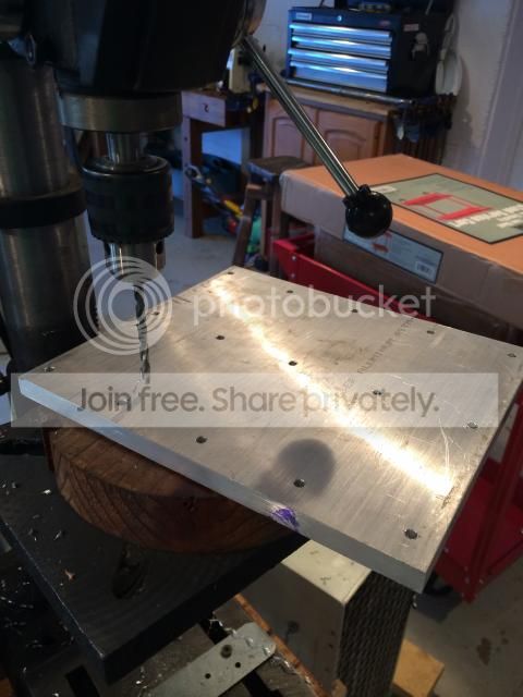

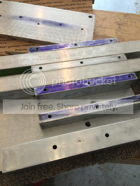

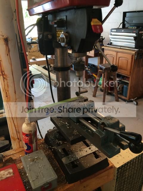

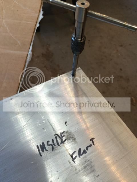

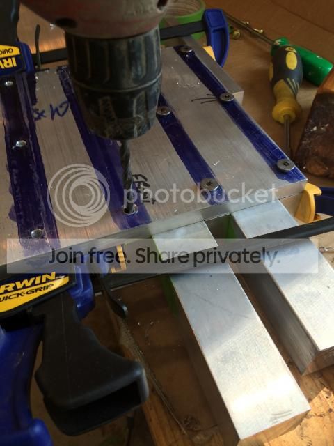

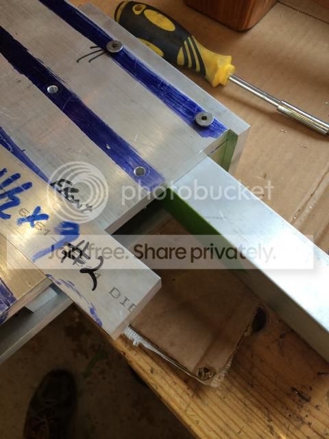

Drilling the initial holes for the left side. I essentially drilled all the holes using the tap sized drill bit. Then I used that side as a template to drill the first hole in the right side.
After I drilled one hole on the right side, I tapped it, bolted the two pieces together and then drilled another hole and repeat. Do this until you have 3 screws holding the two pieces together and then proceed with drilling the remaining holes and then tapping the remaining holes.

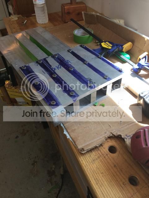

After the right side and left side are drilled and tapped, then begin to drill holes through the spacers.
I simply used a couple pieces of tape to provide adequate socket spacing around the tooling arms
I like this pic….$100 drill press, $200 drill press vise

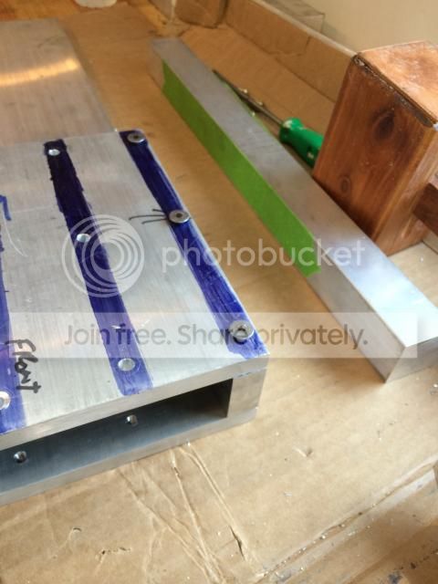

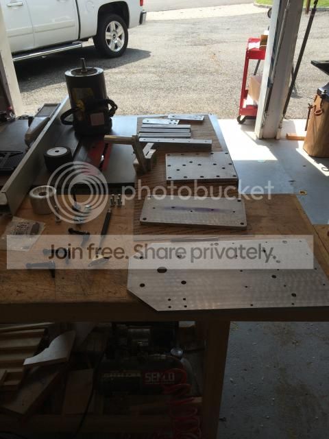

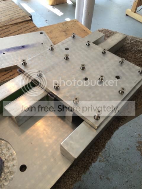

For the tracking arm support bars, these will ultimately end up on the left side of the main plate. In the picture they are straddling the main plate. This was an error on my part that I did not realize until ultimate assembly and you will see later how I simply moved everything to the left side of the plate.

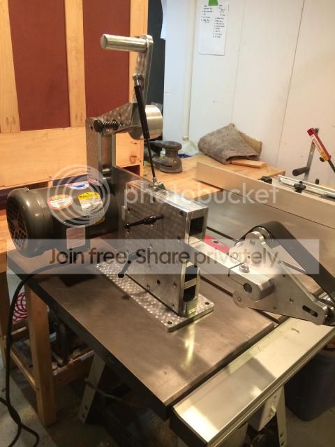

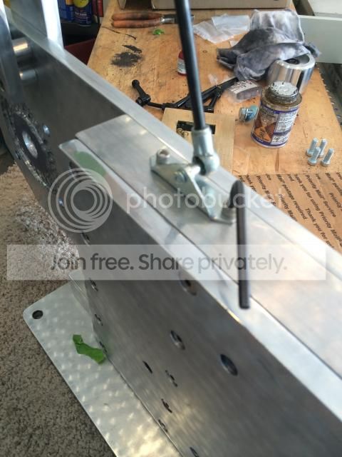

Time for final assembly. This is essentially all the pieces. Note the tracking arm is already assembled.

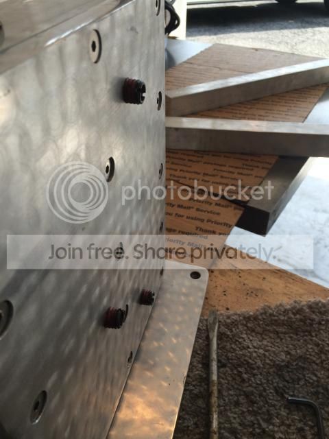

Putting .020 spacers to provide adequate side to side clearance for the tooling arms.

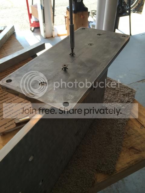

Attaching the two plates
Attaching the base

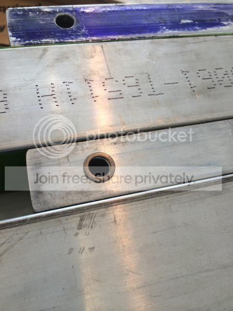

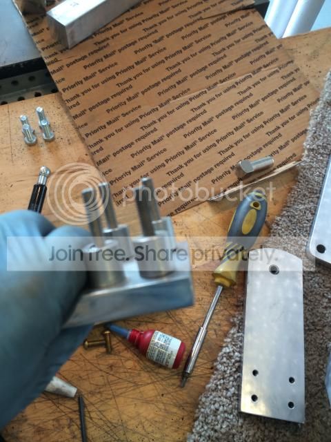

Spacers for the tracking support bars

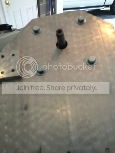

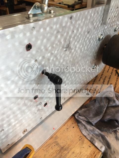

Threaded inserts for the locking handles

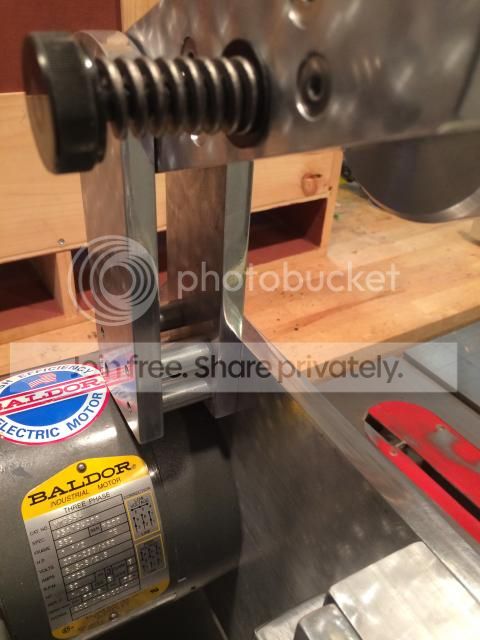

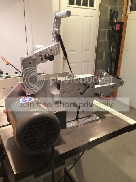

Motor mounted

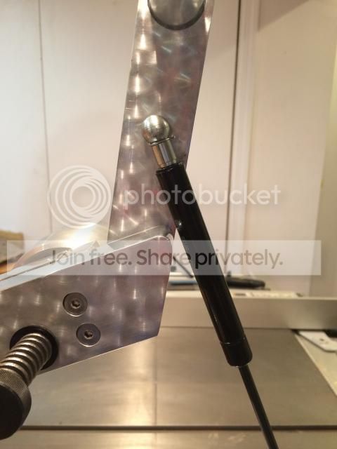

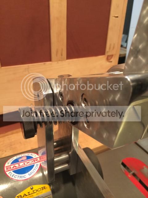

A die spring for the tracking knob to keep it from wondering…way too heavy duty but a 1.5” spring fits just right and provides some nice resistance

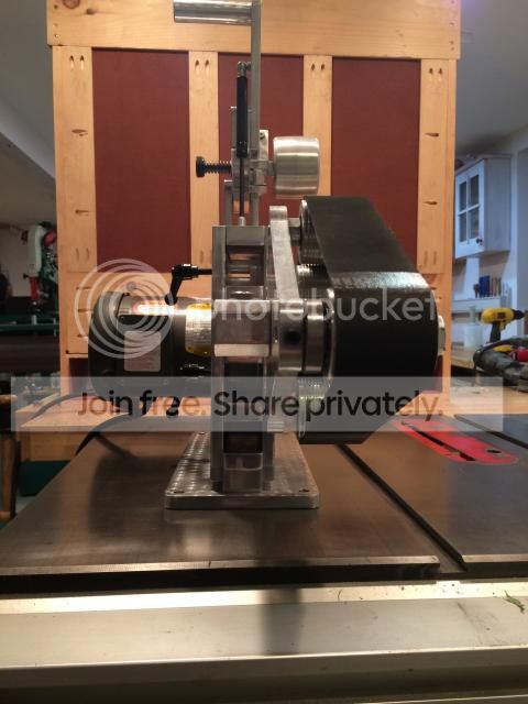

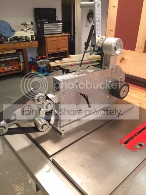

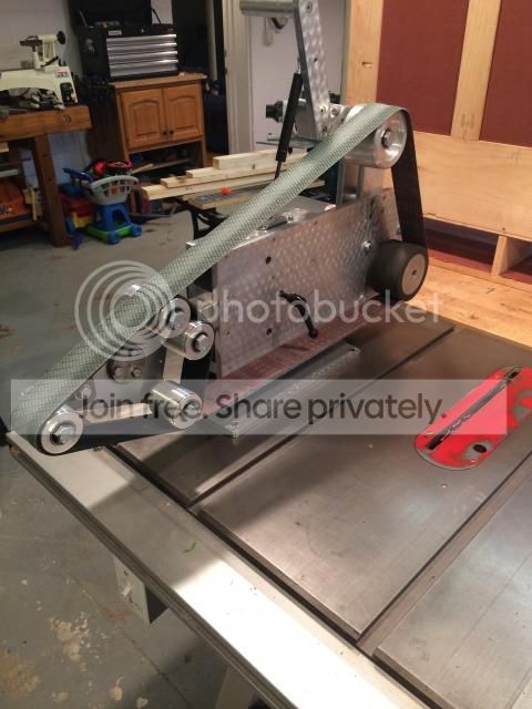

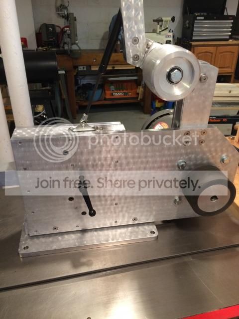

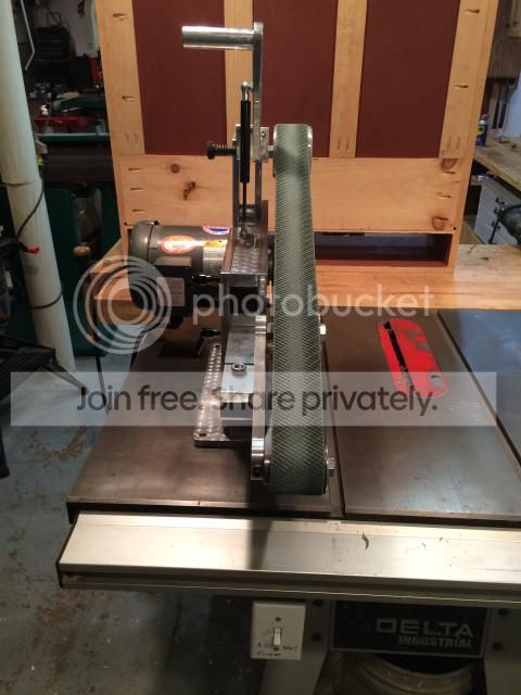

Final pics- shown with a rotary platen.

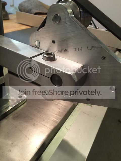

Tooling arms…can be bought for $80 or made for $15

That is some nice machine building work and it shows some serious planning. You should be proud. I bet you make nice knives too. You are not going to let your grinder get all dusty by using it are you? It's beautiful. Larry

How did you cut the inside slot on the end of your tooling arm? - Jigsaw & WD 40, cleaned up with sand paper and a small file.
