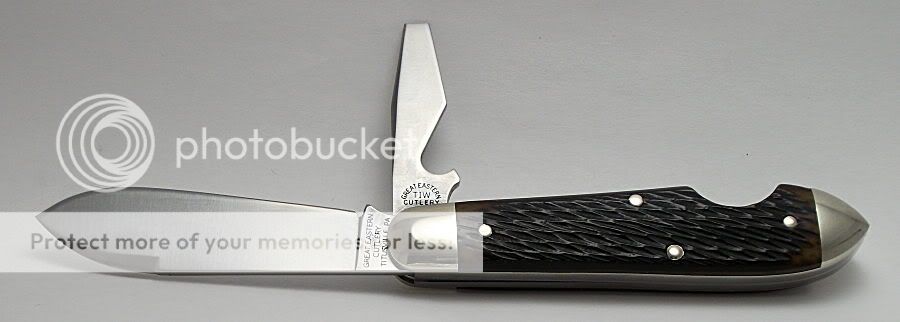

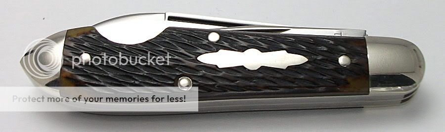

I always figured their were two types of lining up the blades on a slipjoint...the underblading method and then the flush with top of the spring method. I would have been disappointed if both blades didn't sit on the same level but it appears the underblading on this one is intentional and was visible in the prototype.
Yeah, I'd agree on that. My copy is slightly underbladed as well, but not objectionably to me. I did notice it looking it over but it was so slight I didn't even think to mention it.
I've seen some really bad examples in some other knives like the GEC 56 shown before, but slight underblading has never bothered me. Maybe in a custom, but not production. As long as it doesn't effect function, and honestly I doubt it does on even the pretty bad examples of the 56.

I don't think I've ever seen a GEC that is not underbladed. It seems to be par for the course with them--no idea why. Echoing a previous post of yours, do any of the smart minds in this forum know if there an advantage to making them that way?

On the topic of underblading, it is very difficult to get production knives consistently flush. A slight underblade is preferrable to the chance of overblading which looks bad, and feels sharp to the hand.
If you do a representative survey, you will find the vast majority of production knives slightly underbladed. I have a 4-blade Case Tested Cattle knife in my hand, and all four blades are slightly underbladed. I have also in front of me a Case XX USA 6232. The main blade is flush, and the pen is "under".

Interesting about the 'underblade' issue. I just pulled out a few Victorinox SAKs, which I regard as the most consistently well-made knives in the world, and found to my surprise that they are all underbladed to a slight degree. I can only conclude that there must be some advantage to this, maybe from a manufacturing perspective.
I hadn't thought of that, but you are correct...my alox SAK's and red handled vics all are underbladed.
The underblading isn't really an issue for me. The only reason I even brought it up was because I was trying to give a detailed description of my initial thoughts on the knife. It's something that only a knife nut would even notice anyway. Any of the things that I mentioned which could be construed as a negative are admittedly nitpicking and not a reflection of my overall satisfaction with the knife. The only exception to this is the cap lifter. I don't expect it to open every bottle on the first pry since it's so narrow, but it should at least be able to consistently hook a crimp in the first place. None of my other knives that have them are this hard to use.
I'm not weighing in heavily because I'll be the last one to receive my knife, but on the 2 points discussed here
a) Underblading is common and many makers do it by choice. It is quite common for old knives and many new manufacturers do it the same way to re-create the old. Doing it also gives some latitude because when you are putting out more than one knife a week (like custom makes), you can keep quite as tolerances, so underbidding is more forgiving. I don't believe it in anyways detracts from the craftsmanship of the knife. It is a customary feature of many knifes.

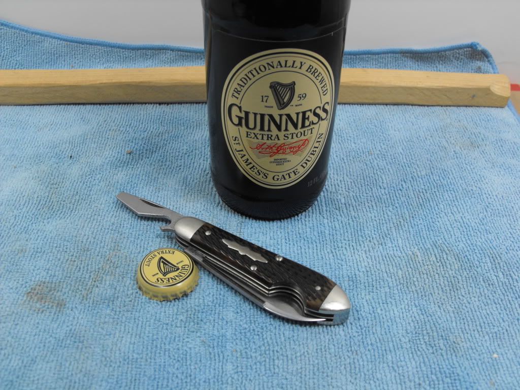

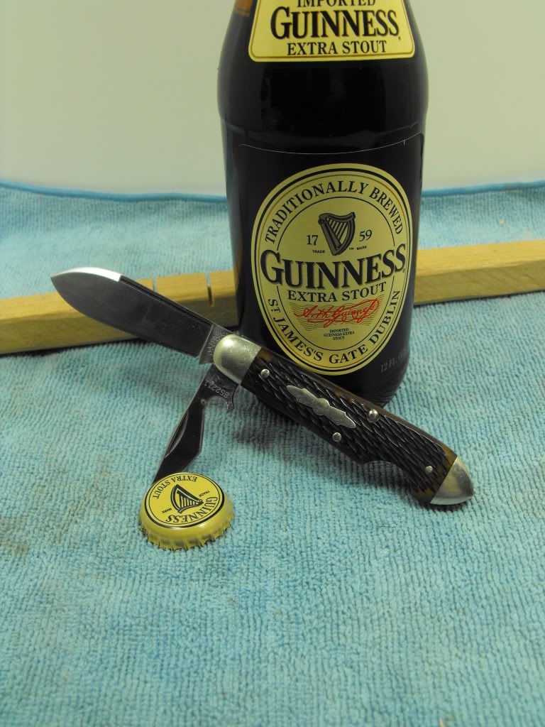

I admit my initial assessment was overly harsh. The secondary blade pull has eased up a little, but it still feels like the spring was matched to the length of main blade but used for the caplifter with half the leverage available. Yes, I call it a caplifter now, since I got out the die grinder and cut one in the screwdriver blade. I also admit that I did find a screw that it fit properly. I guess it is time for the cataract surgery. So here it is with the second bottle it opened (the first that it got on one try).
Stock and modified caplifters
That looks really good Jack! I might have to do just that...I'm getting a dremel kit so I'll give it a buzz just like that!
PS. would us modding the caplifter effect the warranty?
Nice work, Jack! Looks like it has more bite now.
