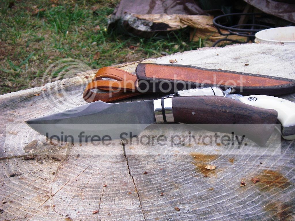

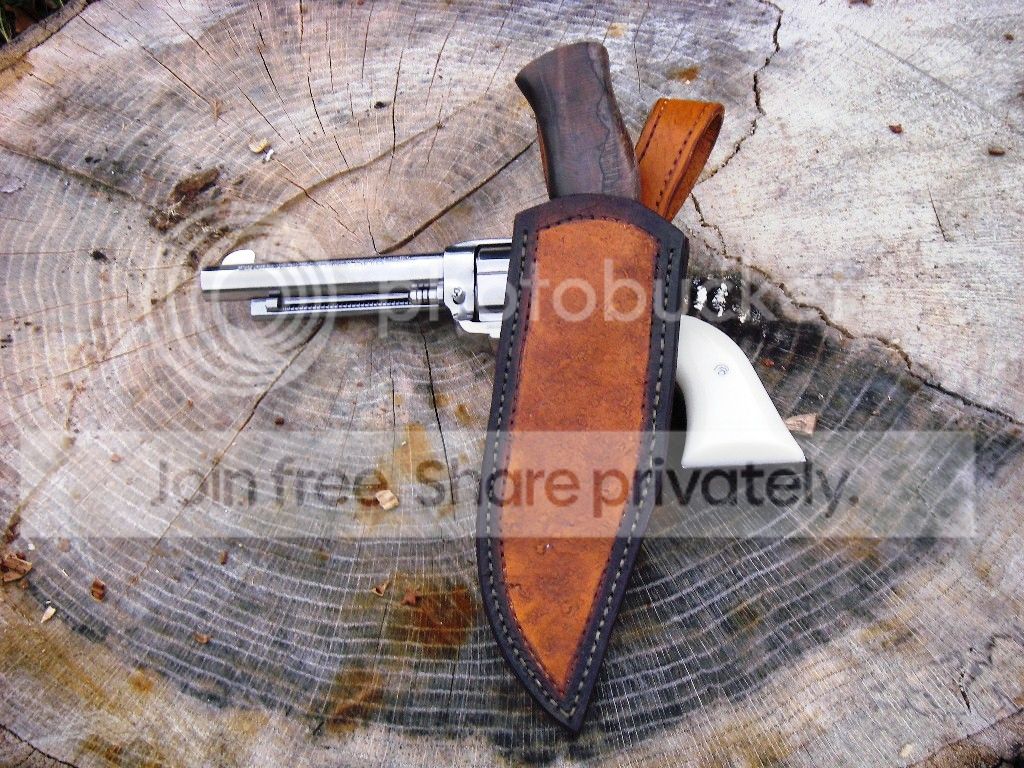

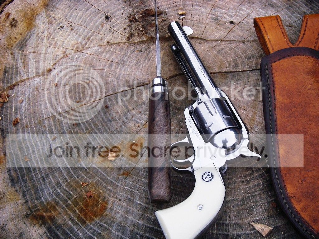

Here is my entry for the 2012 KITH. It's a good think I started early since i got the flu last week and was out of commission for 6 days. This small fighter is 3/16" 1084 from Aldo, 316 stainless "guard" with 1/8" black G10 spacer. OAL is 12" and the blade is 6 1/4" tip to guard; clip is not sharpened. Blade was clay coated, heated in a propane forge, quenched in canola oil, triple tempered and sand saned to 2000 grit before etching in ferric chloride. Handle is stabilized spalted sycamore from Mark at BurlSource. On to the pics:
Sheath is about as fancy as I can do. 8-9 oz leather dyed two-tone, with top secret texture (okay, okay, i did it with a brick)
Thanks for looking.
randy
Note: Stainless Ruger Vaquero is NOT part of the give-a-way and shown for context only.
