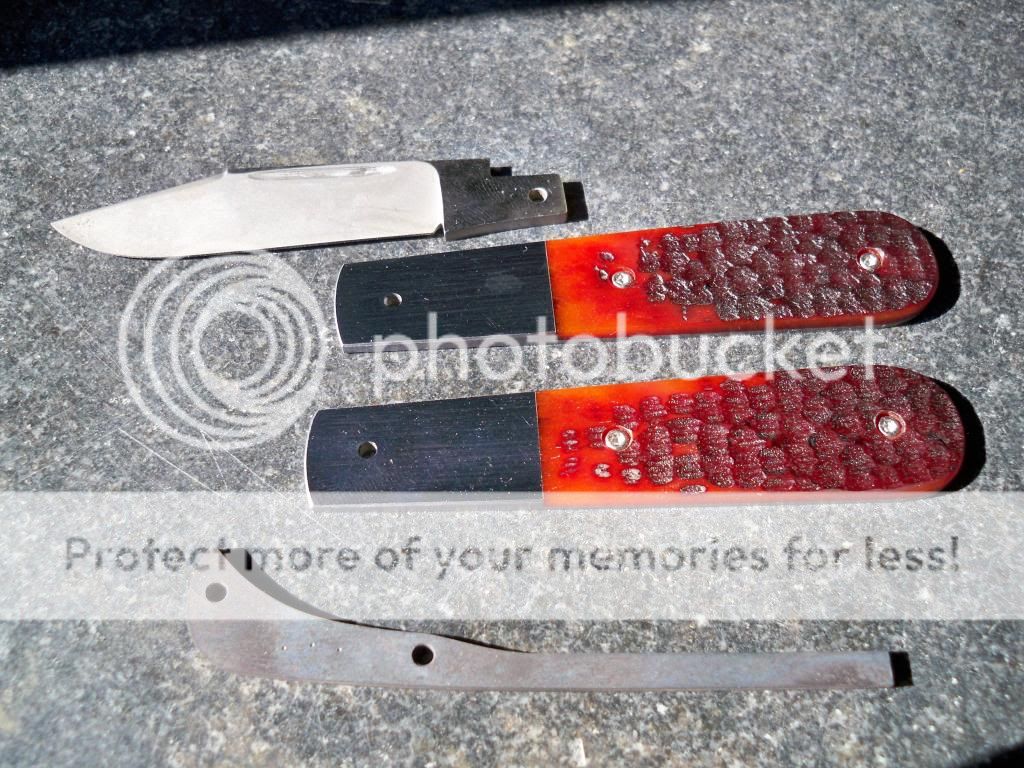

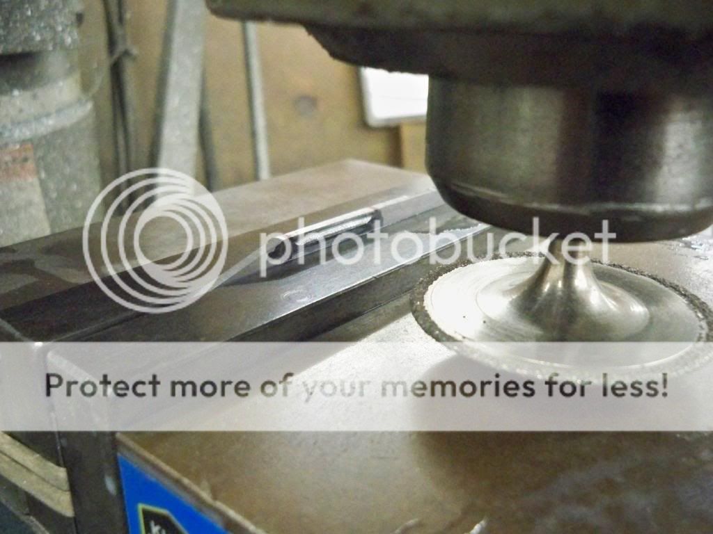

I got a little bit done this weekend, so just 2 pics for now.

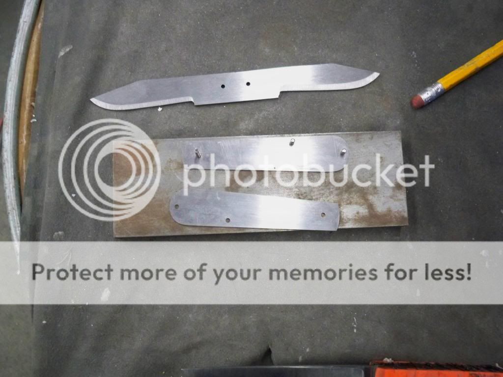

First pic, .040" 410SS liners profiled, drilled and reamed along with 2 profiled blade blanks and my fixture for setting the spring for flush.
I put a 45 degree bevel on the blades to give me a guide for where I want my plunges to start.
The second pic is of the nail nick and the diamond wheel I use for putting it in.
Next weekend I'll hopefully get the blades and spring ground and fit, and braze and shape the bolsters. I'll take more pictures then.

Looks good!

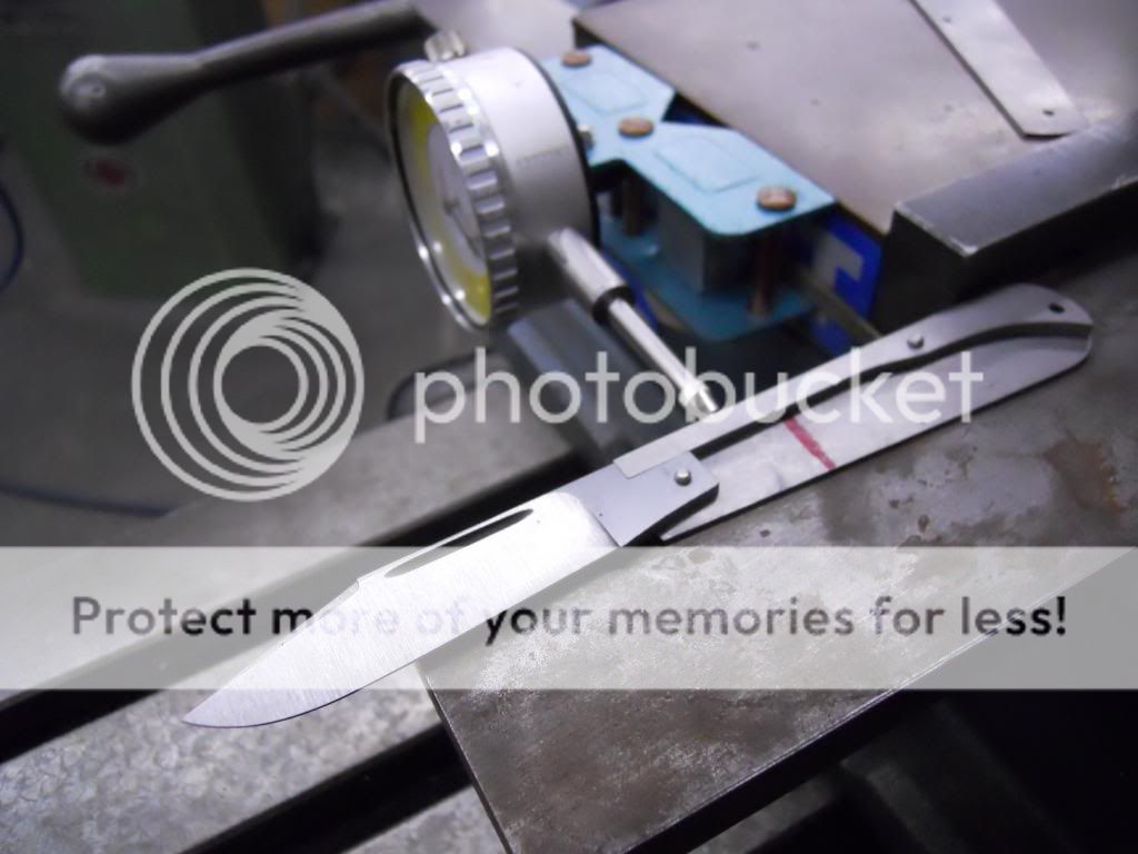

Ok, now it looks like a some progress has been made.

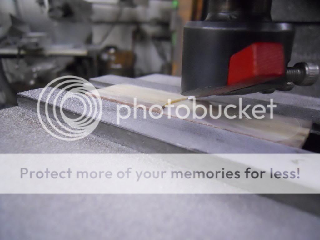

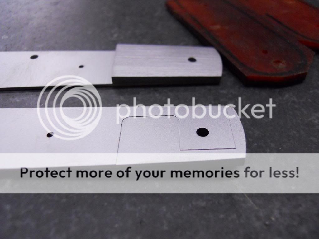

Got the bolsters and the bone cut down to size.
Got the blade and spring ground and fitted.
Bolsters brazed.
And finally mill relieved the liners and roughly shaped the bolsters with a 60 grit belt.

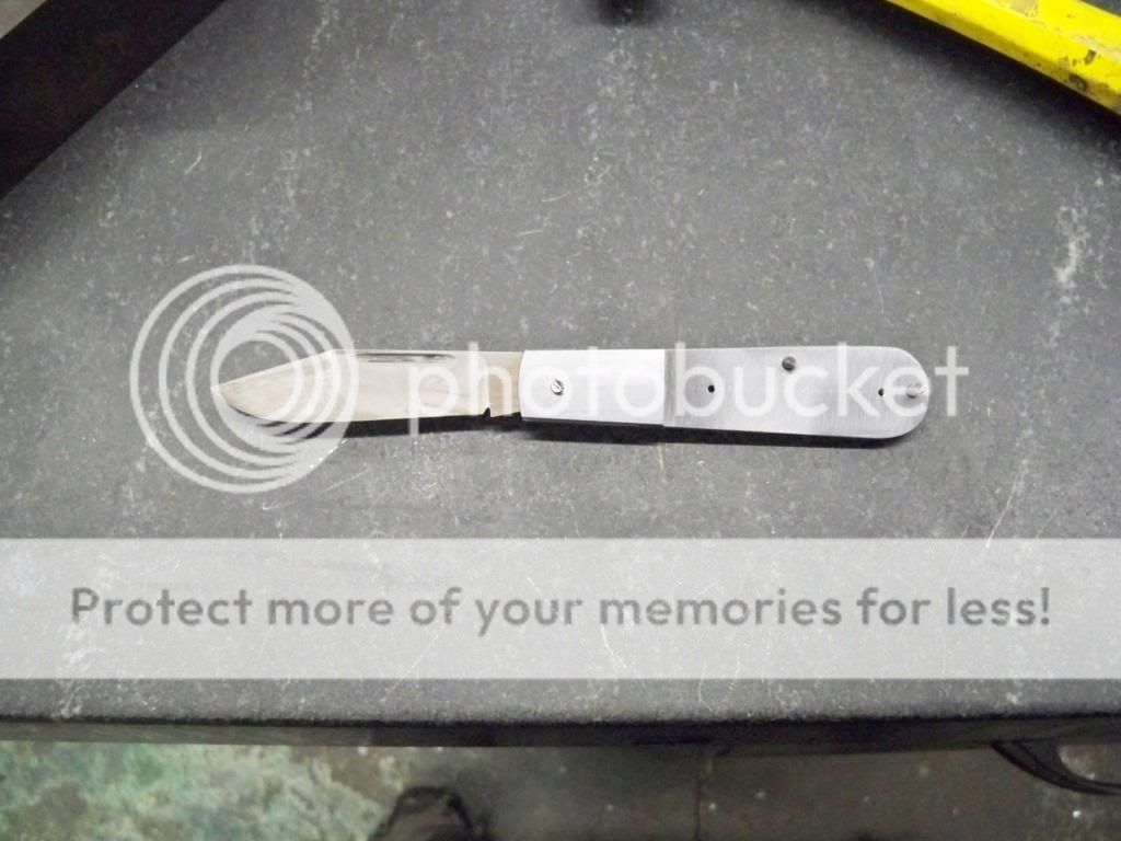

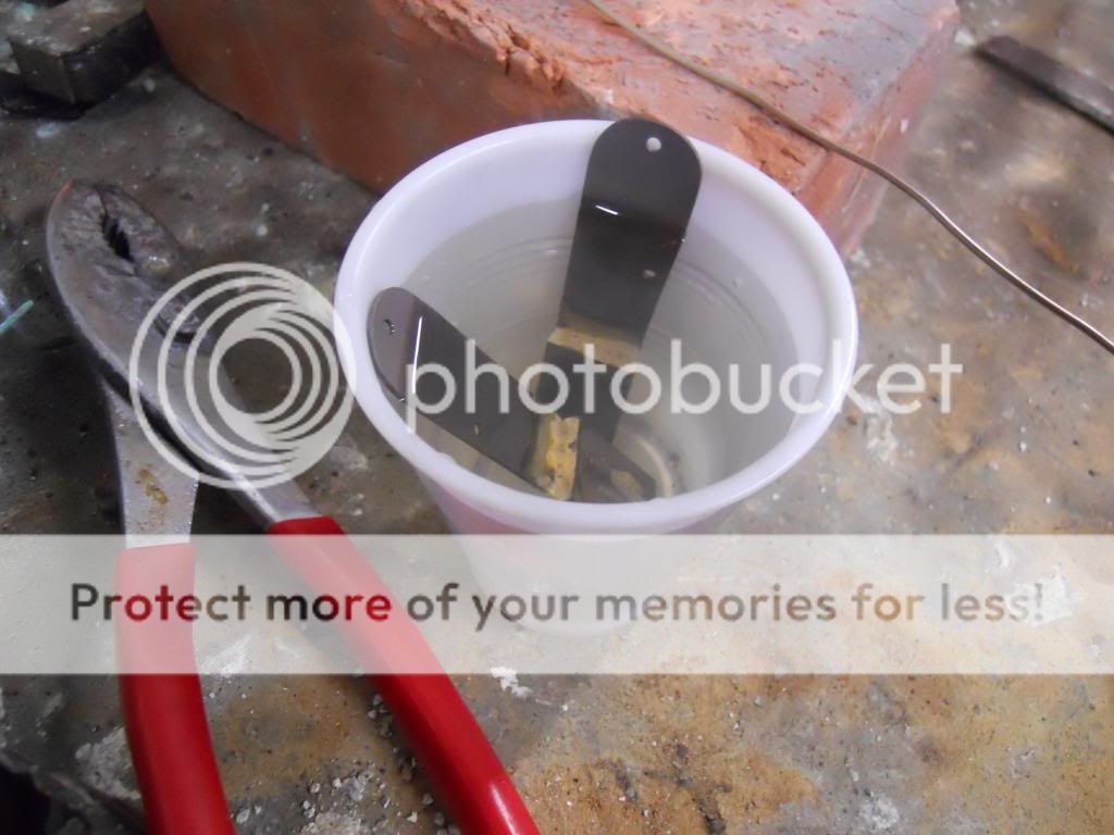

Today I got the scales pretty much finished and the blade and spring in the oven and tempered twice.
Gave it a trial run too. The blade warped about .005" to the side, I'll try and straighten tomorrow with another temper. Other than that she seems pretty good.

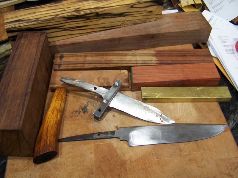

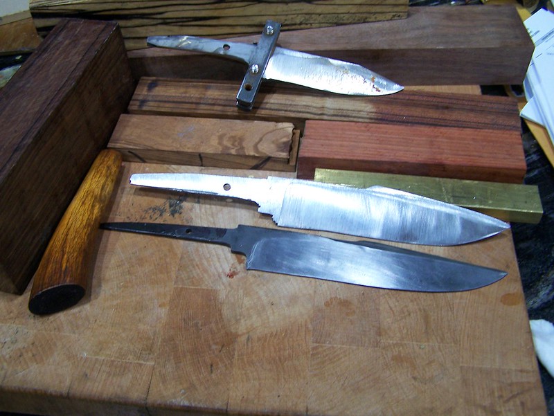

I didn't get back out to the shop last weekend, but I snapped a pic of the profiled blades I am working on. The larger knife isn't the kith knife, just a nearly identical knife I had at hand when I snapped the pic. The kith knife has a larger tang. This one is going to be a knife for a female co-worker and she wants a smaller handle on it. The larger knife is 1/8" 1095, and will be clay hardened. The smaller one is 3/32" 15n20. I was going to do a raised clip on this one as well, but I am leaning against it. I haven't decided on the wood for either one yet. I will choose between the cocobolo, ebony, paduak, zebrano (looks really good dyed amber- just finished a knife with amber zebrano) claro walnut, tigerwood, or possibly antler. I find I need the knife nearly finished in hand before the handle chooses itself for me. Usually one just jumps out.
Here is the actual KITH blade. my friend's blade is already hardened at Rc60, but is clay differentially heat treated. My wife put the KITH knife in the cutlery drawer :confused::):p I was worried a for a bit it went in the garbage by accident. I am leaning towards the paduak or the dyed zebrano for the small knife, and the cocobolo or the antler for the larger knife. Any thoughts? I think the Ebony is beautiful, but I think the large pattern needs a larger knife to be proportional. Once I see the hamon, I may change my mind.I am also thinking about using a different piece of zebrano, and running the grain vertically, rather than horizontally.

That black and white ebony is neat looking stuff. How is it to work with?
You need SHARP tools, and fresh abrasives. As with other ebonies, the grain is interlocked in places. Taking your time, and working with light pressure gets best results. The tigerwood is similar to work with. I really want to cut this piece and use it on a knife. If part of the grain flows with the knife, it may just be the handle for the kith. The Paduak looks so plain in a pic like this, but in hand it has a subtle chatoyance, and seems to come alive. Every knife I have made with paduak has been a hit with the owner. Its very dimensionally stable as well, much like a harder richer version of the Honduras Mahogany. I have some really nice Mahogany as well, but its a bit on the soft side unless its stabilized. I am so undecided with handles at this point!!!!

Pictures aren't on the memory card. I`ll have to check the internal camera memory. The large blade is Rc64 after the first temper (350f after quench) and the 15NJ20 is Rc62. I did two 15N20 blades, and three 1095 blades tonight. I am tempering the 15N20 a second time at 375f, If still above Rc61, I will try 400f. I will temper the 1095 blades tomorrow at 425, and adjust from there.
