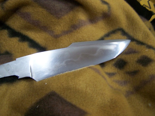

Good looking stuff all around guys. That second hamon should have some good activity from the looks of it. Really nice damascus zaph. I like the low layer stuff. I think sometimes though its alot easier to get a different look on the other side with the low layer stuff. Just the nature of the beast or something.
One side of the blade is kind of bland and empty. I'm really pleased with the other side. Hoping to get to the Leather Factory this weekend and pick up some ray skin. You can see some real weird hamon lines in the handle. I think it's from where the tongs gripped the blade when pulling out of the forge and quenching.
Second attempt at wrapping the Tsuka-Ito. I used a piece of rubberized liner material for the Same on this wrap, just to see how it will look. Trying to figure out how to finish it off without the Kashira and Fuchi. I think I can tuck the Same in and it will look OK without the Kashira, but the lack of Fuchi just makes one side of the blade side of the Tsuka-Ito look unfinished.
Wow, looks great! I love this style of wrapped handle. This is something I plan to learn in the future.
Interestingly, the second blade is 15N20 and there was no clay involved. Just a 1465 austentize and quench in fast oil. The top blade is 1095, and had clay. There is some great subtle activity in the 1095 blade that is washed out in the picture.

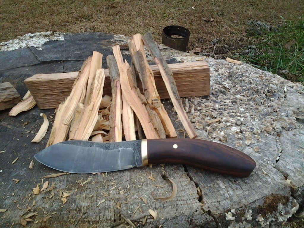

Got mine almost finished and did a quick fire prep to see how it did.
Still need to install the brass lanyard tube and finish sand the handle before making a sheath, but she is close.

Very nice. I like the brass. I use it on a lot of knives.
That's a good looking knife Randy.

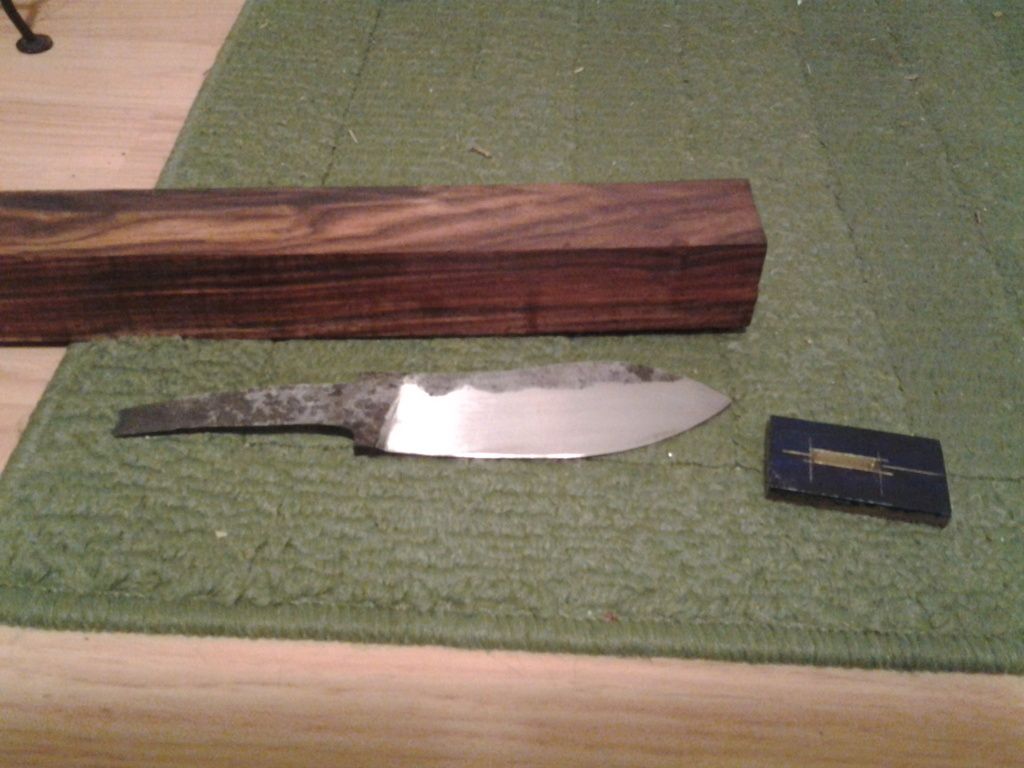

I just need to hand sand the bevel and clean up the file work a bit and it will be ready to put the handle on. I plan to use a walnut/cherry combination with black paper mycarta liner/spacer.
Chris
Thanks, guys. Willie71, I figured a wood/brass combo on a Nessmuk was the only way to go. Plus, fitting a brass guard to my irregular forging was easier than stainless, lol.
randy
