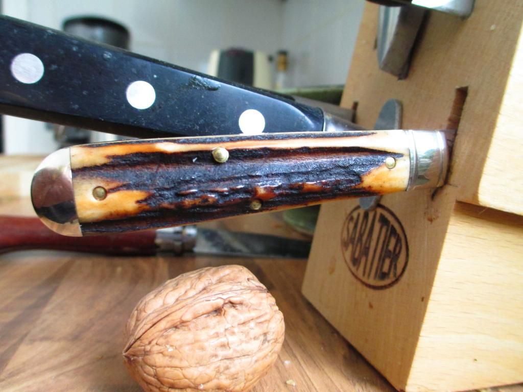

Can't seem to find any potash here so I made do with tea-dye. Works well I feel but it has dangers, you have to nerve yourself to immerse it in very hot water and stag can swell up (for a while) or possibly react badly to it:eek: You get a nice dark patina effect on the steel too.
Thanks, Will
Thanks Jack! A few drinks helped mind:D:D However, if the water is not boiling but very hot you should...be OK, a lot depends on the pores in the stag I suspect.
what about a longer soak in colder tea?
Unfortunately the tea stain doesn't seem to work as well when it's cold.
