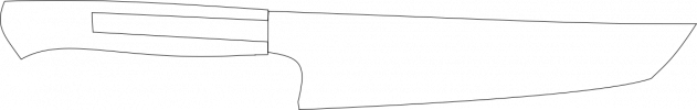

Here's what I'm thinking of making, a hybrid nakiri? I've seen some of these around always thought they were slick so I drew one up.
I'm not positive whether I'll go western or wa style on the handle, or even that western handle. I have another western variant handle I may use.
That looks cool. How to you plan to grind the tip?
It looks cool, but I would reconsider that tip, it looks like a good part of the tip wouldn't cut on the push cuts and would wedge/split the food. It looks more like a tanto with a widened heel then a nakiri.
