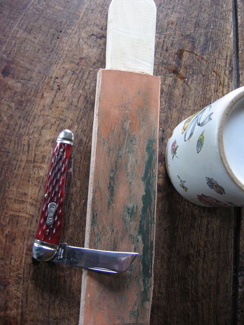

When I placed the order for the Farmer's Jacks, it struck me that I didn't really know how to sharpen one!!
The ceramic-coated rod from Spyderco was a gift from that company to all the tableholders at Oregon, a couple of years back.
It has two rounded edges. (see the tracing of the end!)
[snip]

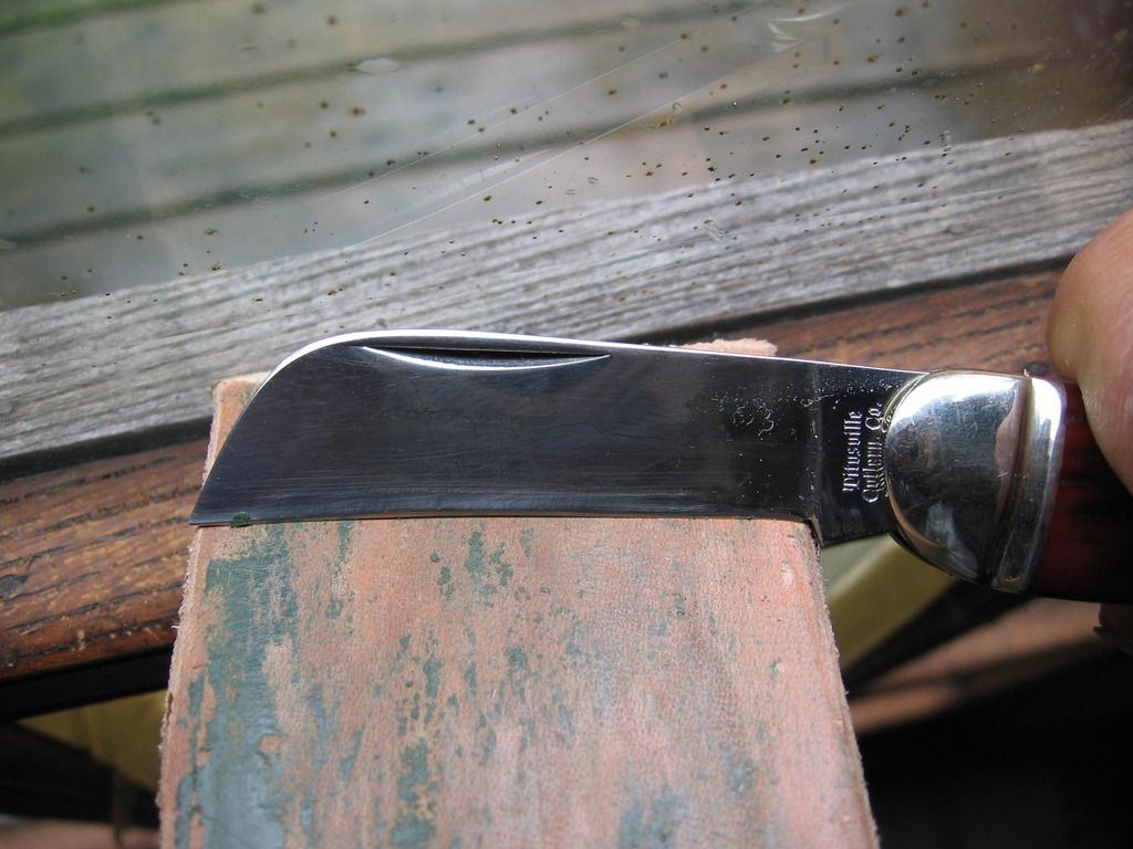

I have been using this knife around the garden, and it needed a honing, and this rod did the job nicely!!
I held the rod near the end, pointing up at an angle away from me, and drew the blade down it, toward me, stopping well away from my thumb. For the other side, I sharpened away from me, just like peeling a twig!
I am astounded it is so easy!!
:thumbup:
Charlie, I thought that was exactly what I was looking for. I was looking at the triangle-shaped ones but didn't see this. No wonder - it's discontinued.
Spyderco catalog: https://www.spyderco.com/catalog/list.php?category=7
I actually used the edge of a Spyderco 3x8 ultrafine ceramic stone to touch up the hawkbill blades and it worked quite well. But I was looking for one with a rounder edge like yours.
