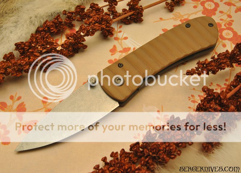

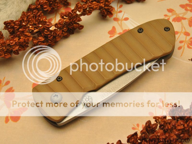

No.299
Steel: 1080, Texture Etched and Tumbled
Handle: Tan G-10
Overall Length: 7 3/8"
Blade Length: 3"
Closed Length: 4 3/8"

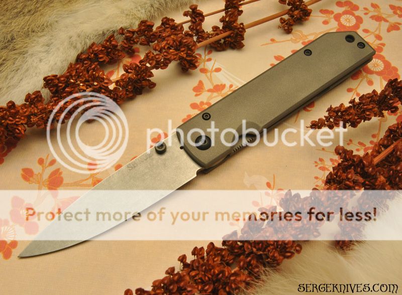

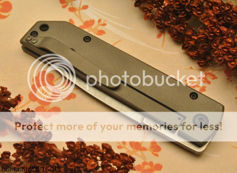

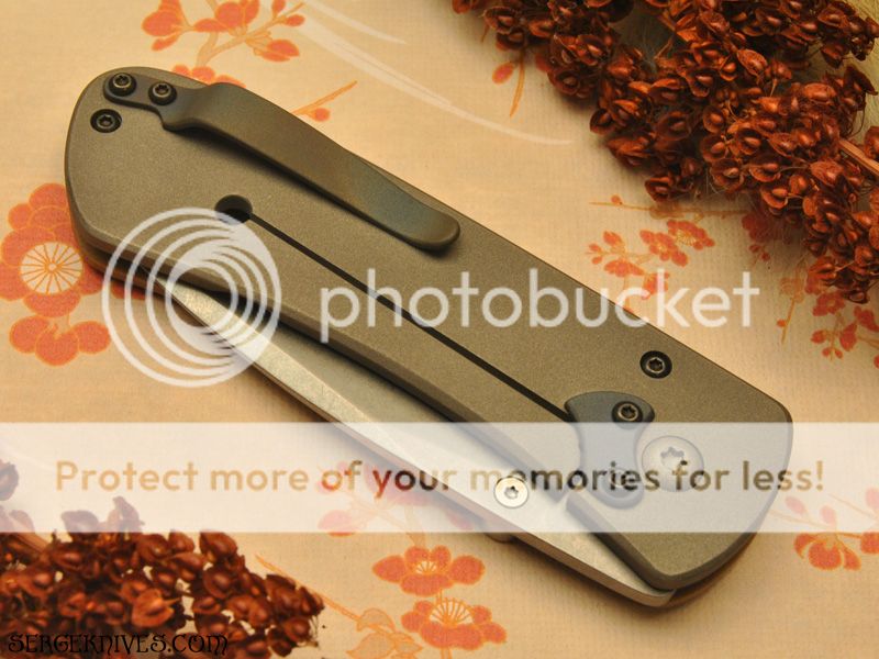

No.299
Steel: 1080, Tumbled
Handle: All Ti
Overall Length: 8 1/8"
Blade Length: 3 1/2"
Closed Length: 4 1/2"

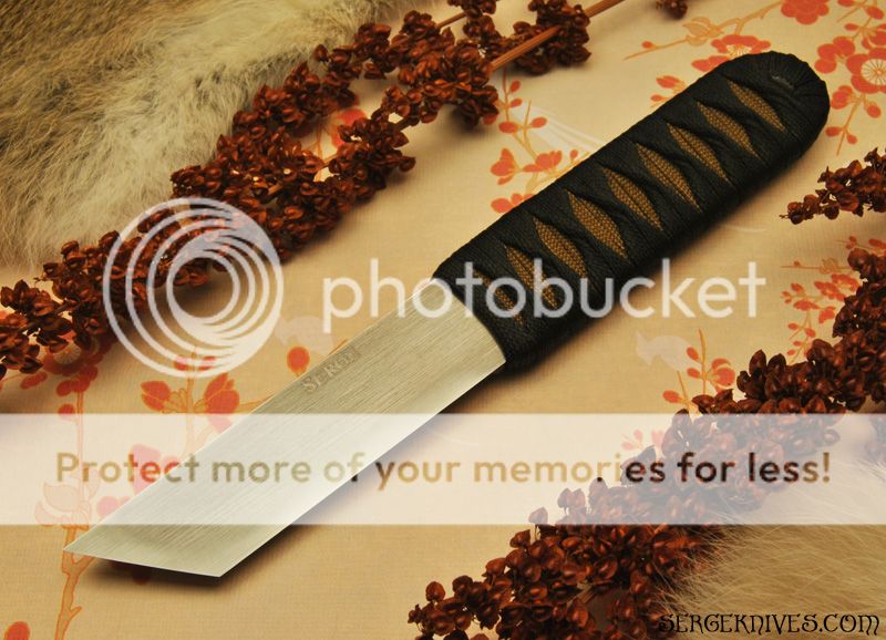

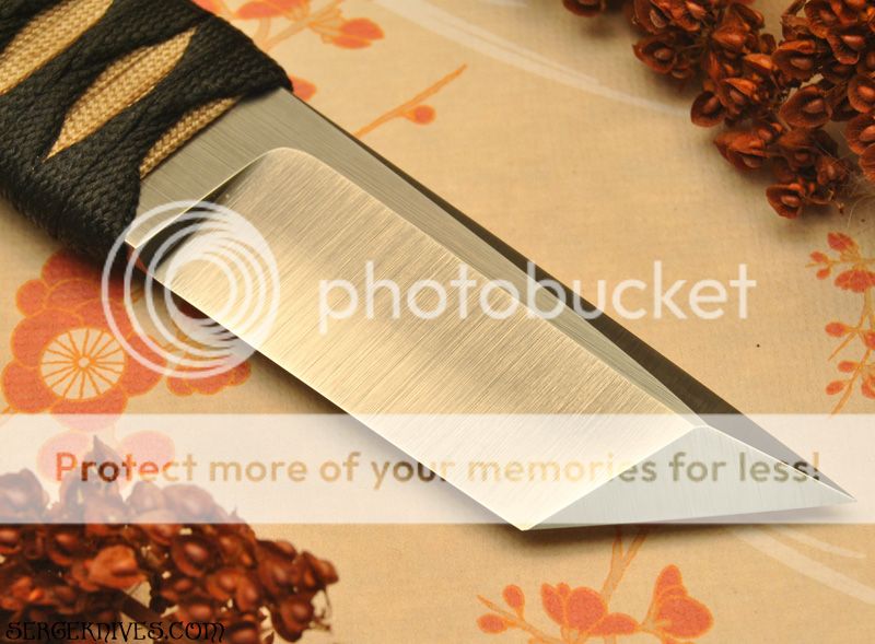

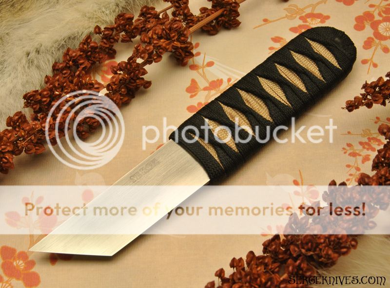

No.296
Steel:1095
Handle: Nylon w/Tan Paracord Underlay
Overall Length: 6 3/4"
Blade Length: 3"

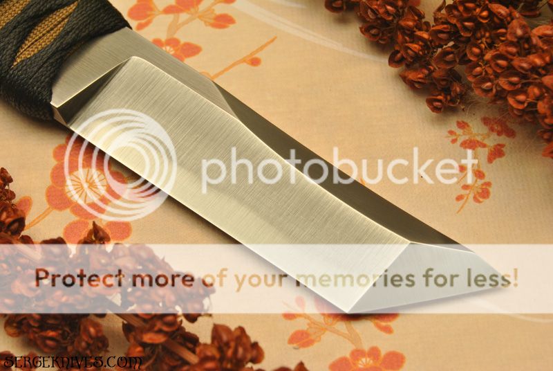

No.297
Steel: 1095
Handle: Nylon w/Brown Paracord Underlay
Overall Length: 8"
Blade Length: 3 7/8"

what did you use for the finish on the Ti?
Way to go Serge, you can even make tactical look quite "Serge-ish", which is a very very good thing. That big folder is my favorite of the bunch.
I'm not much into tactical folders, but do I ever love those two Japanese-type pieces - sweet!

Derrick, what exactly is Serge killing? Is he killing the 1/2 of a blade ground on the second knife with the ALLEN BOLT HEAD FOR A THUMBSTUD?
Is he killing the neo-tanto grinds with stubby points on the tantos?

The grinds on the Japanese-inspired pieces look good to me, as does the contrasting vertical / horizontal satin finish. The points don't look stubby to me. They look quite pointy. Like if I tapped them with my finger, I'd bleed.

Although I like a more 'finished' looking finish, I'd have to agree with Rog on this one. It appears as though Serge has perfectly crisp grind lines, they appear to start and stop exactly where he wants them to, and the abrasive marks are all entirely uniform. I'll go out on a limb and guess that if he had opted to put a 2000 grit finish on this, it would have been done with exactly the same level of aptitude as displayed here, which is to say - exactly!
Nice work, Serge - I'd say you're killin' em, too!

You are starting from the assumption that these knives should conform to some specific ideal. I don't know that that is a remotely valid assumption. Serge didn't make any claim about these knives being a precise historical replica of any specific blade or style. I expect they look exactly as Serge intended them to. If they don't conform to your or someone else's concept of "the ideal", that's hardly a flaw. Again - accepting that we are both limited to observing a photograph of a knife, not the knife itself - the grinds look clean, the finish looks very even. An even finish to me is more important than a fine grit finish. If you don't get it even and clean, there's no point going through to a very fine grit. I didn't claim the finish was "worthy of accolades". I said it looks good. And in the photos, it does.
Bottom line: I don't think that every knife that draws any degree of inspiration from Japanese style knives must necessarily conform to some specific traditional ideal.

Thanks guys. Steven, these are all meant for everyday use where you dont have to worry about scuffing the blade etc, simple tools. Regarding the steeper than normal angles on the tanto kissakis, the're meant to strengthen the front of the blade for heavier cutting tasks if need be. Regarding the blades being chisel ground, theres alot of controversy there. A big part of the tactical crowd- LE, military etc. prefer their self defense blades to be ground so because a chisel ground blade leaves an irregular cut, but like I said some people like them some dont. The above knives are meant to be basic cutting tools, nothing more.

...and I don't necessarily see anything wrong with what you are saying, or intending, but I also don't see it being worth accolades of greatness...though others may be completely ignorant to the reasons why.....Japanese style blades had tip geometry for specific reasons....your reason is a valid reason to you, but it doesn't work for me. If you are making simple tools, simple congrats or simple admiration would be in order, but for some reason, my fellow Forumites seem to find necessity in granting superlatives, which I find over the top, and extremely excessive, ire drawing in it's form.
There are makers in the past who have made very simple knives deserving of and setting the bar for this level of praise, Kit Carson, Tom Mayo, Robert Terzuola to name a few.....this product is not at that level.
