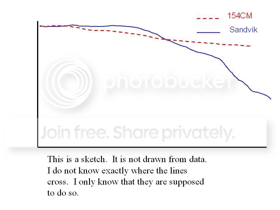

According to Sandvik, coarse carbide steels like 440C have little to recommend them over other stainless steels due to comparatively poor sharpness, edge stability, and toughness. Powder steels may be more expensive, but do not have poor performance in any relevant factors, along with excellent wear resistance.
That depends on your paradigm. Some folks like an absolute razor edge and for that Sandvik's alloys are superb. The lack of carbides gives allows them to take an hold a razor edge exceedingly well.
Some others prefer longer edge retention and are willing to give a little in absolute sharpness to get it. For that 440C and PM steels excel far beyond what most of Sandvik's alloys will do. The carbides in 440C and PM steels give superior edge retention, though they do not hold an absolute razor edge as long.
Here is an illustration of my point. Hand drawn, not from specific data, but rather as an illustration my experiences with the various alloys:
Personally, because of the experiences I have had cutting various substrates with various alloys over a number of years, I prefer alloys with carbides. I find I don't need the razor edge as much as I need a blade that keeps on cutting. But that is my way of doing things. Others have other ways, which is to say, YMMV.
