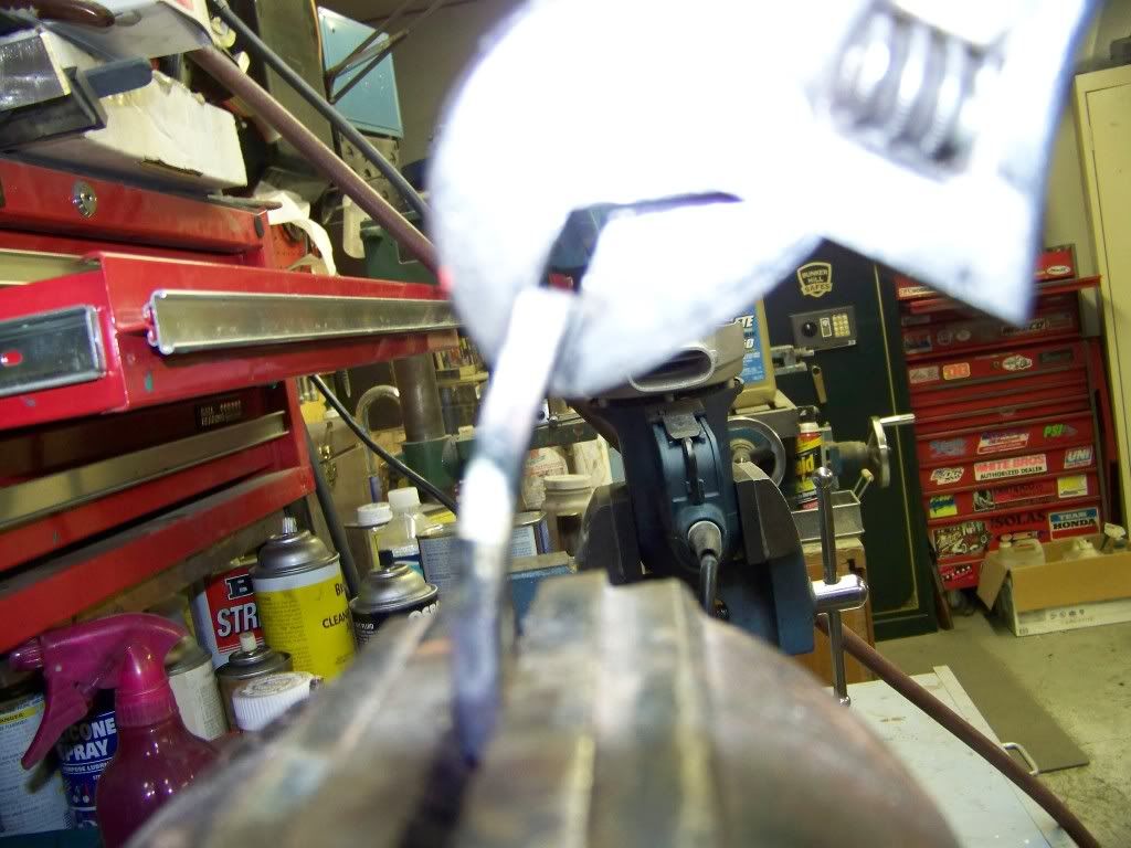

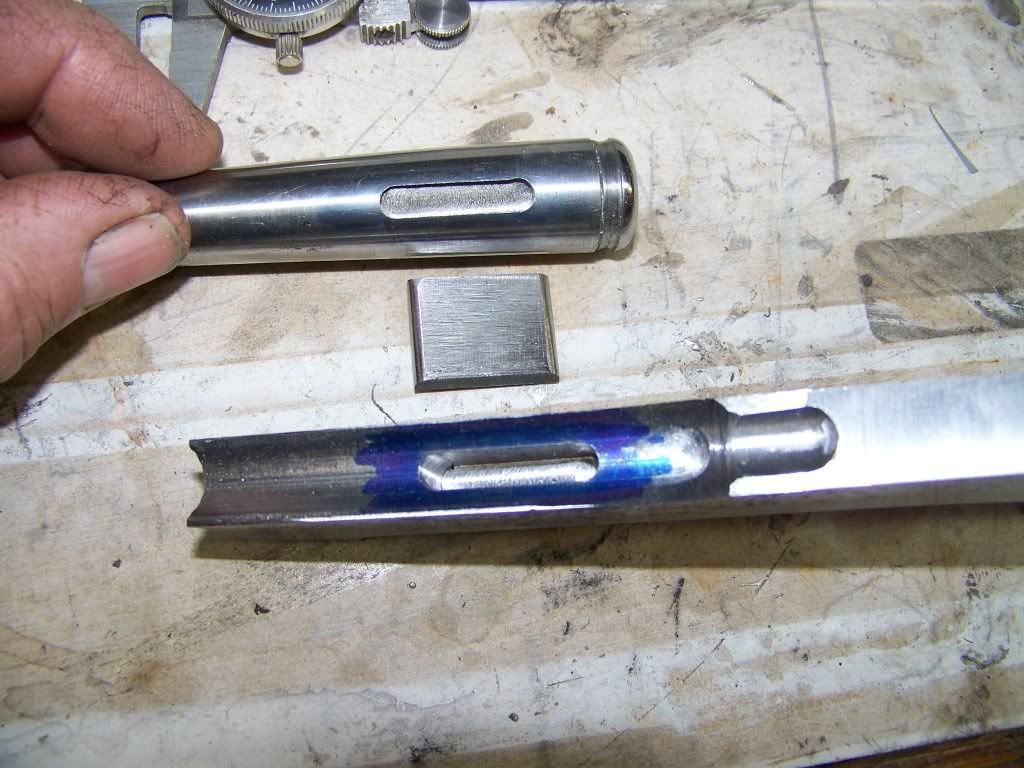

I milled a slot on the underside of the barrel and a matching slot in the frame and used hi-temp silver solder to attach the tab into the barrel. I thought the same thing so I tested my tecnique with butt jointing two pieces of mild steel and bending them in the vice with a wrench. Both pieces bent amazing far before the joint broke. The tab and slots will take the recoil in this case and the solder is basically just to hold things together.

If you buy one with intent to fire projectiles I would be cautious about the barrel proof marks. Lots wore made just for wall hangers.
