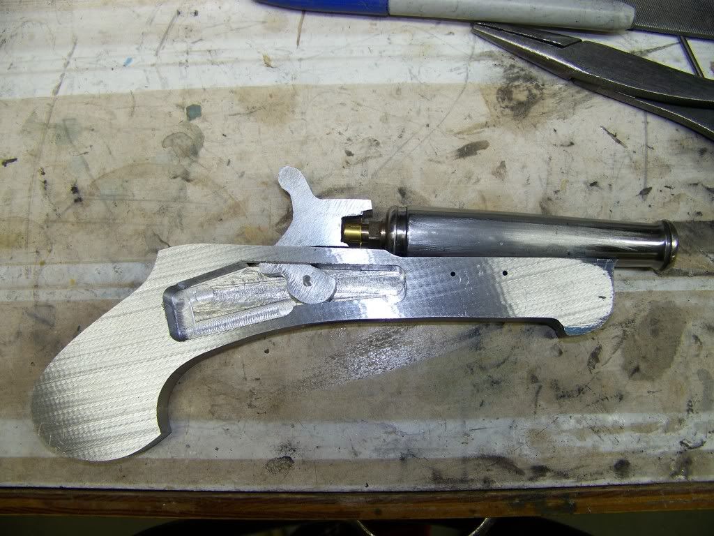

.45 cal pirate pistol/folder

I have plans to have the entire gun engraved.

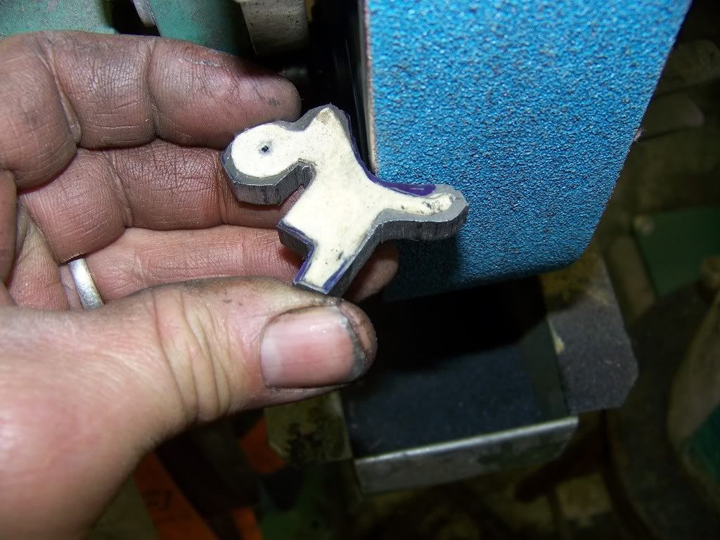

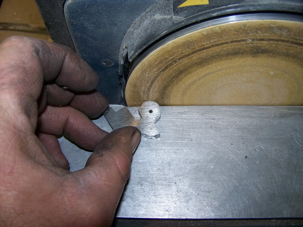

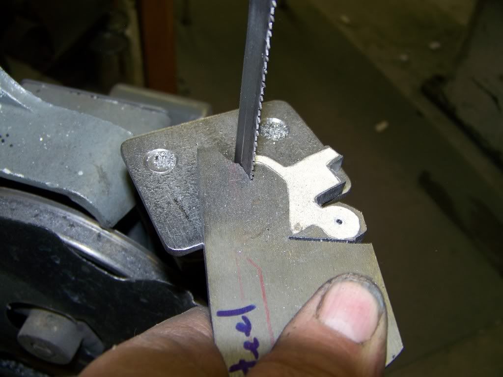

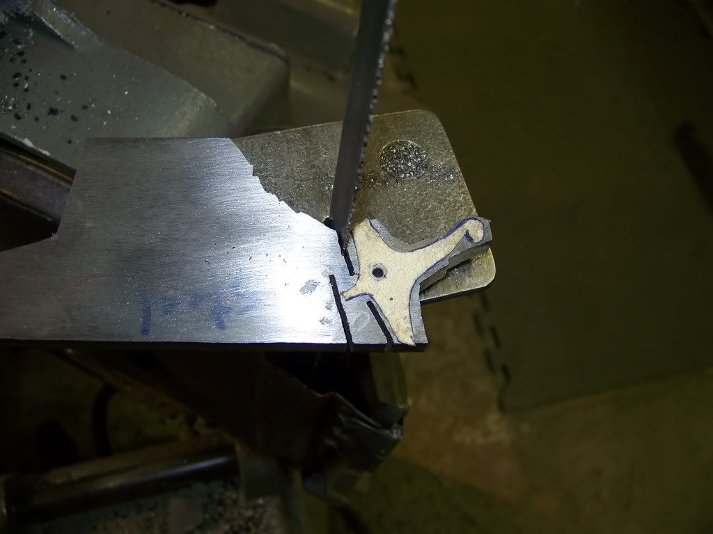

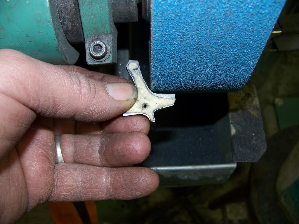

Here is the hammer made from .250" precision ground 01 steel. I drew it on manilla folder paper and glued it on the steel. Roughed it out on the band saw and ground it to approx size. There is some filing to do where electric tools cant reach. Its good enough for now. Tomorrow the trigger.

Thanks Keith. It needs to lose some weight by trimming and shaping. The trigger should match it. I want to have them engraved before heat treating them. I've never done that on others.

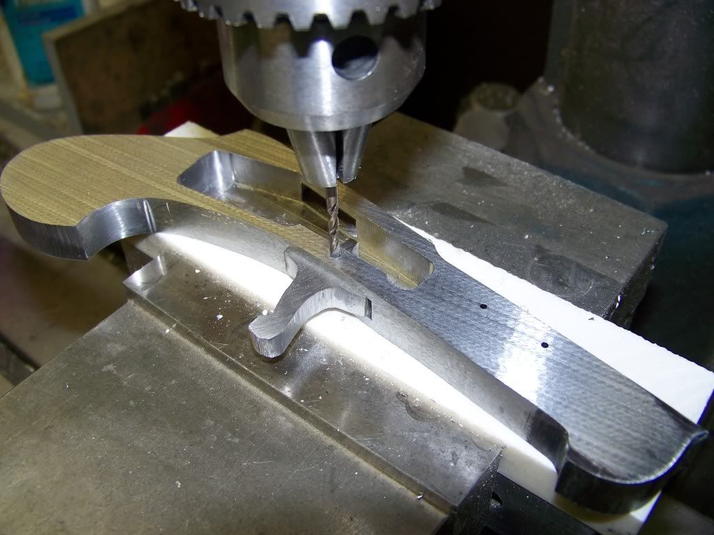

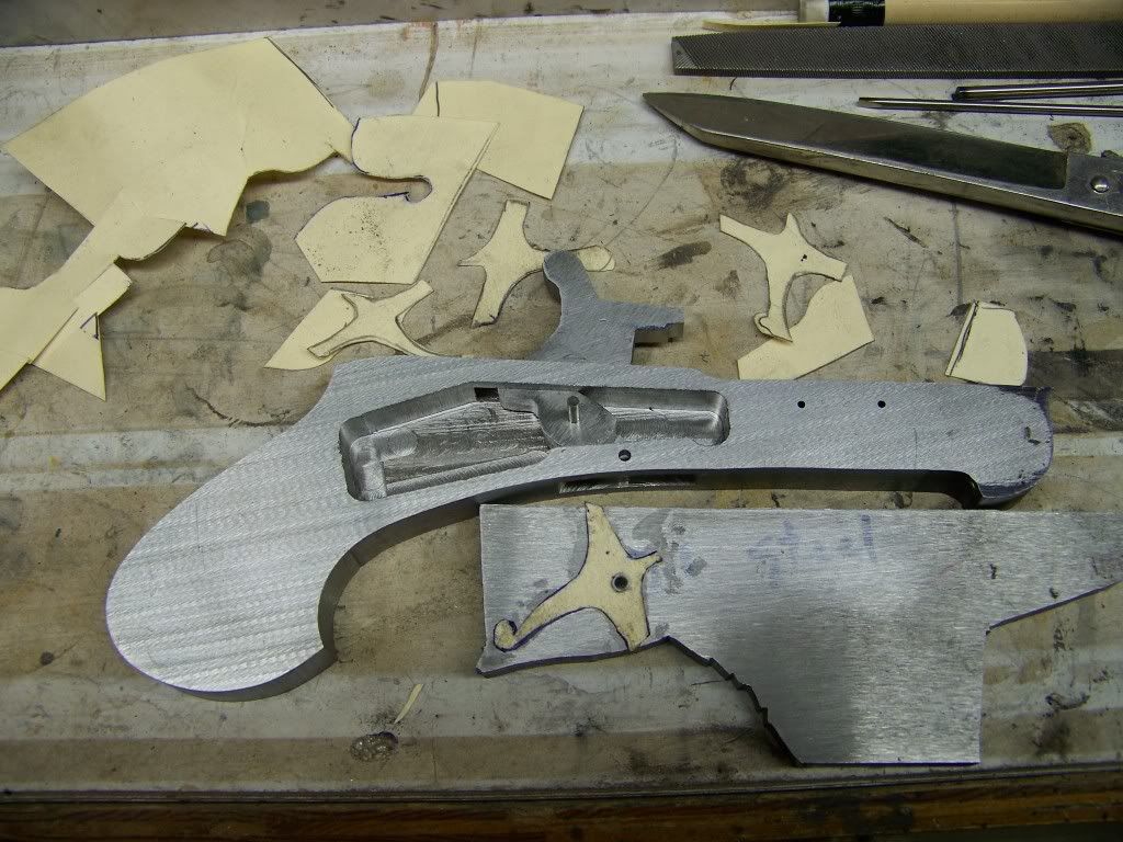

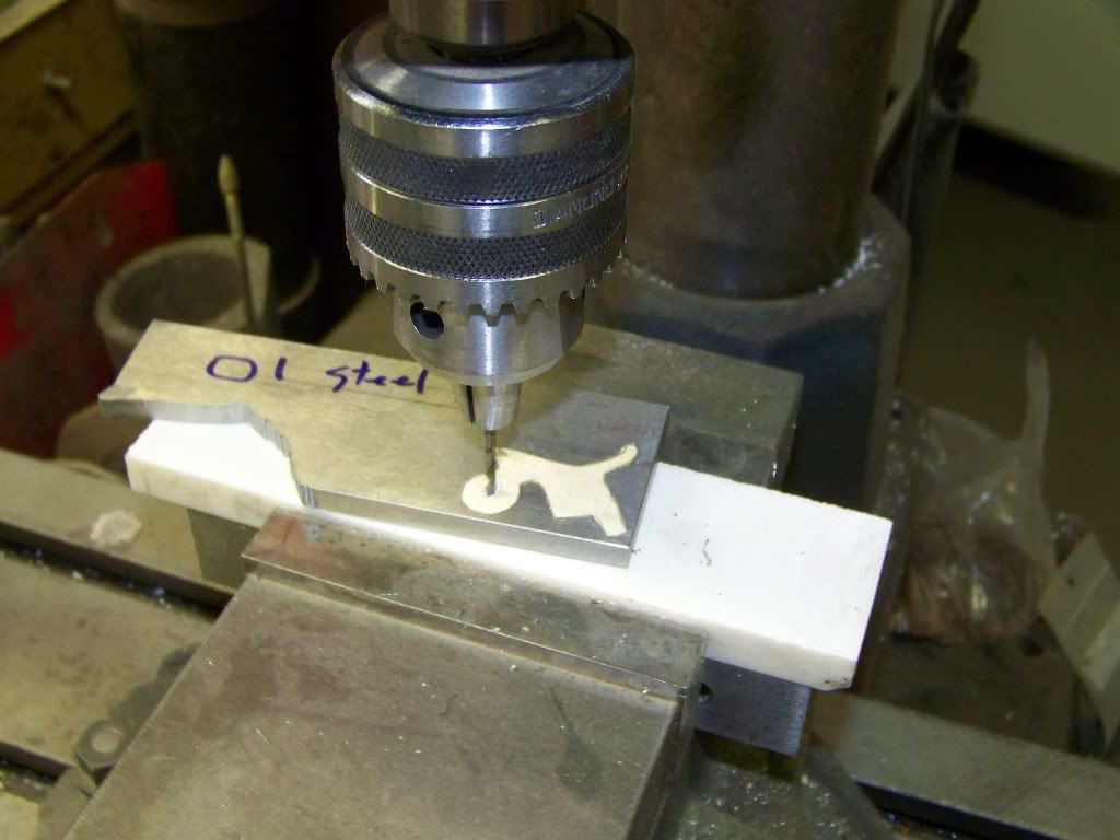

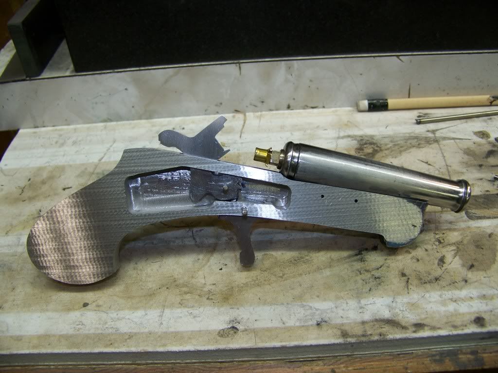

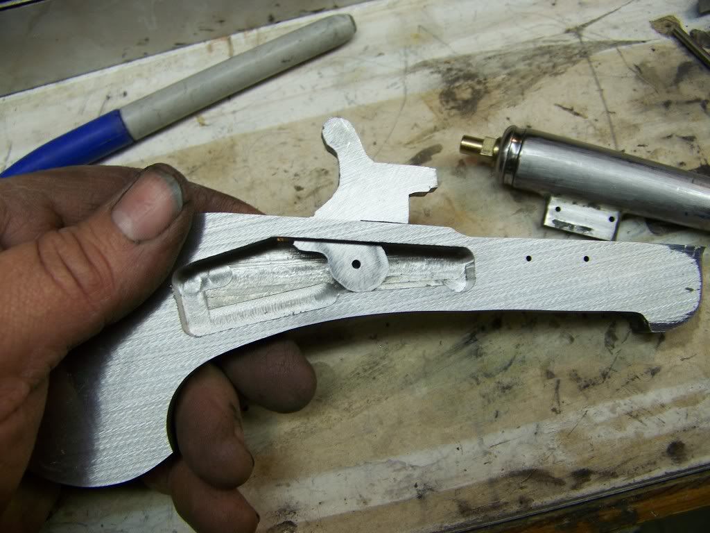

I had time today to rough out the trigger.
I drew it on manilla folder paper and nailed it on the 4th try. I ran out of time tonight and didnt get it hand filed so it operates fully but it is in the "cocked" position. I hope the image shows the safety catch "half cock" on the hammer. It is a challenge to get these parts right, hopefully the work together and I wont have to make another hammer or trigger. Springs are next.

Sorry if I missed it Bruce, but what did you mill the frame from?
