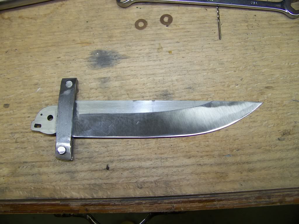

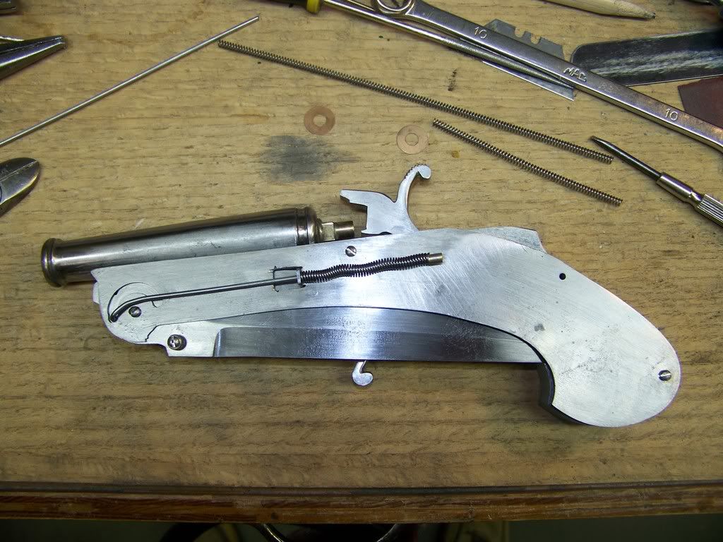

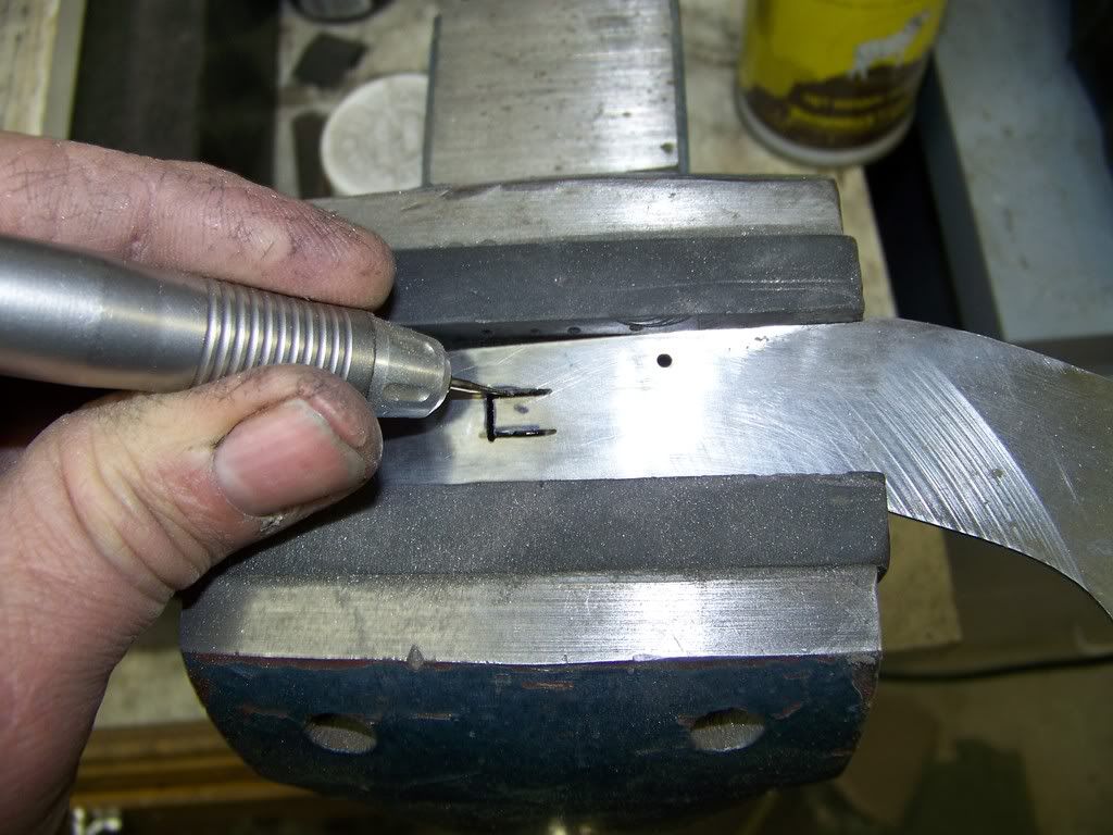

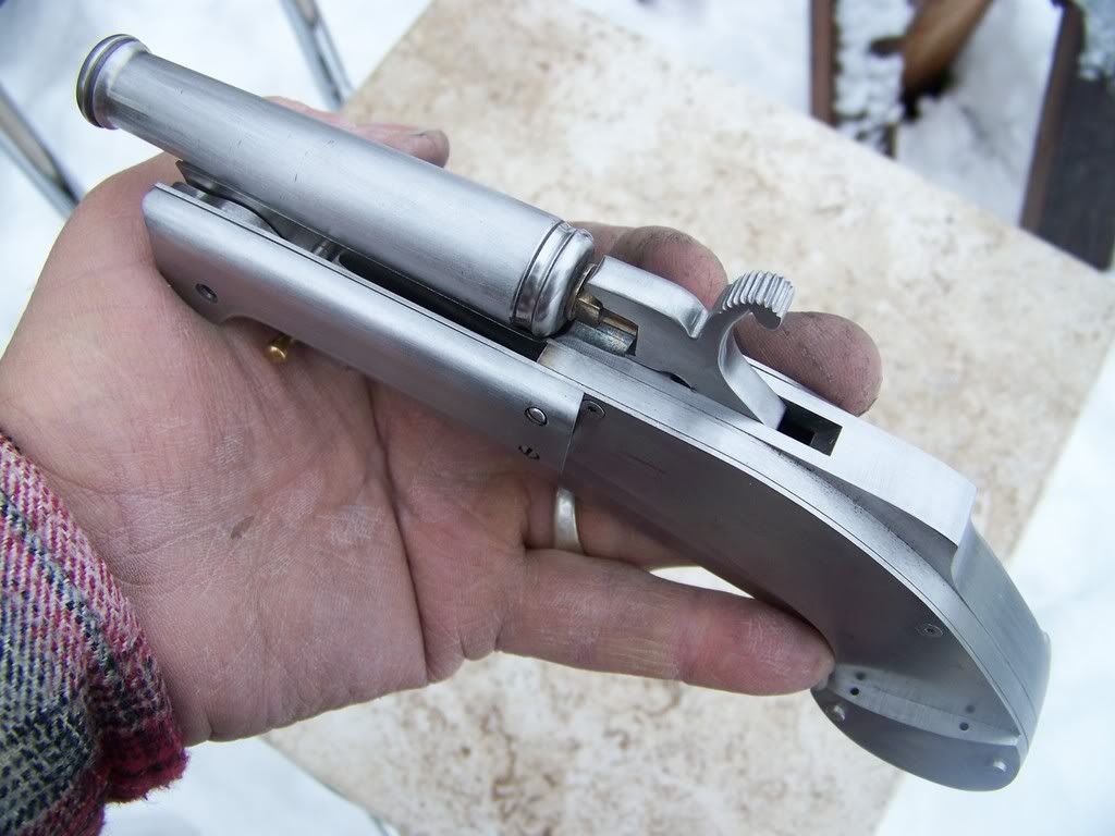

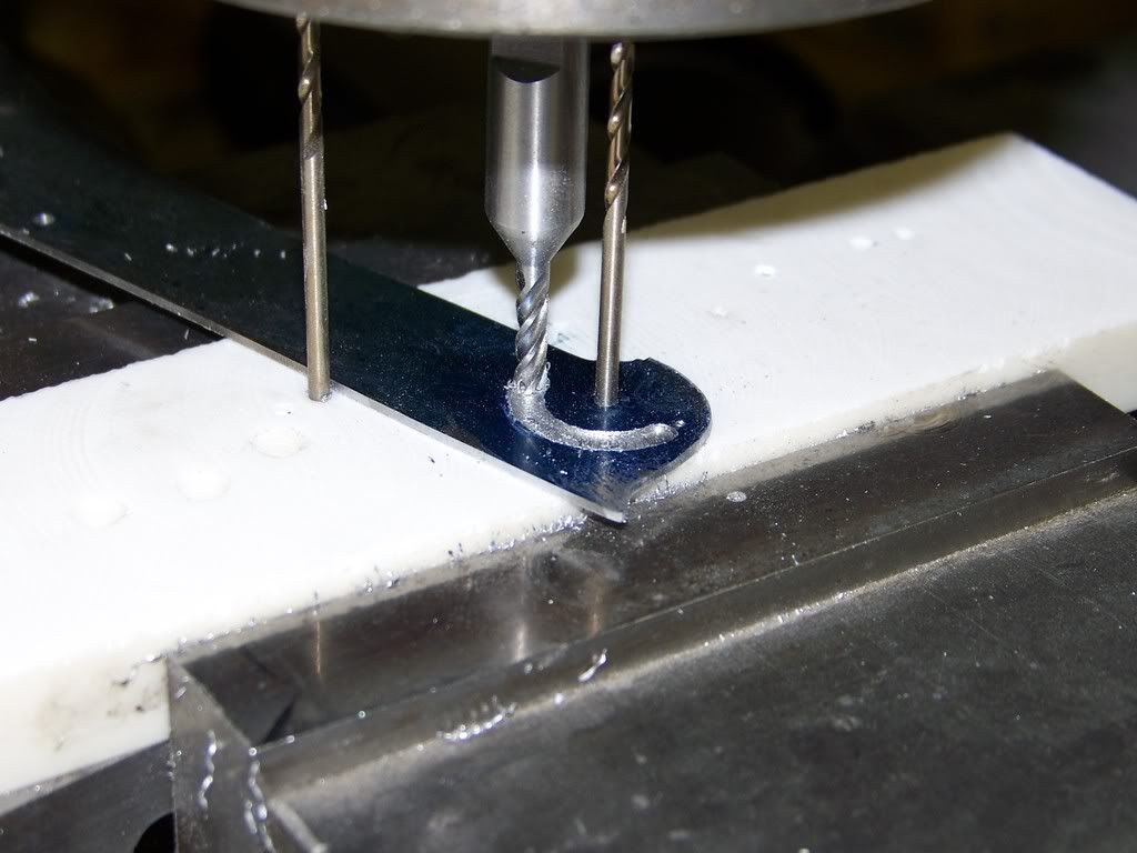

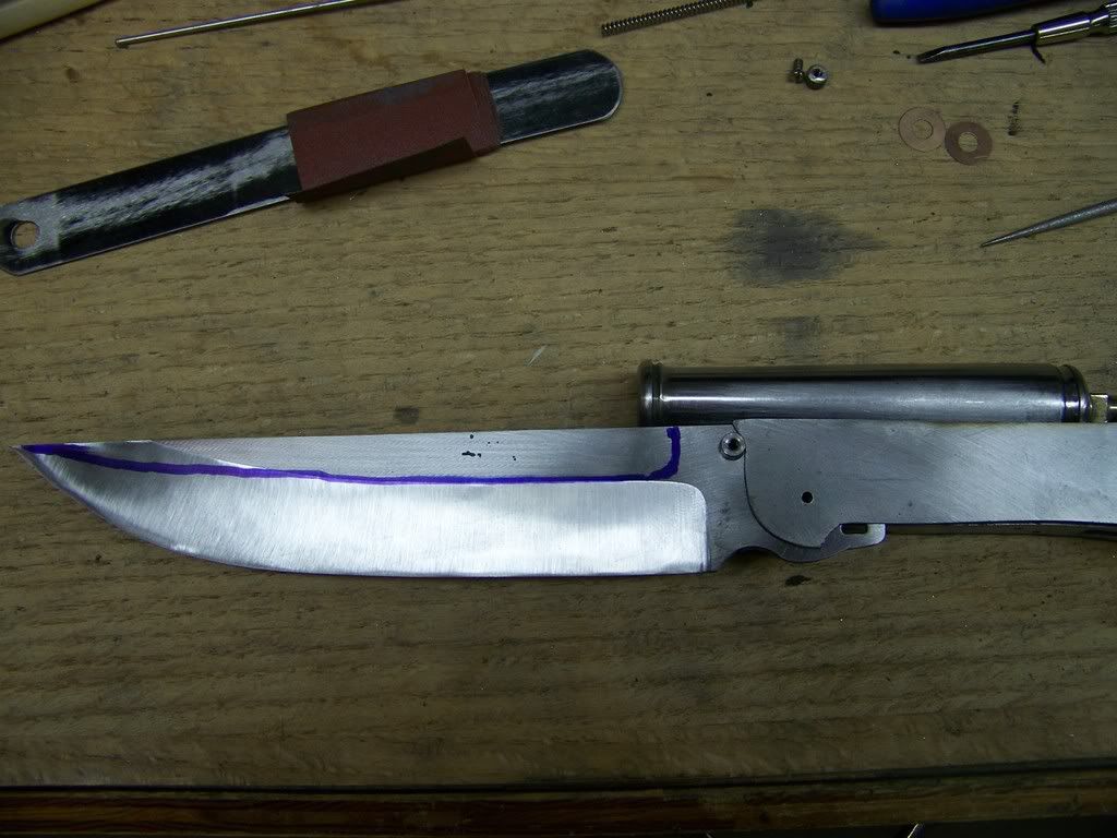

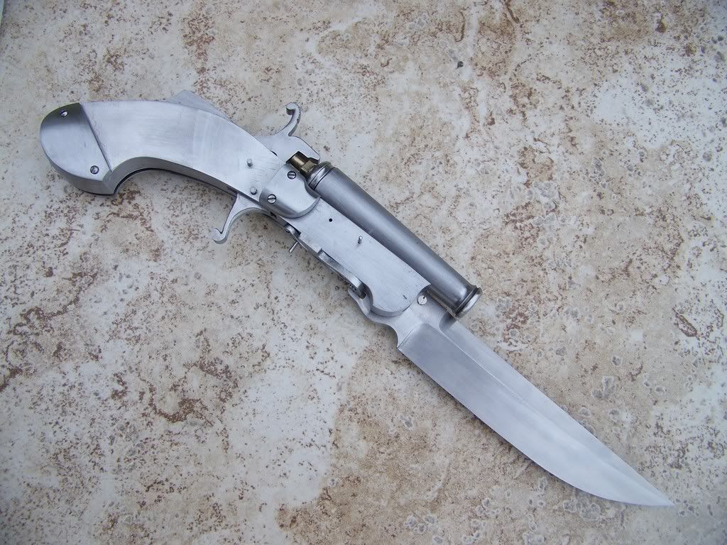

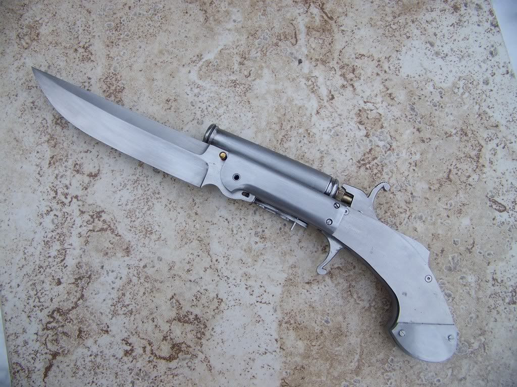

The snow went away for a few days so I had some much needed shop time.
I made some noticable progress on this thing.

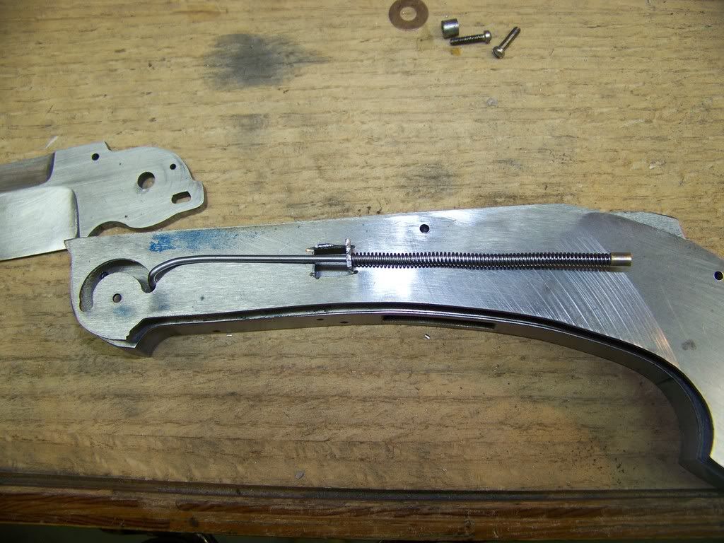

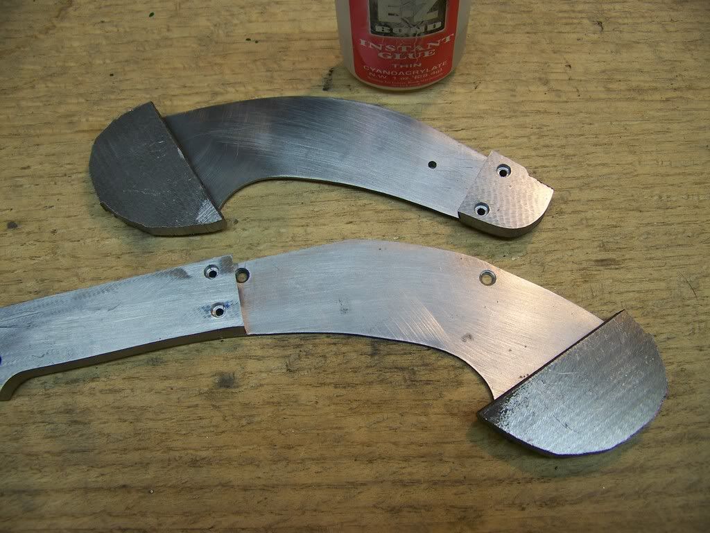

As you can see this is an Assisted Opener. The blade is 6" long and heavy so I needed to add a spring instead of a just bent piano wire. The scale will cover it up. The left bolster is milled out for the link/spring/tab

I have some ivory scales shaping up for it now and plan to have the entire thing engraved by Tom Ferry. My customer wants a touch of gold at the breech end of the barrel an maybe at both ends of the bolsters.
There are several loose ends to tie but its getting there finally.
