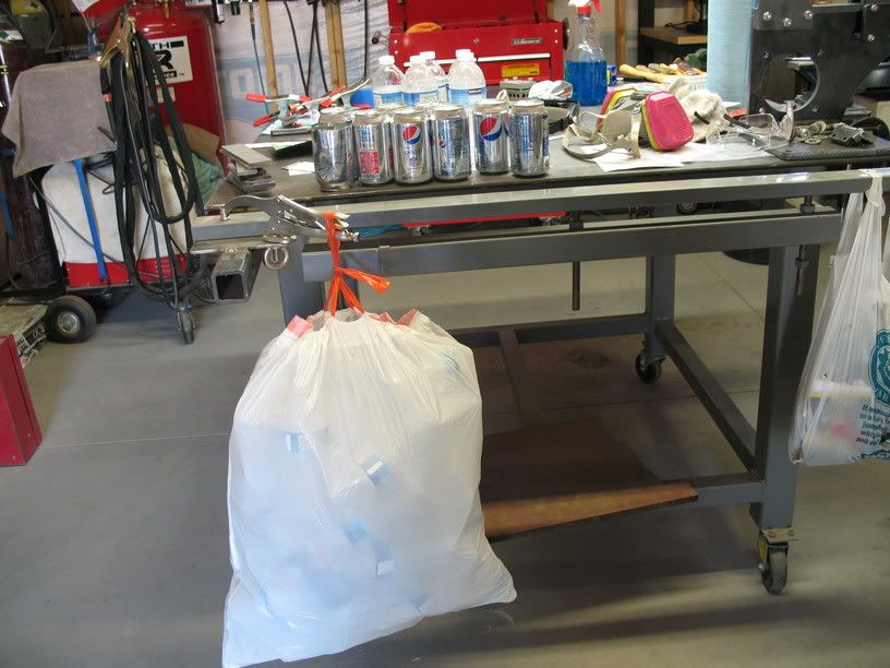

A small sample of the beverages that were injured during the making of this

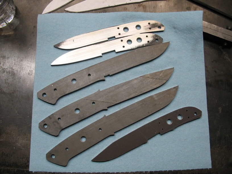

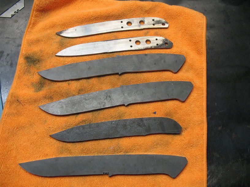

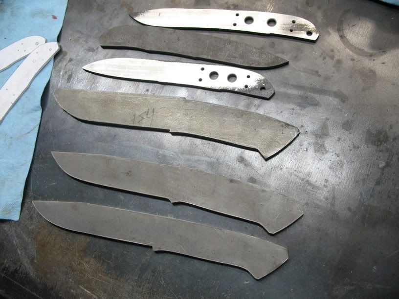

A small sample of patterns. My thought is that if I am going to imitate somebody's work; do it correctly and faithfully! Part of that faithful duplication is that all my blades come from steel patterns. I am enough of a weirdo that I would show up at the Loveless shop with plates of steel and scribe patterns to steel instead of risking the transition from steel/paper/steel. I also go through this process with my original designs.

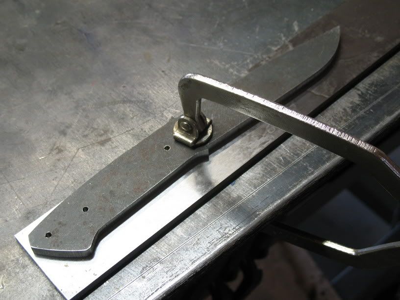

Clamp a pattern to steel and scribe the profile; I think pretty self explanatory.

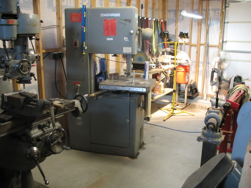

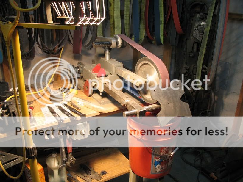

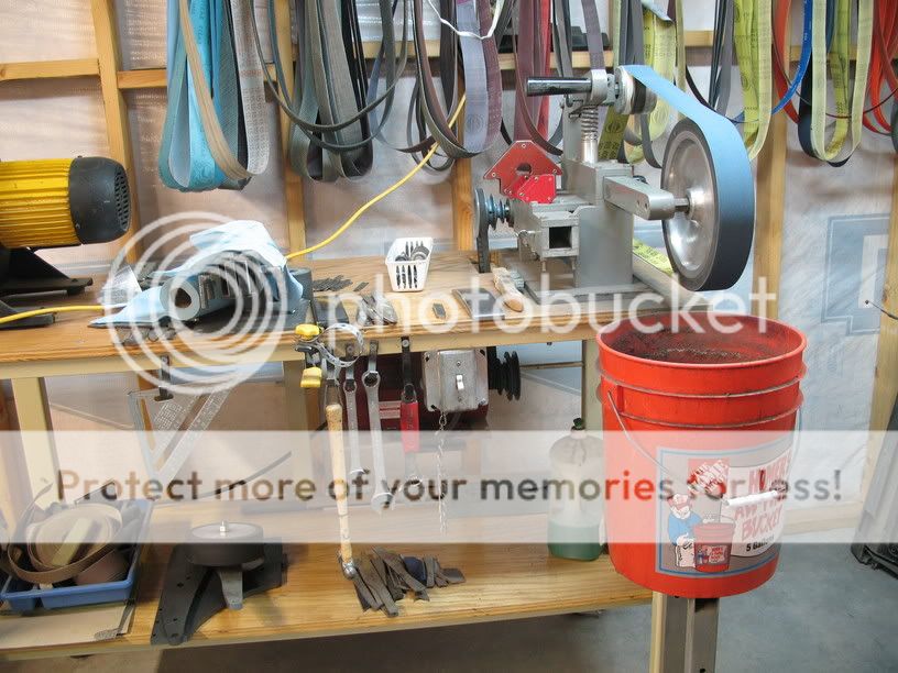

My weapon of choice when it comes to profiling blades (A vintage Powermatic metal cutting band-saw; I love older equipment). IIRC it weighed in at a whopping 1200 lbs. Don't mind the shop It came to a screeching halt when I was diagnosed with cancer. At least there is a roof and four walls (29x32 with 10' walls) just wish it was insulated.

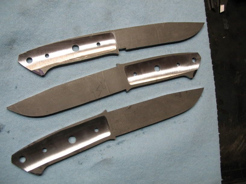

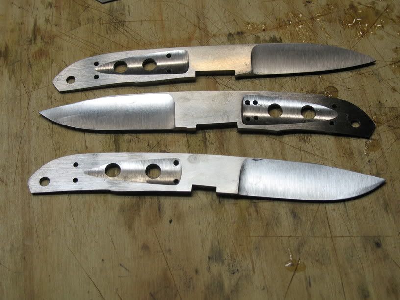

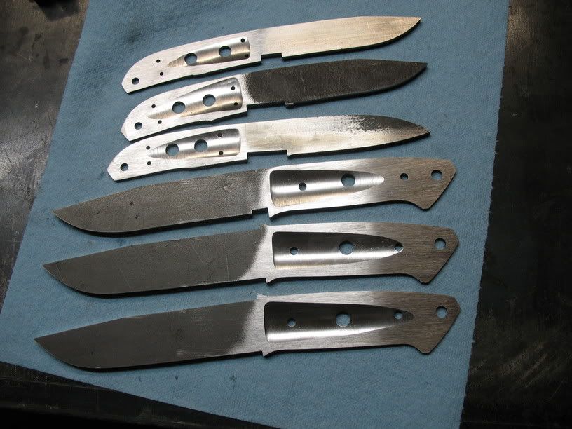

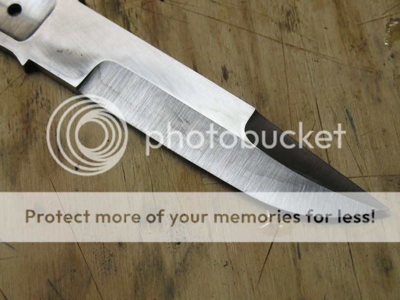

Ground to profile. I try to split the scribed line so that my finished product is as close to the the real thing as possible.

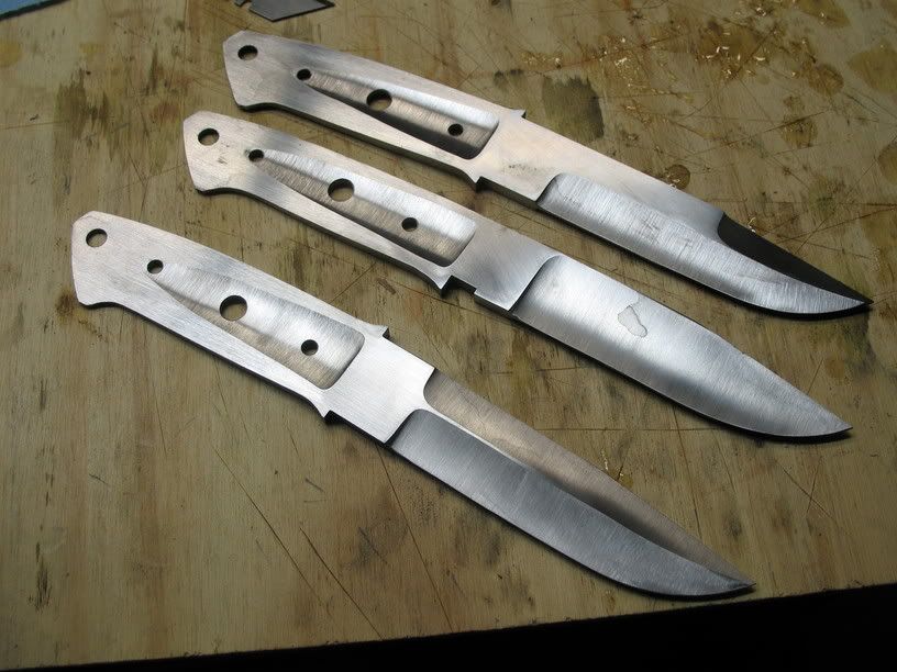

As compared to the previous picture you can see the guard slots milled in along with bolt holes and lanyard tube holes. These two steps are critical to getting a Loveless pattern as close as can be to an original. In previous posts I have thanked those that have helped me to get this far in my short knife making career (1.5 yrs), I would like to also thank (genuinely) Mr. Garsson for providing the impetus to get to this point. I will simply say that he made a comment (in the normal Garsson way) to me a while back that pushed me into finding out as much as I could about Loveless knives and about making them. I still know nothing but I am learning by the day.

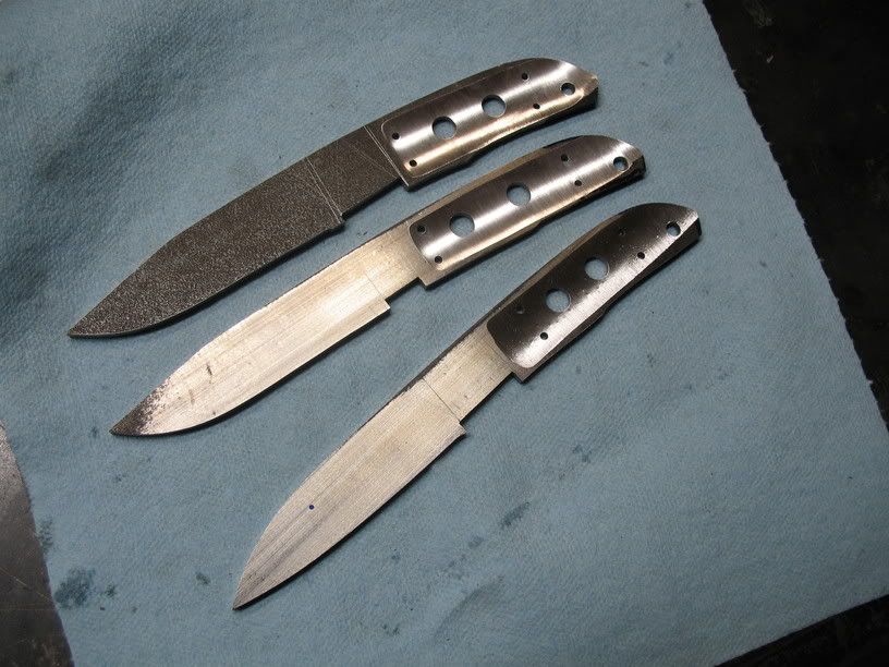

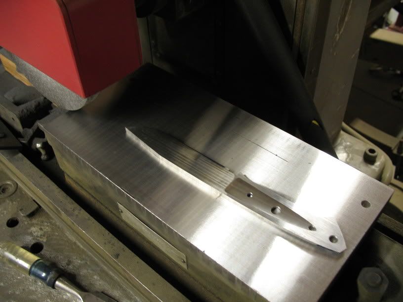

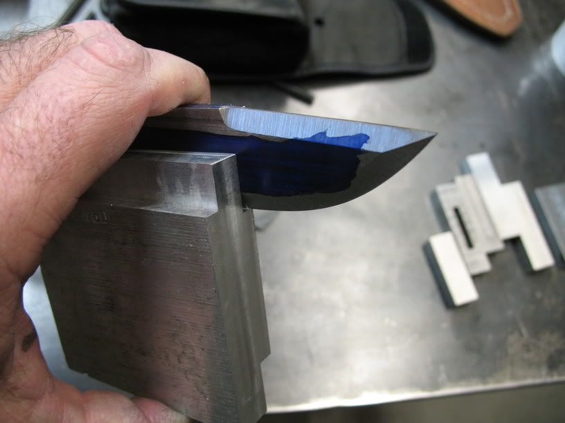

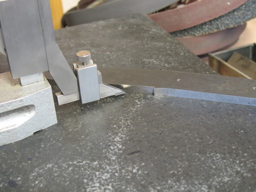

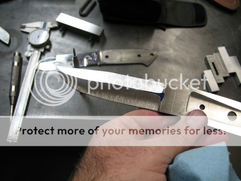

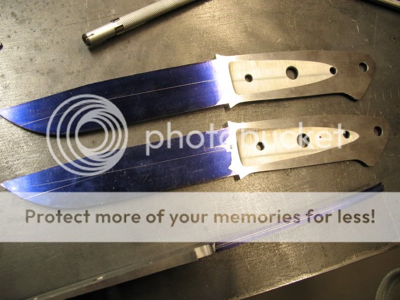

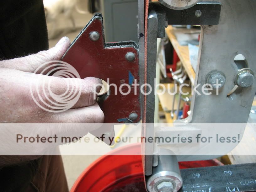

Ready to taper tangs. I "groove" the handle area straight out the butt of the knife instead of trying to make a divot in the center of the handle. I use a height gauge and surface plate to scribe reference lines on the butt and then grind the groove from guard to butt to the depth of the scribed lines.
