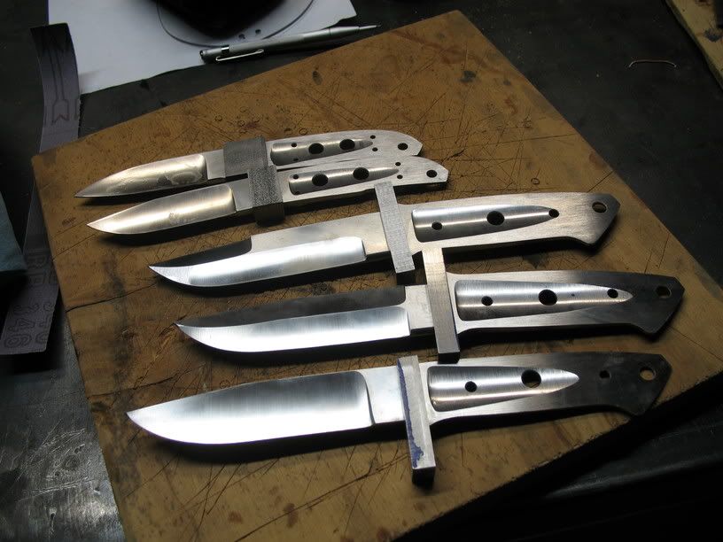

So we left off with the "rough" grinds. I take my blades to 400 pre-HT and then start back at 220 after.

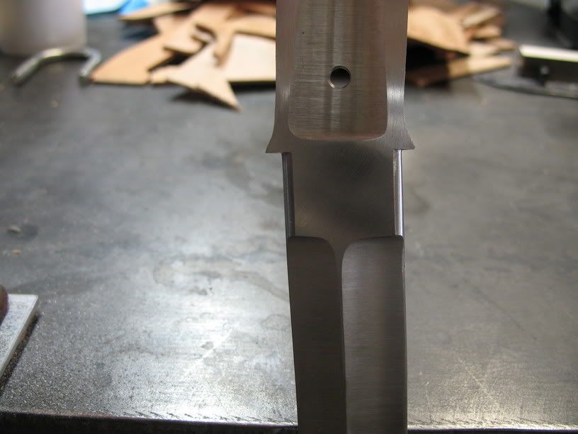

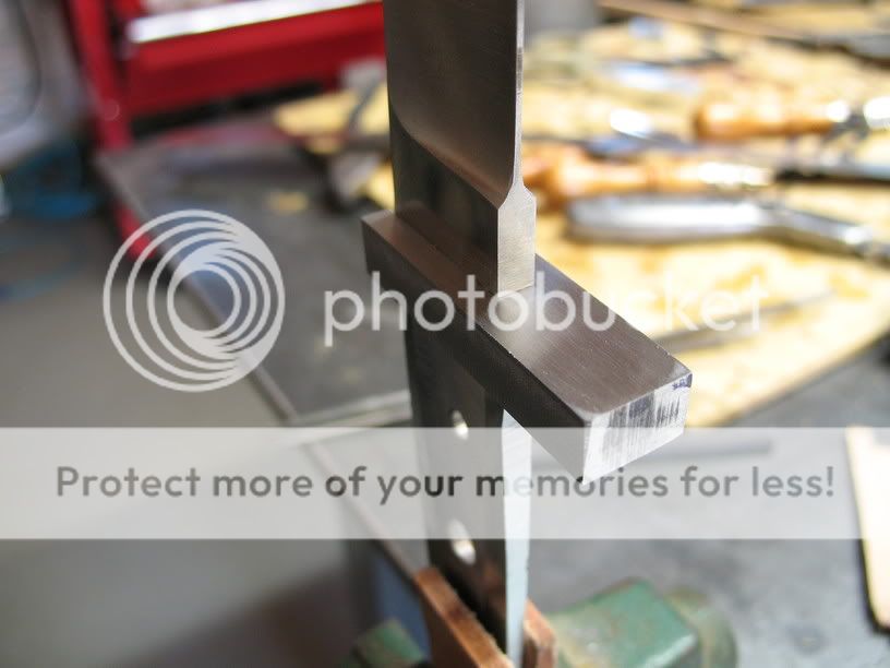

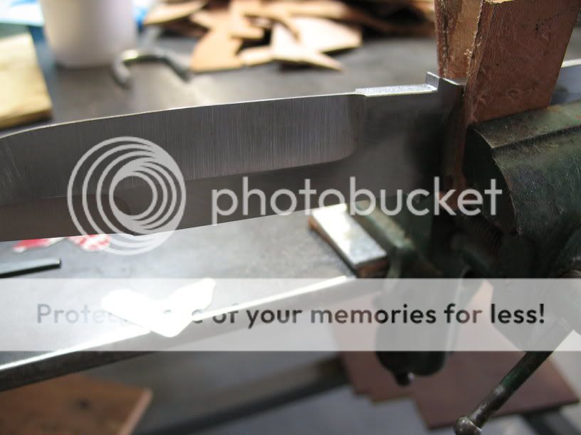

Loveless hunters have a square spine and bottom of the ricasso. The next few pictures really only apply to fighters; most of the time.:D

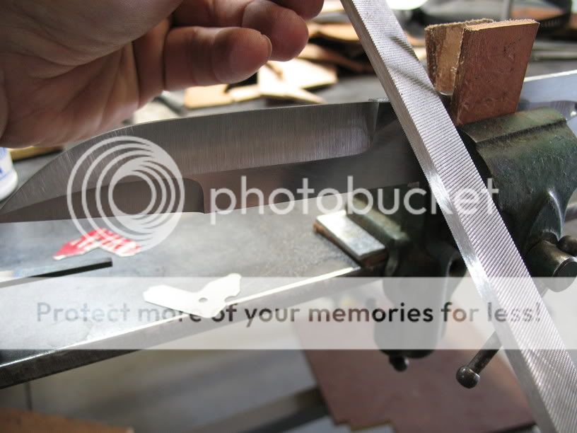

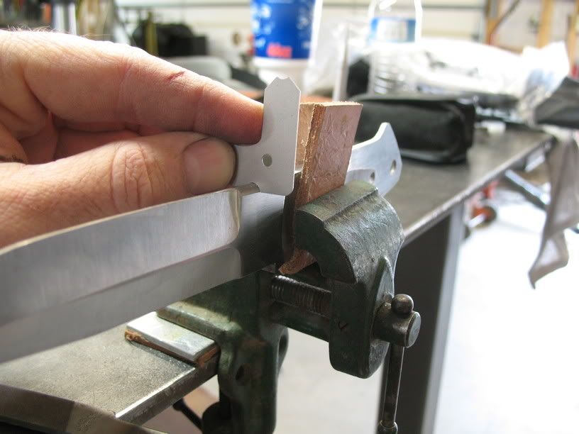

So the Chute is clamped ready to round (don't make fun of the size of my vise). I have 5 different vises and I can't get comfortable doing small/detail work on the larger ones.

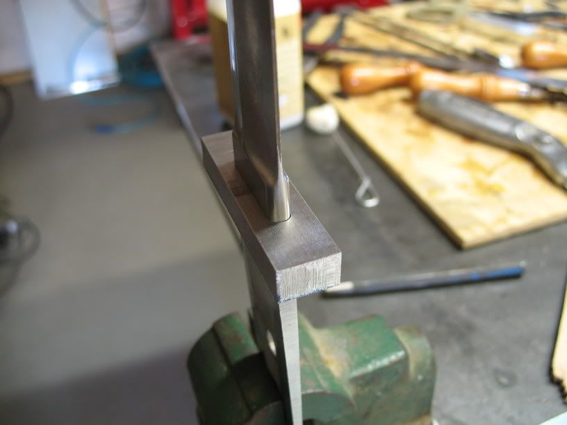

I use a file with a safe edge to file against the shoulders.
And check for perfection.
The Mini-Wilderness with the top and bottom of the ricasso rounded.

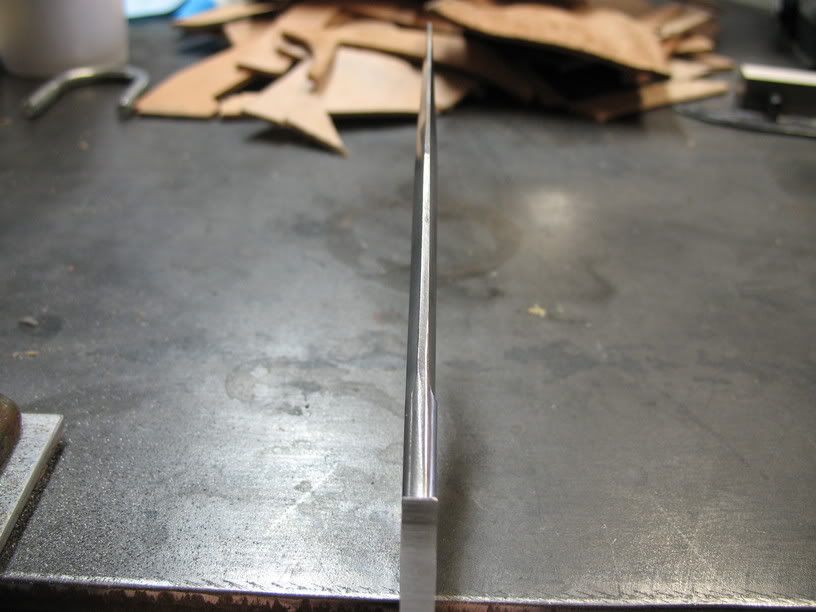

One of the crowning moments of my career so far. Fighters only have the clip sharpened. So to add strength and character there is a nice taper from the top plunges to the break in the spine. Not the easiest and looks killer on the finished knife.
The line-up ready for guards. All ground to 400 on the bevels. Flats are out to 800.

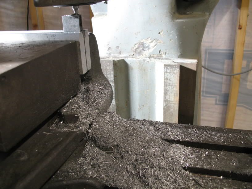

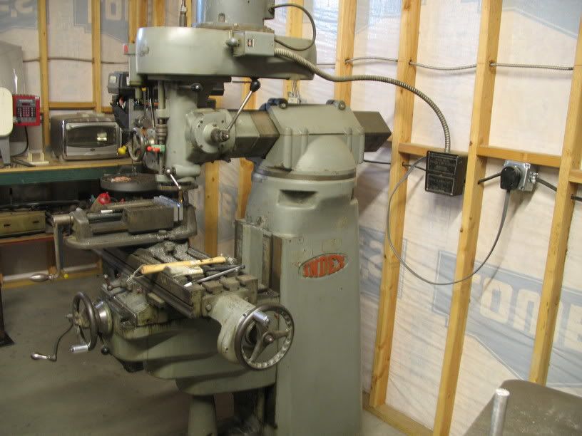

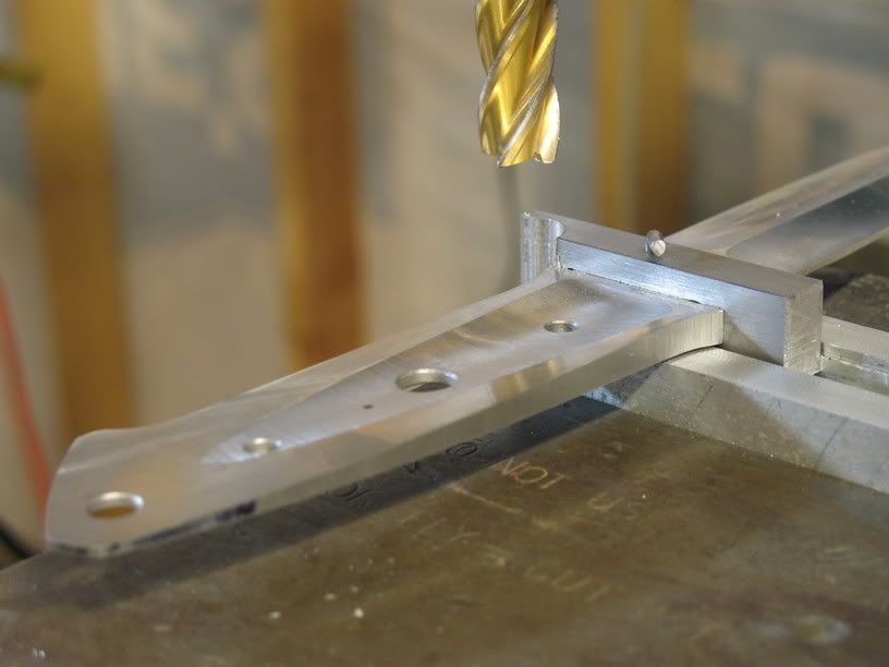

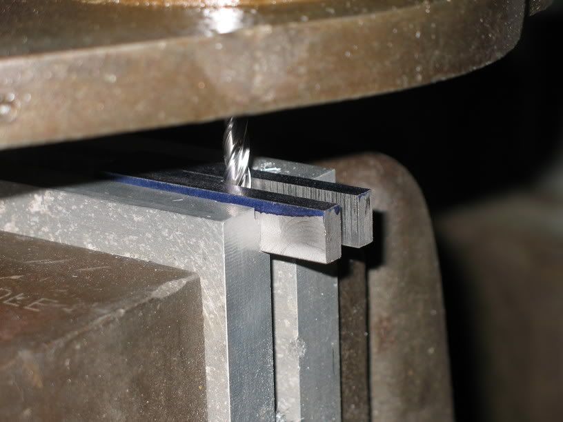

Another one of my finds. A manual Index brand mill. This company is still in business and still made in the USA. They still have records on when mine left the factory and who it want to. I hope eventually to restore it; most of the parts are still available. Just as encouragement, shop around. My mill, vertical band-saw, and surface grinder cost a total of $1950. You will see how accurate the mill and I are in a moment.

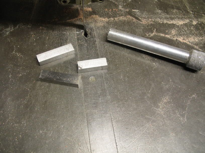

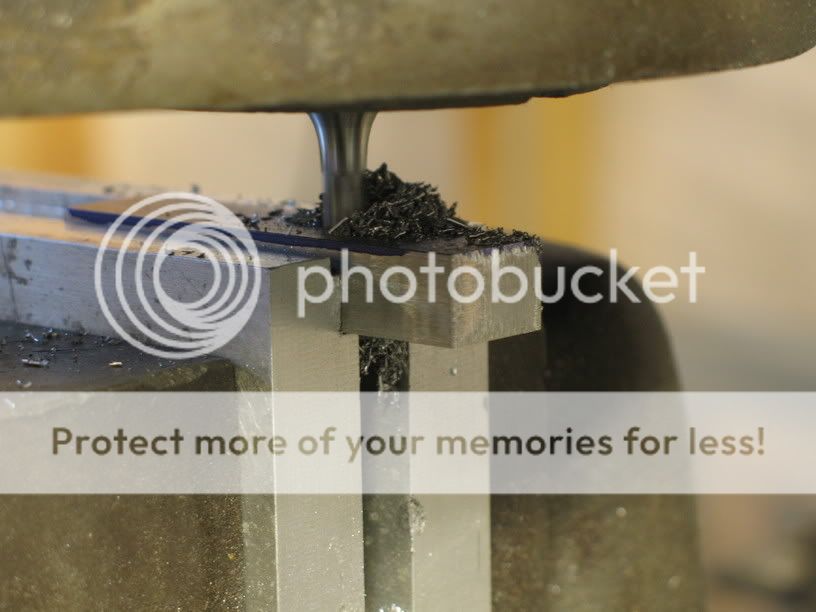

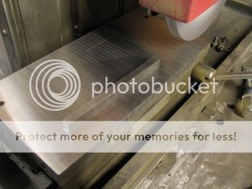

Milling some 416 for the Utility, Chute and Mini-Wilderness to nominal size. I am able to get 416 for the Stiff Horns close enough.

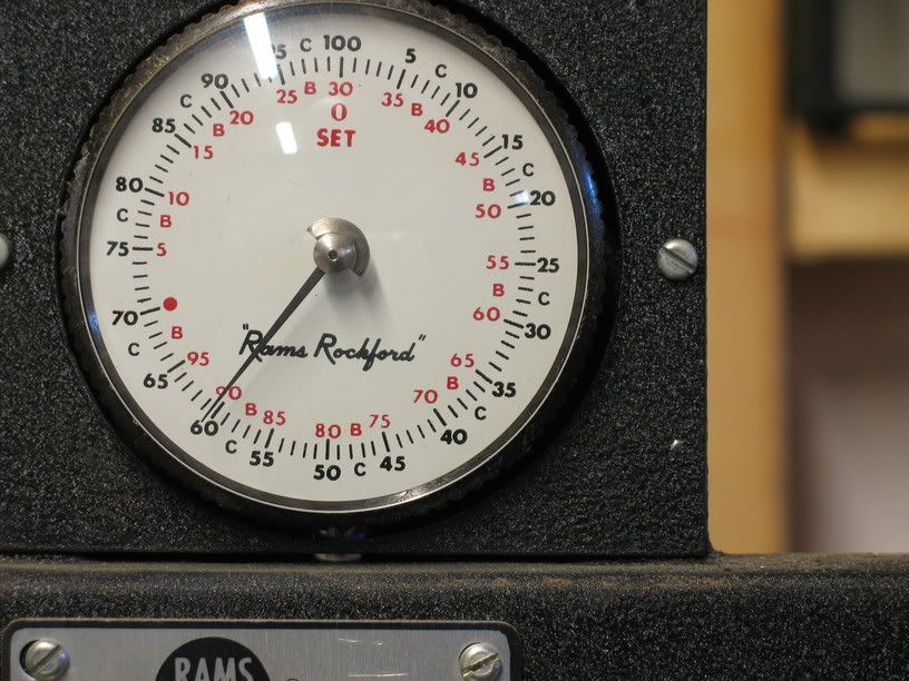

Surface grinding to final dimension.
Cut to size. (that's just a fancy push stick to the right; safety first)

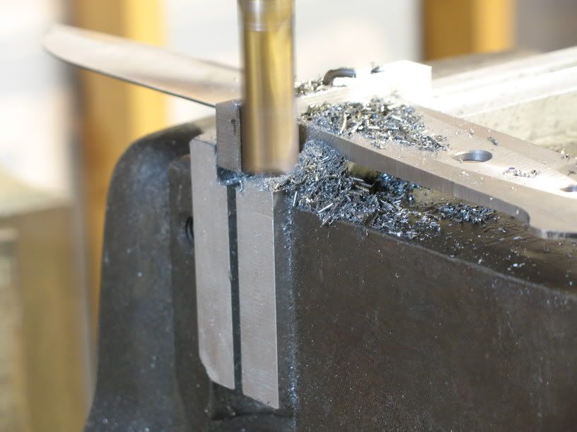

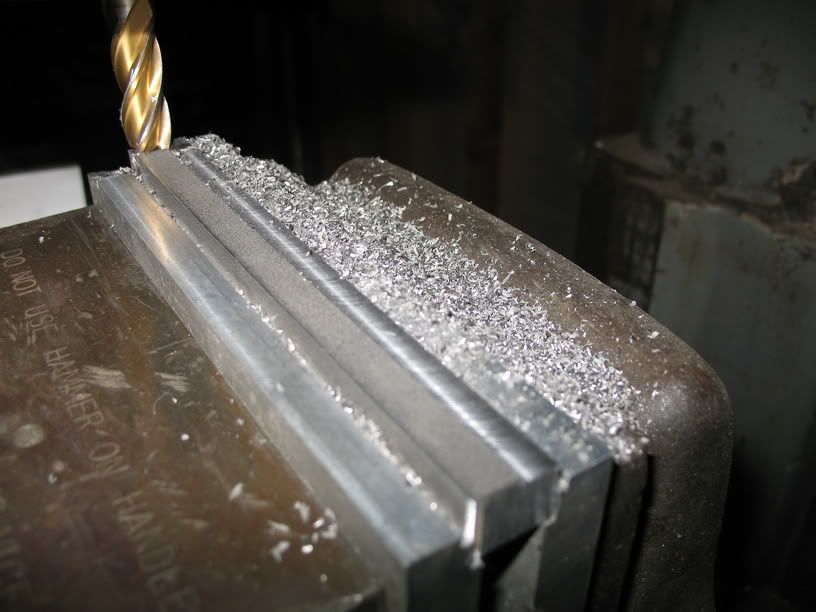

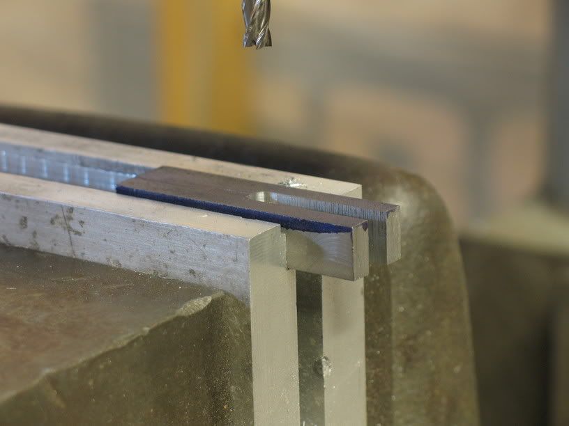

I hate parallels, so I made a pair of aluminum jaws with two steps milled in for different stock thickness. Here milling the guard for the Utility.
Finished.

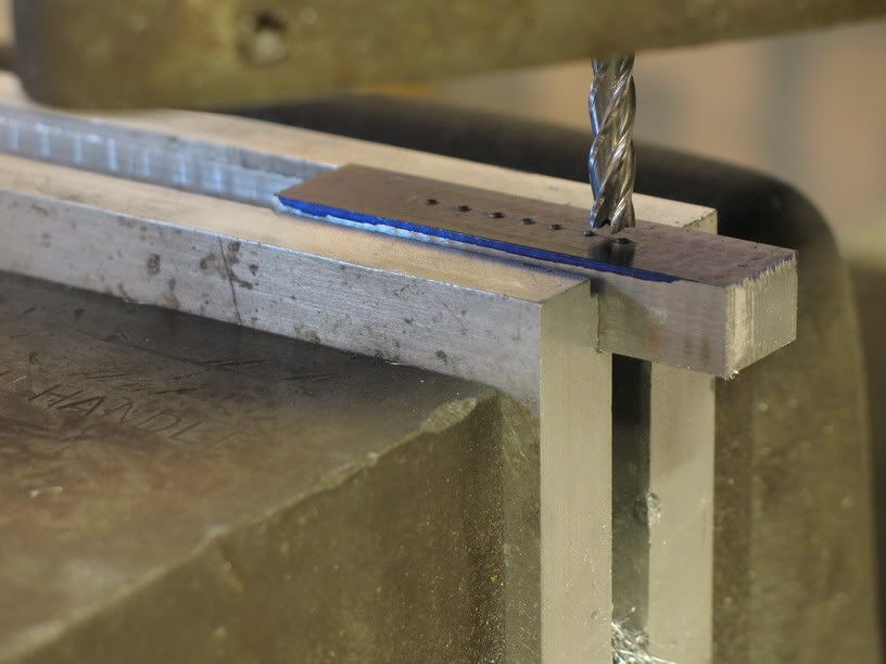

So a little more milling of a fighter guard:
With the size of these mills (a bit fragile) I drill a series of holes to remove some of the material and then connect the dots.

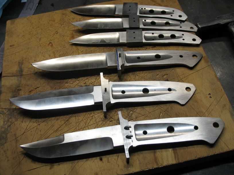

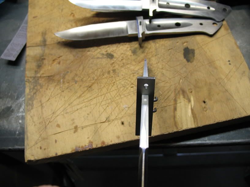

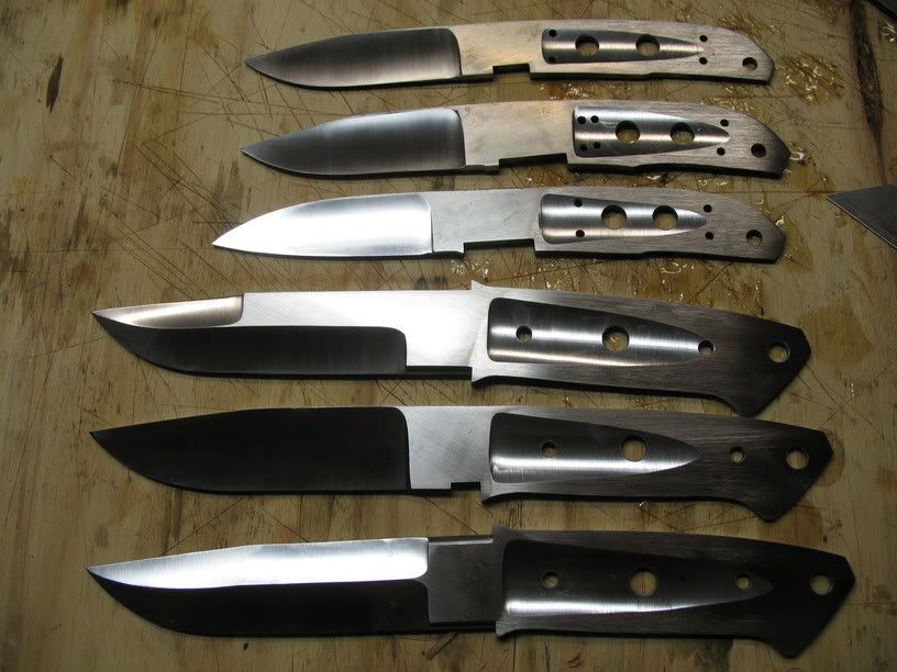

I guess they fit okay? These are straight from the mill, 0 file/hand work.
Guards fitted; I am note sure were the 6th went in this picture.

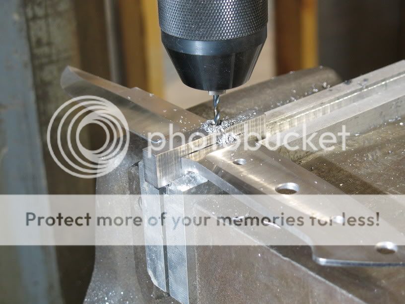

Drilling for pins. Notice the guards just look like chunks of steel:
Pre-HT rough guard shaping.
If I have done it correctly I can remove most of the soon to be waste material and take a bit off of the guard shoulders and create a seamless fit (the reason it is pre-HT).
Guards fitted, pin holes drilled, and I had to go do one more thing:

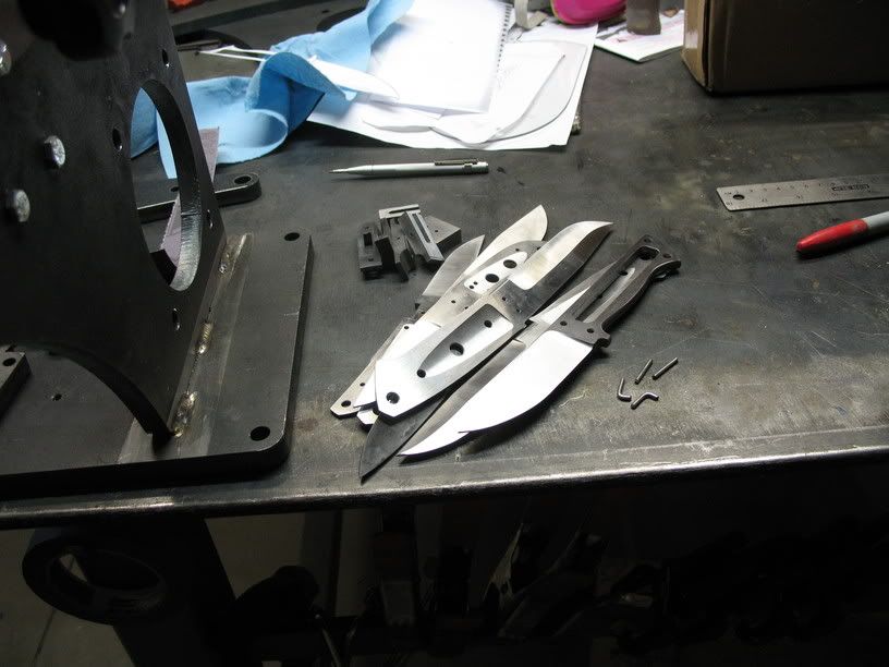

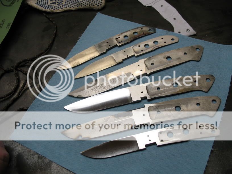

A pile of blades:
Ready for HT

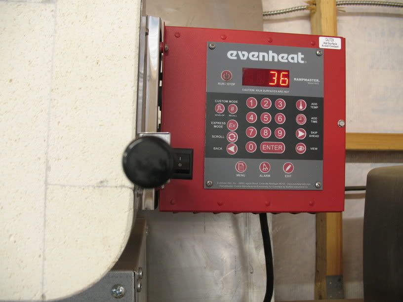

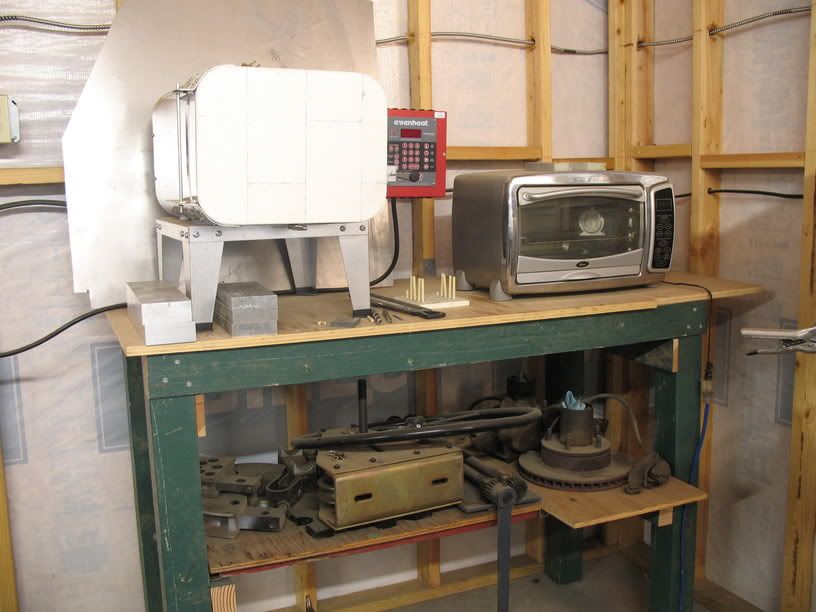

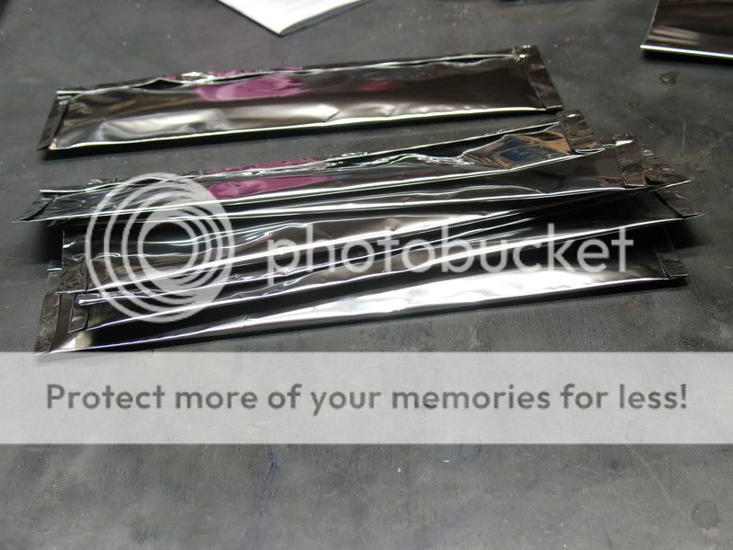

It's kind difficult to document the HT process with only two hands so I will just show before and after.
My HT corner
To prove it gets cool in CA. This was in the shop before I opened the oven door; a strong argument for pre-heating your oven!
It snowed last weekend; was much colder than this.

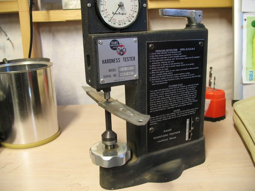

Just to prove they were HTed
It worked!

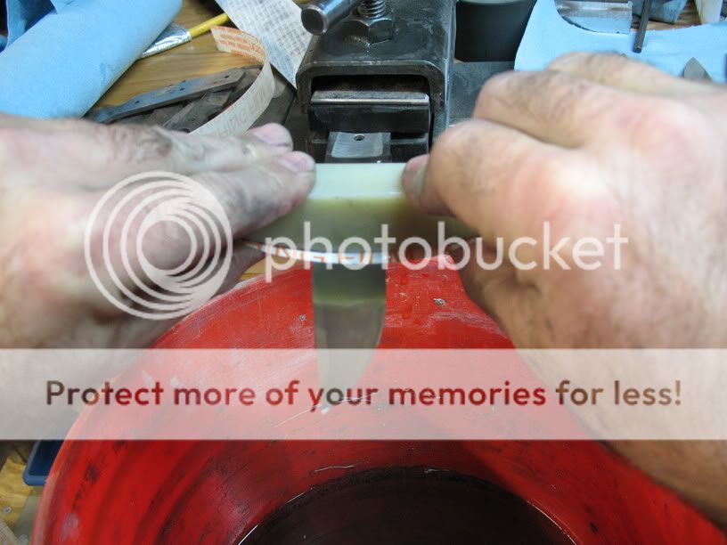

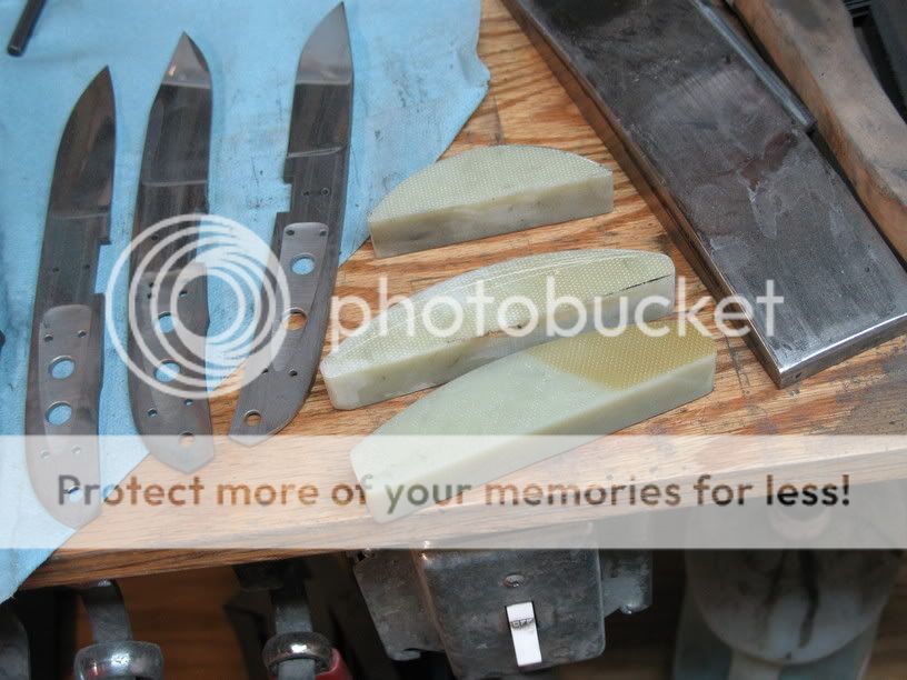

And the finishing fun begins! Finish grind starts at 200 and progresses through 2000. And then...
some hand sanding. Sometimes the monotonous is the most fun (thinking of the recent hand stitching thread over in the Maker's forum).

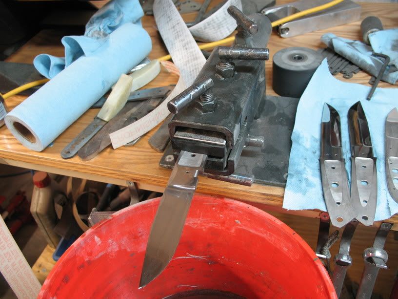

My beautifully TIG welded, multi-levered, rotating, knife makers vise (painted '03 PT Cruiser green).

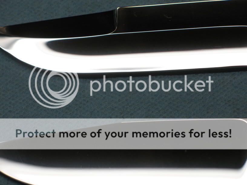

Sanding blocks of G10. I read Tony Bose's hand sanding technique and applied it here. If the blade was ground with a 10" wheel I sand with an 4" radius block. This keeps all the grinds crisp.
Open a can of elbow grease and use plenty of prop wash to lubricate. If the final grind is correct (220-2000 deep scratches gone) I can sand with 15 micron and then 2000 and buff. For me this process minimizes buffer time and buffing away all the hard grind line work. :thumbup:The good news is that this seems harder than it is. :thumbup::thumbup:
Worked pretty well.
