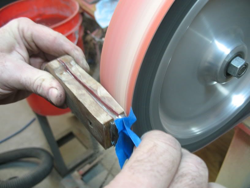

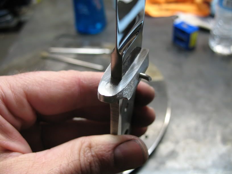

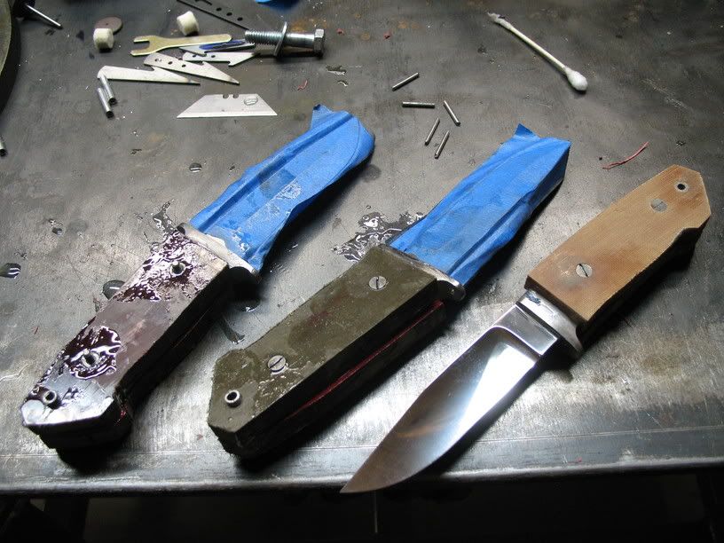

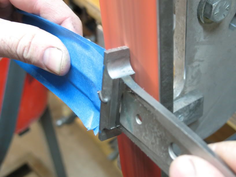

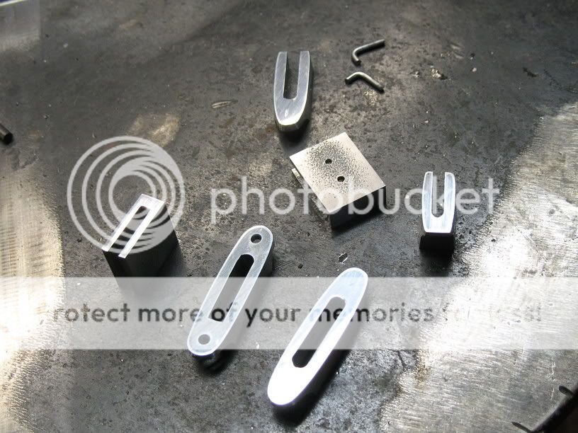

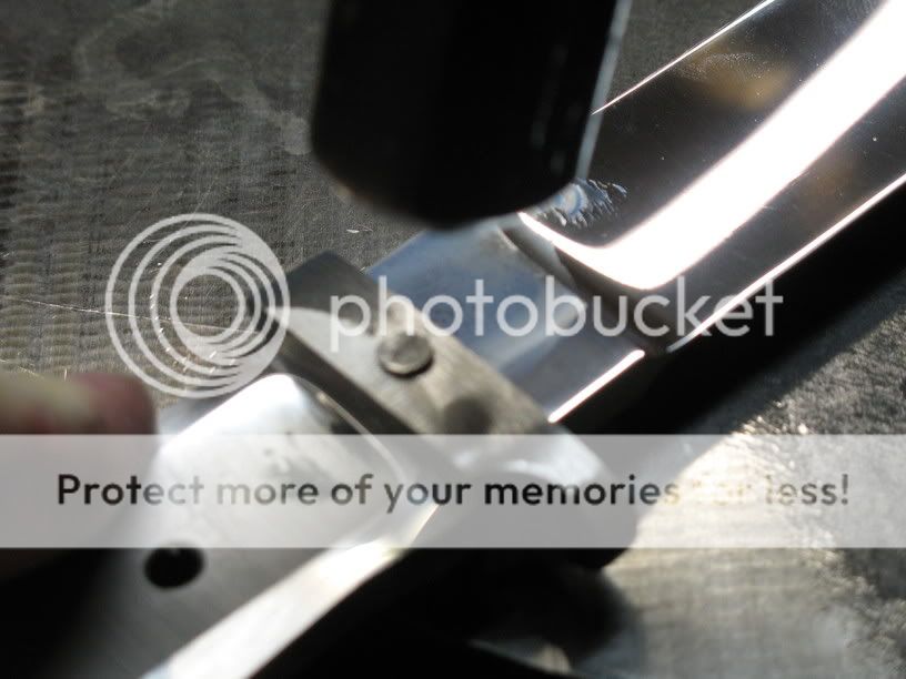

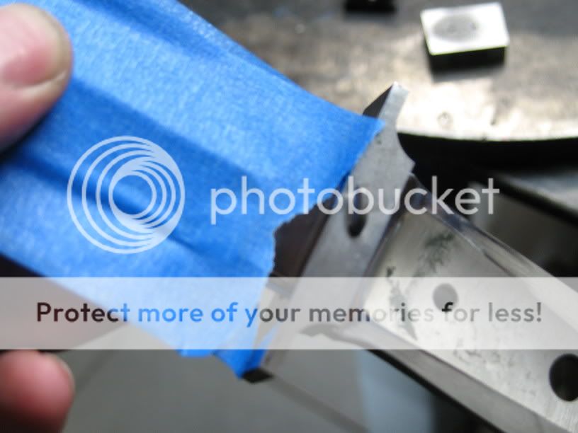

After polishing it is time to attach the guards (pin and solder). Prior to doing that though I use temp pins and rough shape the guards.
Plenty of blue tape to protect my investment of time in the polished blade. Pre-shaping the guard allows you to more successfully hide the pins. Instead of peening or pressing or both into stainless that is going to be ground away you are peening very close to the finished level. This usually insures an invisible pin.

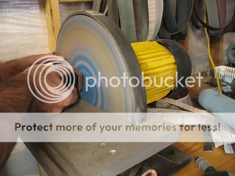

Grinding
A close to finish dimension guard.

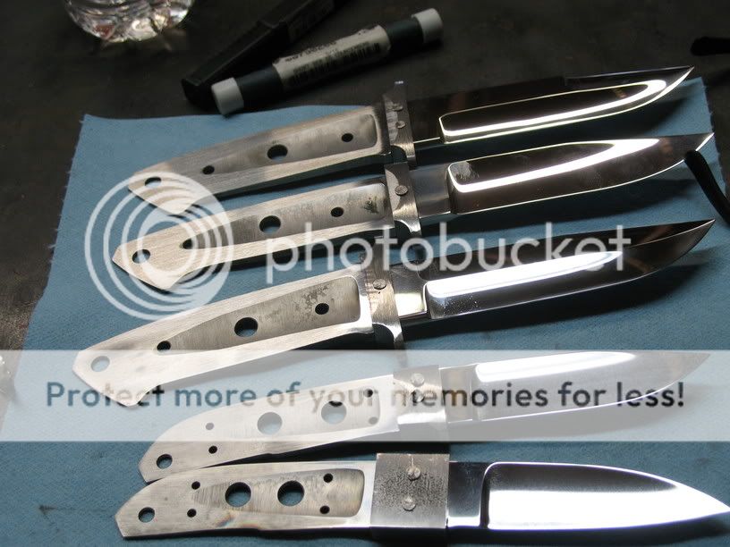

6 guards ready to attach, all sanded out to 15 micron ;close to 1000 grit. Prior to affixing the guards I clean everything thoroughly with duplicolor wax remover and alcohol so that I don't end up with an surprises when I solder.

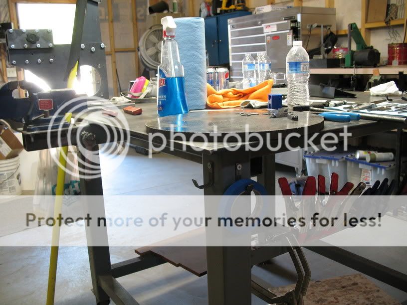

My peening surface, ( I would eventually like to own a nice post anvil for different beating jobs) a 4x4 steel leg supporting 3/8" steel top with an additional 3/4" plate on top of that; works pretty well. I have so far been successful without a pin press so I will probably continue with this method.
Peening and peening...
and done. On to soldering.

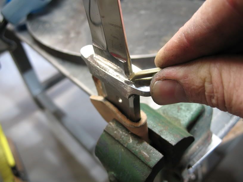

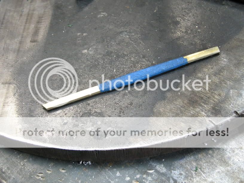

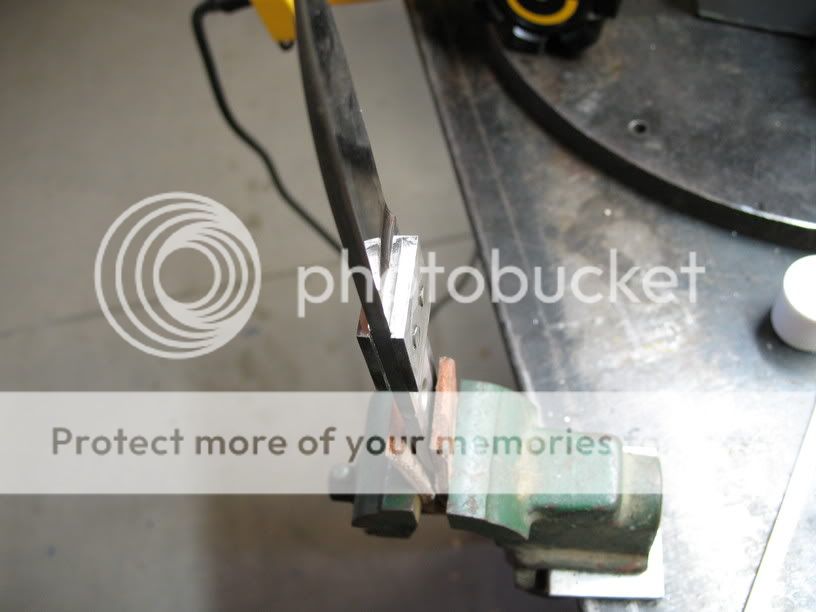

Being new and still anxious about some processes I didn't get many action shots of this, also for what ever reason my camera refused to focus on this part. So just a few to move us further along. I use a piece of rectangular brass stock as a graver. I round both top and bottom to give a nice concave fillet.
Set-up in my mini vise and ready for solder. I use the same process detailed in the SRJ sub-hilt DVD.

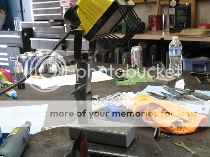

Post solder clean-up aided by my...
copy of Nick's desk lamp. After I am happy with the solder joint I move on to handle material.

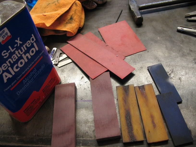

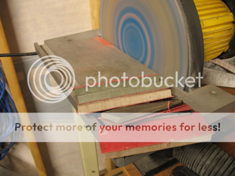

Flatten all of the handle material.
Blast both liner and handle material, and then...
wipe down with alcohol...

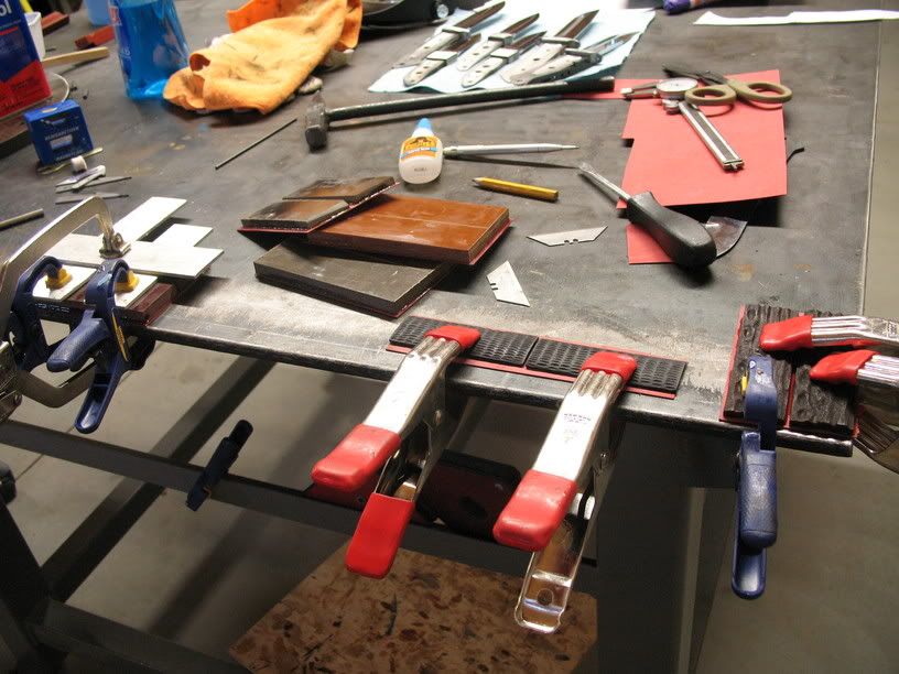

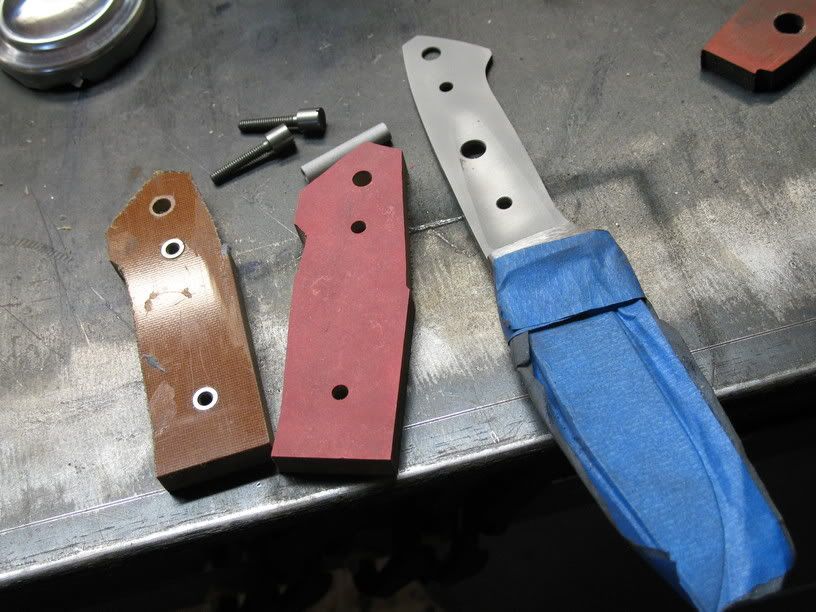

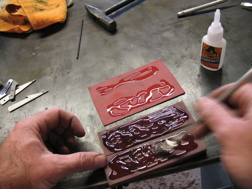

glue...
clamp...
and then clean-up of the pre-glued liner and handle material. This may seem like a lot of work but I do this process in the evenings because the day job won't allow much more and it is still forward progress! As you can see mostly Micarta, (much to Steven's chagrin).

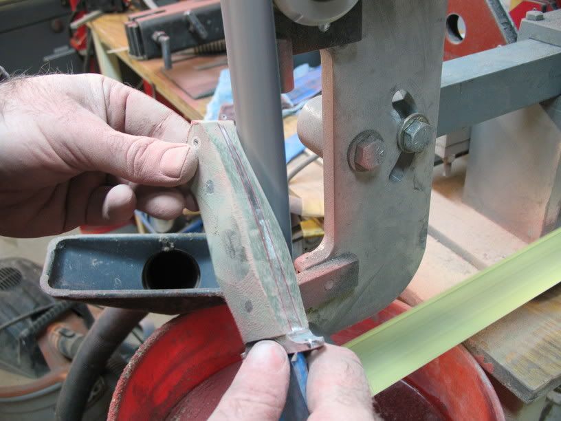

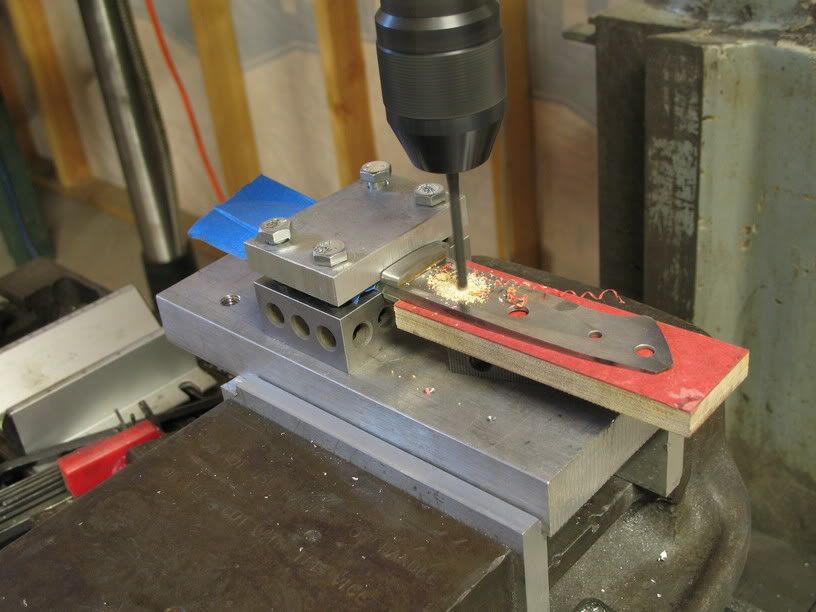

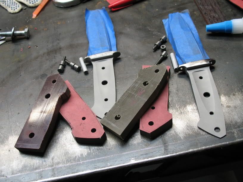

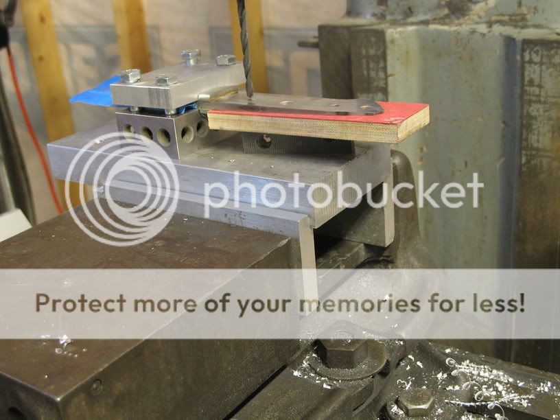

So I got all the handle material glued up and ground an angle in the handle material so that the handle material meets the guard correctly. Now the issue lies with getting an angled hole drilled through the handle material when the tang hole is straight.

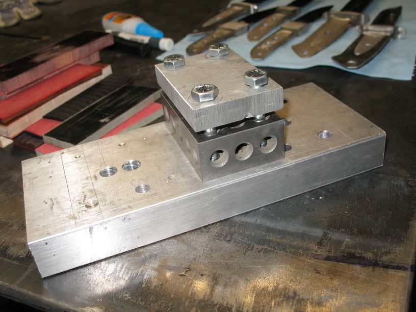

My tapered tang handle drilling fixture. It consists of a 1-2-3 block, a few bolts, and some aluminum. BTW a similar fixture is shown in Nick's and Charles' epic build threads.
Clamp the knife by the flat ricasso. If you blade is straight then you should be able to drill straight through the tang hole. I use two drops of glue to hold the handle material to the tang as well as a Micarta wedge to support the handle while drilling. The glue may be an old trick but I will credit Mr. Terzoula; I read about it in his folder book.
In the mill vise.
And drilling.

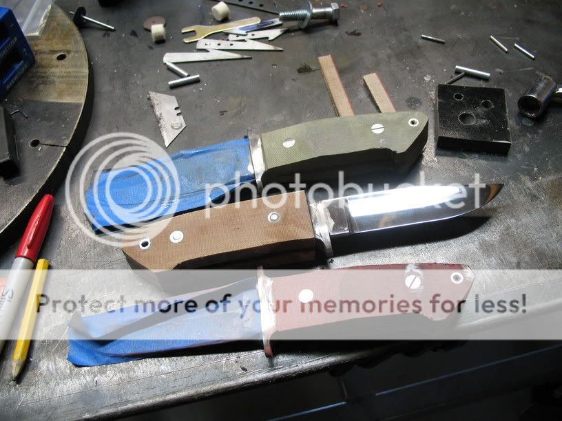

Knife and handle material blasted and ready for glue up.
Glued, bolted and dry. You can see I already started grinding the hardware flush.

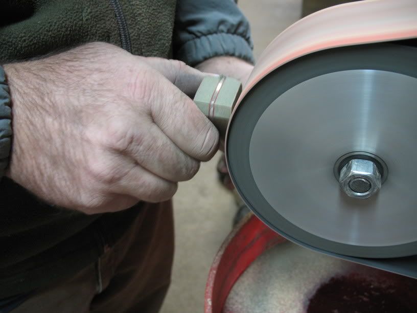

Grinding the handle hollow.
Rough shaped close to slack belt time.
100-15 micron to get to the finished handle.

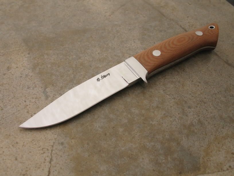

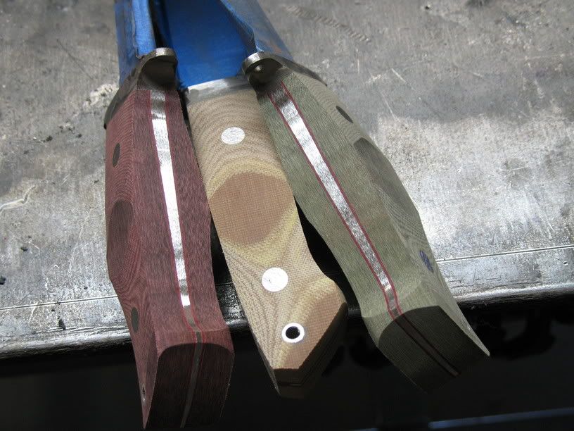

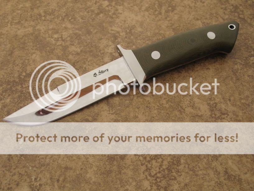

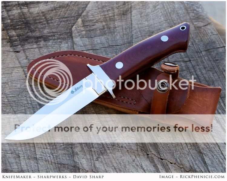

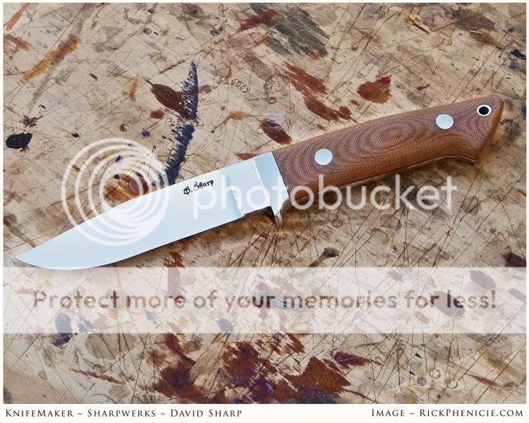

And after some fine tuning you end up with the finished knives (buffing, logo etch, satin flats, etc..). I will need to post the 5th knife later I just finished it yesterday.

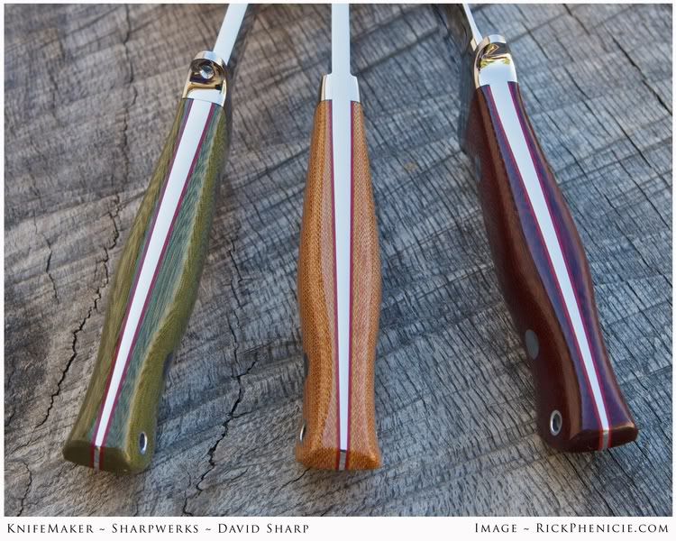

Traditional Chute with green linen. The color is off in the second photo.

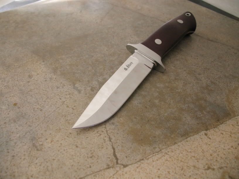

A Mini-Wilderness with maroon Micarta
A standard 4.5" Utility Hunter.

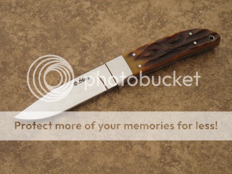

A Utility Stiff Horn with jigged bone. This one has a very small guard; after finding pictures that indicate there are some that came form the Loveless shop this way (Mr. Merritt confirmed this). It makes for a better feeling knife.
