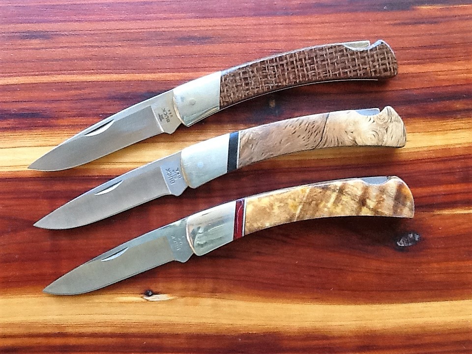

sk, please do this 501 in s45vn steel, but with some good wood (ironwood, bubinga, etc) instead of a plasticky burlap micarta? :) ... or at least offer a burlap micarta that is much more dense and less polished? what you have now with the 501 is a great option, but it seems the burlap is so loose that it's really just thick resin over a picture of burlap (if you see my meaning)

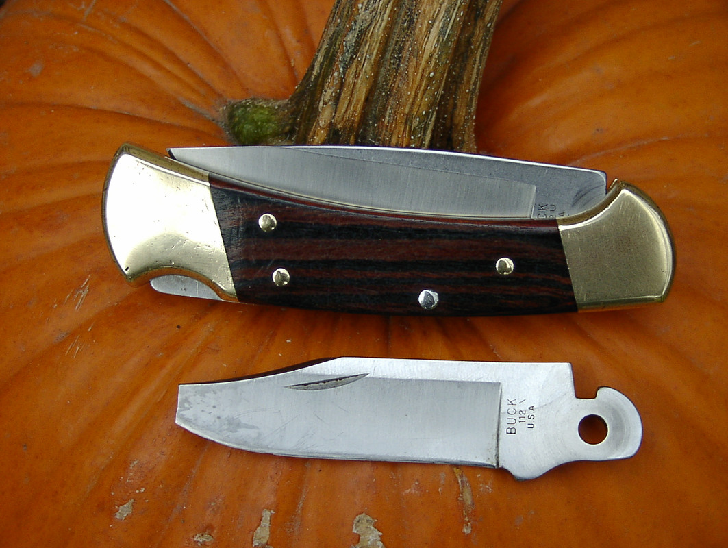

If everyone's suggestions fail to get the knife to close every time, one option would be to send it to Buck. They might have peened the pivot pin a hair too tight leaving the blade tang and bolsters rubbing. They can drive the pin out and replace it with the correct amount of tolerance. If it were mine, I'd probably keep it and work with it until it freed up, as the end result will be a very tight knife without any perceptible blade play, which is a good thing.
I recently replaced the blade on a 112 and peened the pin slightly too tight - you can see some wear marks forming on the tang. I work with it from time to time it is slowly getting to better at closing all the way under it's own power.
