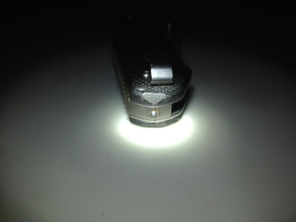

I had a feeling I might find this problem on here. The EXACT thing just happened to me. I have owned and used knives with glass breakers before, and while taking the recycling out tonight, it occurred to me that I had never used it on my EDC Contego, so popped a champagne bottle a couple of times, it shattered easily, and as I was putting it back in my pocket, it felt funny, took a look and the backspacer snapped, looking exactly like a broken piece of cast metal, or a broken high-carbon file. Based on the rust, I don't think this was a stainless piece. I take extremely good care of my knives, and wasn't quite so shocked at it breaking, as I was that it broke as such a MINOR few taps on non-tempered glass. I'm certainly glad it happened now instead of when and if I really needed it. No complaints about Benchmade aside from that, but I did upgrade to this from my Rift solely because it had a glass breaker. I'd be carrying it or my Skirmish around still but always liked the knowledge of having a GB on me at all times. Glad it sounds like Benchmade was/is willing to send you a replacement part, as I have no trouble replacing the piece on my own, and would prefer it to sending my EDC away for who-knows how many weeks for "repair". Does anyone else have this problem? I LOVE this knife aside from this problem. But would like to feel that after being replaced, it shouldn't happen again....Other side note, minor issue but when the backspacer snapped and swung out, the inside of it hit my blade tip (while it was closed in the handle) and dinged about a mm. off of the point. Which also indicates to me that the entire backspacer is high carbon, as if it as a more mild steel that the carbide tip was embedded in, I would imagine the blade would have cut into the backspacer, and not the other way around.

Interesting to note that my break was exactly the same place yours was, between the second and third teeth from the top. I also included an image of the glass breaker to show just how much I was NOT using it before this break.

It has broken, where the backspacer is thinnest.

`The back spacer does look cast or MIM. Discouraging. Some firearm manufactures have used this process for parts to cut costs. Parts that have little or no stress load. A back spacer with a glass breaker would potentially need to withstand high stress.
Yeah, I broke a bottle just because I had no junkyard tempered-glass window to experiment on at the moment. But my thought is that a glass bottle should be incredibly less stress to break than a flat, tempered glass window. And I did it holding the bottle and knife bare handed, so clearly was not even striking it very hard at all, more like a good couple taps.
One thing I have considered, was that if you view the backspacer apart from the knife, you can see its kinda "J" shaped, with the breaker tip on the curve of the "J". SO the whole point and pressure of the impact is therefore not in-line with the main "Shank" of the backspacer, thus the shock of the strike will translate out to the weakest point of the curve...If that makes sense.
Kinda like the difference of force between hammering in a straight nail, and hammering in a bent nail. Just saying that in retrospect, the very point of where the glass-breaker is placed onto the backspacer is setting up a fracture such as this to happen.
Not to mention- a part like this is cast? WTH? I don't know who thought that was a good idea. I think that once it's replaced, I'd like to touch the broken one to a grinder just to see what kind of sparks it throws, as I have a feeling it's tempered/high carbon. Which, someone correct me of I'm wrong, but wouldn't it make more sense to have this particular piece a softer steel that the carbide glass-breaker is embedded into, in order to absorb the shock and thus prevent this kind of thing from happening?
