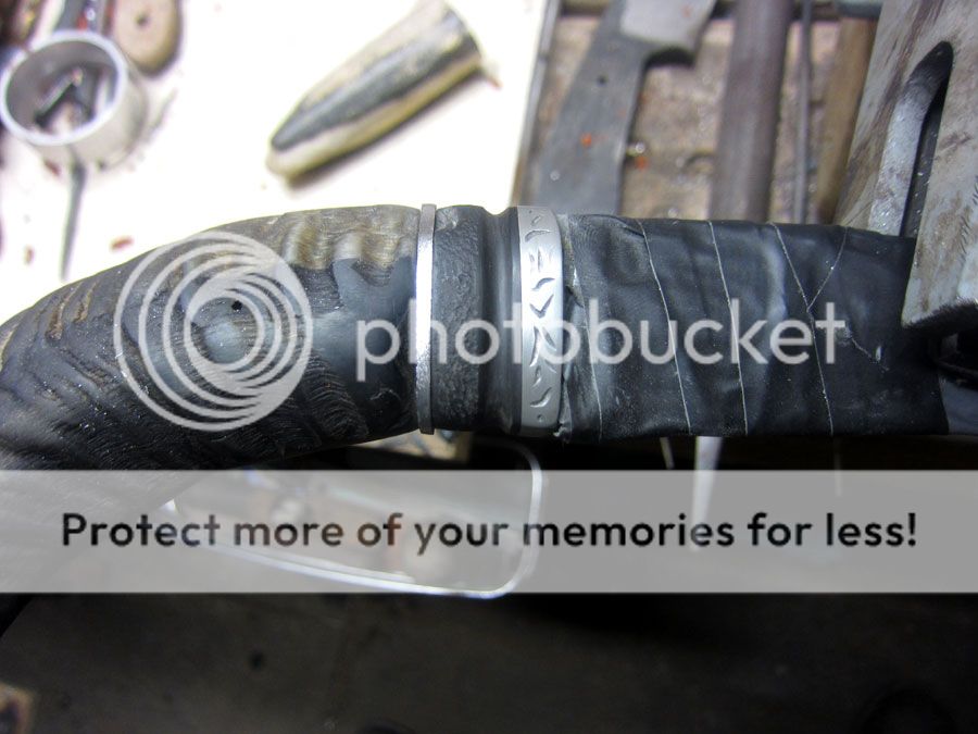

Thanks folks.. I'm going to put some pictures in this thread later today.. but I've run into a little puzzle. I'm having some difficulty getting a transition between the horn and the ebony that I'm happy with. It's one of those things where the colors are too close to look right if you know what I mean (unbalanced contrast). So I'm going to try another, thinner, silver pewter spacer between the two. This may mean fashioning another ebony piece under the guard/spacer. One difficult issue is that the black on the horn is very thin and very easy to get into pith... so I have no room to work with that...
A thought just (at this very minute) struck me... what if I texture the ebony to provide the necessary contrast? This would also solve what I thought of as too much 'blank space' in that piece of ebony anyway....

Carving the pewter...
Cleaning things up with loose 600 grit silicon carbide and horsehair brush...
This afternoon I will cast a spacer ring for between the ebony and horn.... and then texture the ebony.

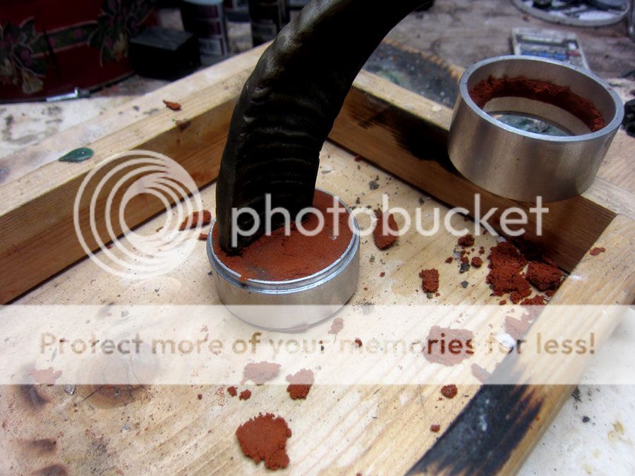

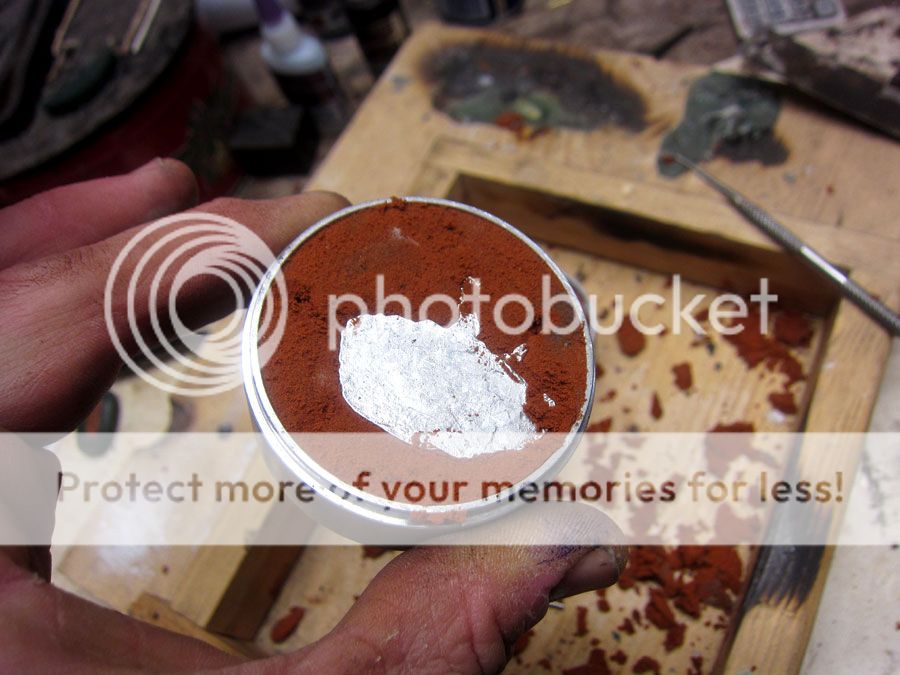

Some more work. Just thought I'd share the basic casting process I've been learning. It is based on Delft clay.. an oil sand that you order as a kit that comes with a little casting frame. The sand is very fine and capable of holding detail better than traditional sand casting. It is capable of doing more than what I'm using it for.. but I'm still learning. The following is using it simply to make a rough spacer out of pewter. The final product will be ground to shape and cleaned up. This is NOT the way to do it if you are wanting to make a more finished piece.
First I packed the sand in part of the frame with a planishing hammer and then I made an impression in it with the horn.

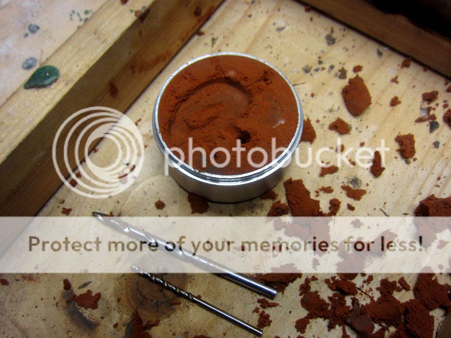

Here is the impression. Like I said.. it's rough. The holes are for pouring and venting to push air out of the space.

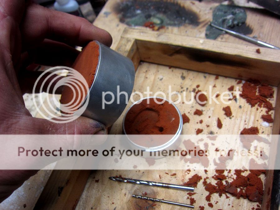

The other part of the frame is packed with sand and then placed on the other half.

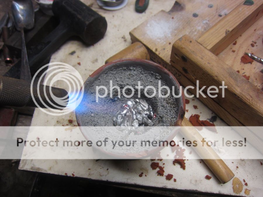

Melting the 'silver pewter' (actually hard silver solder) in a home made flower pot crucible.. made by hard packing castable refractory into the flower pot.

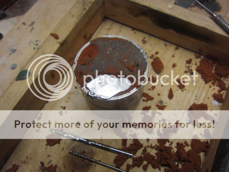

Poured.

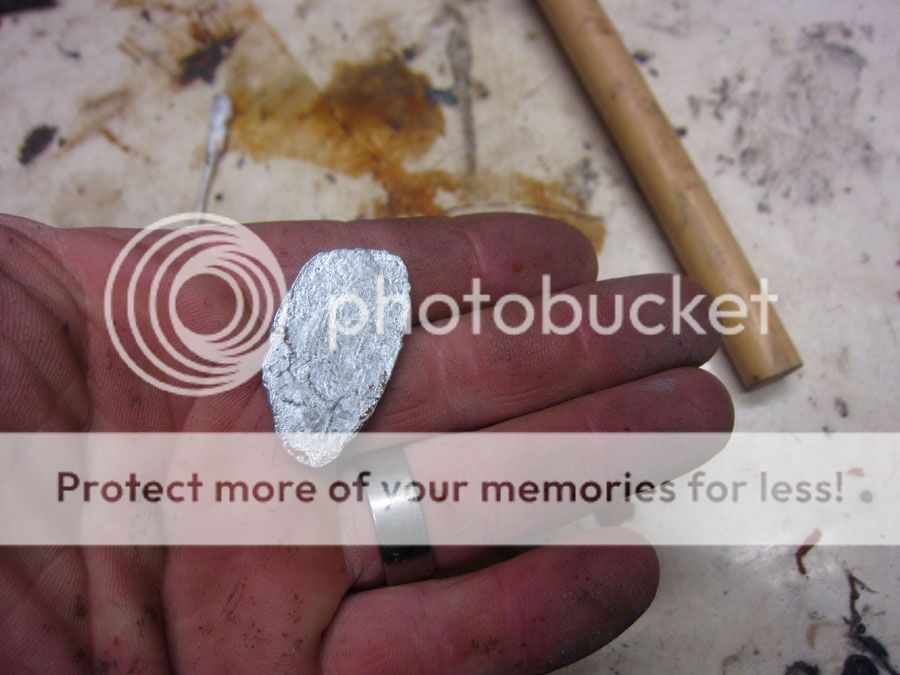

Removed from the sand and the 'sprues' cut off
Here it is in place preparing to 'smoothed' into the rest of the assembly.

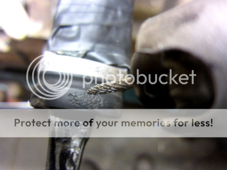

And using a carbide rasp to texture the ebony:
