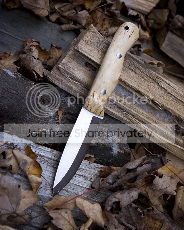

I just finished up the knife last night, and I am EXTREMELY pleased with it.

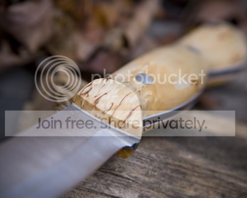

Here it is:

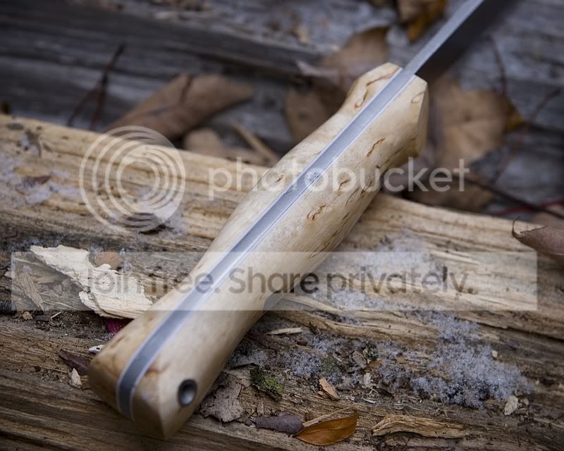

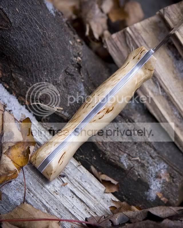

My handle shape:

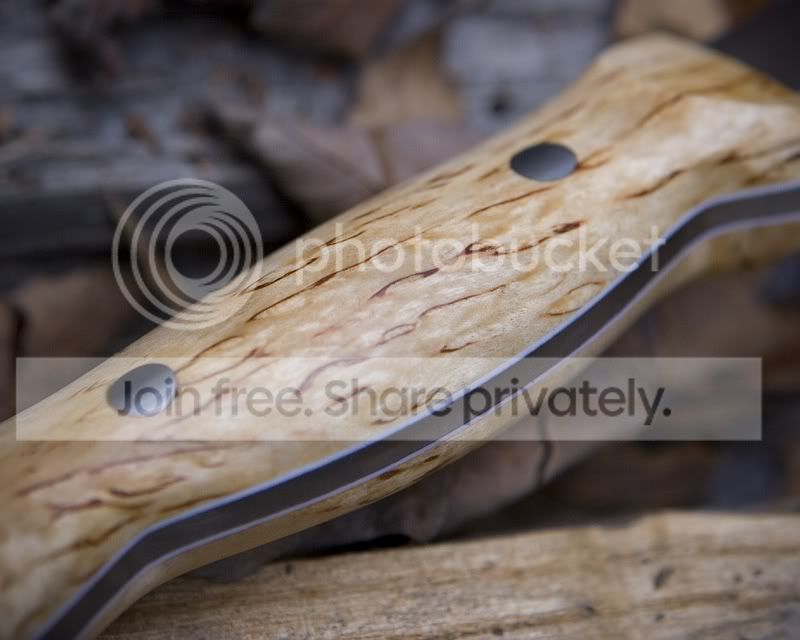

I really love the look in this section:

Everyone has said how awesome it is - I agree. Can I pick nits and see your response?
I wonder if black or Brown liners would have looked better. Thoughts?
Do you think the handle bevels (right near the coil) are to shallow? It looks as if they cut into the portion where your hand would rest. Are they comfy?
That is all I have - I looked at if for a while and wanted to give you some feedback that wasn't all Kudo's - hoping to help perfect your craft - but that is all I have.

No problem at all on the feedback.
In fact, that is how the bevels got there in the first place! Feedback from the excellent folks here.
That is quite funny. I thought about it for 3 days whether to do black or white. I think black would look awesome too. I had not thought about brown.
There is always next time, right? Now that I think about it, my next curly birch one will be done with black because I have them here.
Others that I have done were probably ground a touch closer to blade. You are correct. I wasn't too concerned about it on this one (mine) because I can always re-grind a touch, and re-finish.
With that said, it feels pretty good to me. I tend to put my thumb a touch farther forward, in which I think this one will work out well. However, I have only done mild stuff with this so far. I will do more testing in the next couple days, and see if I need to do anything with mine.
I really, seriously appreciate the feedback. Stuff like this helps me think of stuff I had not thought of. It is the only way to get better.

That is exactly how I wanted my comments taken. One last nit pick - why not grind the blade flat and then run up the tip like a J rather than a slight U in your grind.
If you look at a Muskratman knife or yours - vs. a Kosters - Kosters grinds his straight and then rises with the tip. You and Muskratman grind in a slight smiley face - why?
I hope that makes sense - if not - I will post a diagram.
