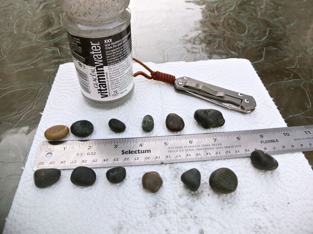

.When I stonewashed, I use ceramic stones from Harbor Freight in a Folgers 1 lb coffee can, just 5-10 min does it.
This might be a stupid request but can you provide more details on the stones you used? Pics? That might sound dumb but are you using something you picked up out of the driveway or some special stone you obtained elsewhere?
Also, in theory couldn't one purchase shorter screws to use during the process from a hardware store so you don't have to worry about your CRK hardware getting dinged up and having to de-burr it?

Volgrad:
Here is a picture of the stones and bottle used. They were all collected at a local beach and are well rounded. A few different "grits" of granite you might say ;). I think they key is the stones need to be heavy enough to leave a mark, but without any super sharp points to deeply gouge the slab-corners etc.
The CRK hardware was not super screwed-up or anything, only the stonewash had just hit the tip-top of the button-head of the screws, so it looked a bit off-balance. "De-burring" might have been too harsh a word. My main reason for stropping the screws was to tone-down the stone wash on the peaks of the screw buttons. If I had the right screws on hand, using shorter screws would be the way to go. The finish on the screws is not really that noticeable anyway, so you might as well leave the CRK screws out of the process if you have that option. The ideal replacement screw would sit flat inside the screw dimple on the slab so the stones can "wash" right up to the edge.
The other advice is time in the dryer. My first intention was to do it by hand like Gull Wing has done, but the result was not anything noticeable. Maybe because I'm using real stones and not the ceramic stones mentioned by Gull Wing, which likely cut the titanium easier. During the dryer process, I checked after 1/2 hour and the finish was not quite there. 1 hours seemed perfect. You need to make sure the bottle is well wrapped in the towel, so each of the tumbles has a soft landing. I imagine if you just threw the bottle in the dryer, without any padding, it would have a far more abrasive effect (YIKES.....where did my knife go? :eek:).

Thanks for the pic and additional details. I am still thinking of trying it with a Sage2.
