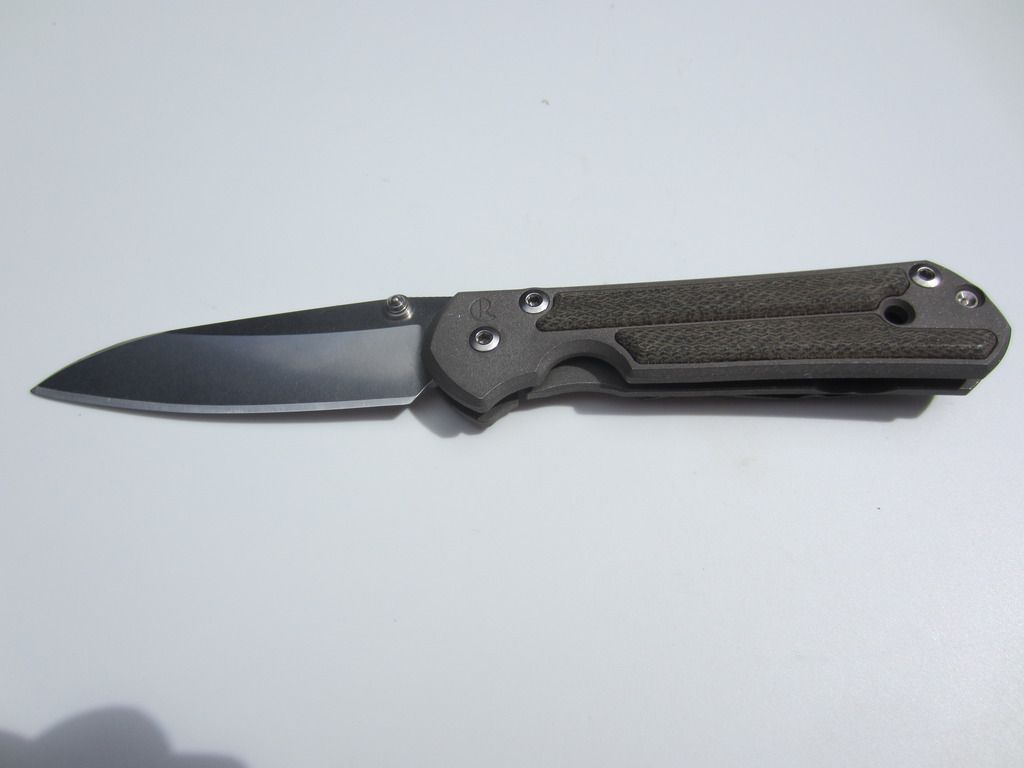

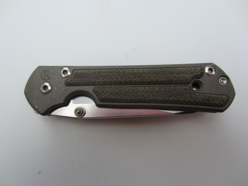

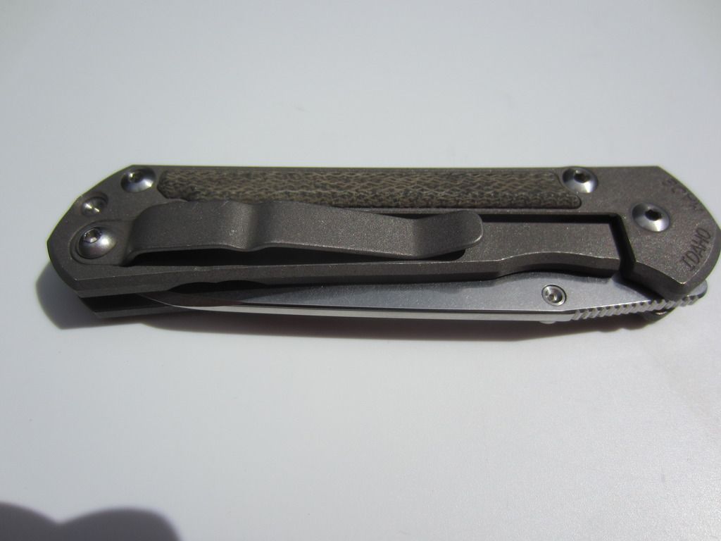

I stonewashed my Small Micarta Insingo a while back (and posted). No harm done (used water and ceramic medium), however there was not a huge change in appearance, the Micarta of course, as mentioned , got in the way. I took the slabs apart, and protected contact surfaces.

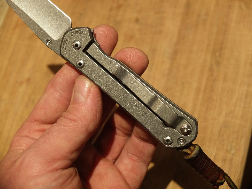

OK, mine is done as well. I started with "lava" rocks for a bit more than an hour then went on to the marbles to try for a burnished effect. I really like how it turned out. Note: I ended up using brass flat head 4-40 screws in place of the stainless button heads just as Kidcongo predicted.
Agree, this looks amazing. Very well done. Funny kidcongo pointed that out on the screw heads. I was thinking the same thing when I saw the first pic but he beat me to it.
Just about any screw left in position will cause ghosting. You can still clearly see ghosting in Kidcongos pics and he used the standard slightly domed crews from CRK. A "ghetto tumble" can get great results but the pieces should really still be preped properly by masking and seperated from eachother during the tumbling process. :)

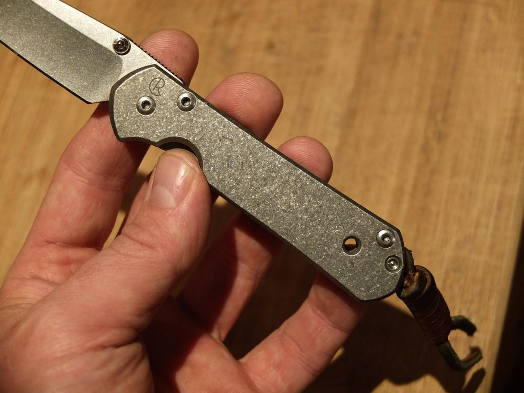

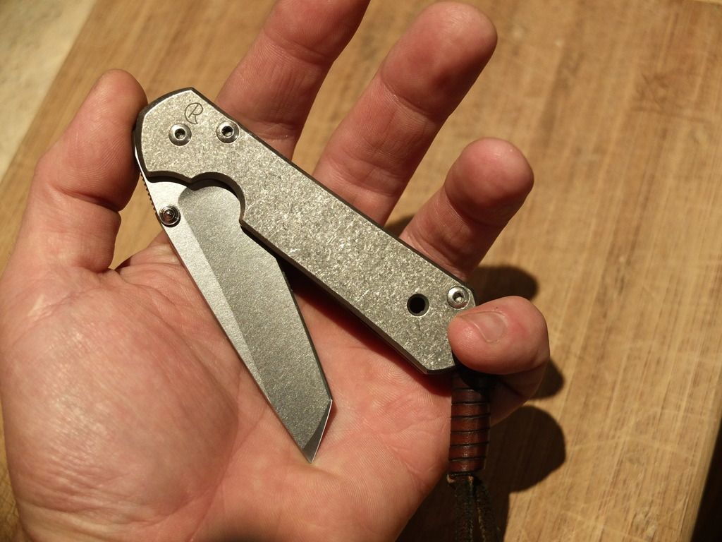

So to update. I found a solution to the problem of "ghosting" as flagged by Haze. I did an additional 10 minutes of tumble, with one of each of the three screws removed at a a time (30 minutes total). This seems to have been a workable solution (keeping in mind I was tumbling the knife assembled without a blade or clip installed). The results were good, with most if not all of the "ghost" circles removed around the button screws. Remember to wedge something under the lockbar to both keep the lockbar even with the surface of the slab, but also prevent the detent ball from being banged into the opposite slab by your stones.
The photo was taken below a halogen light, that accentuates the sparkle. The sparkle is not so dramatic in soft light, and the scratches do oxidize and dull a little bit as well once you start using the thing. Still i suppose it's "Ghetto", but at least it's "Ghetto bling". Thanks to Haze for pushing me on to learn something new. :)
