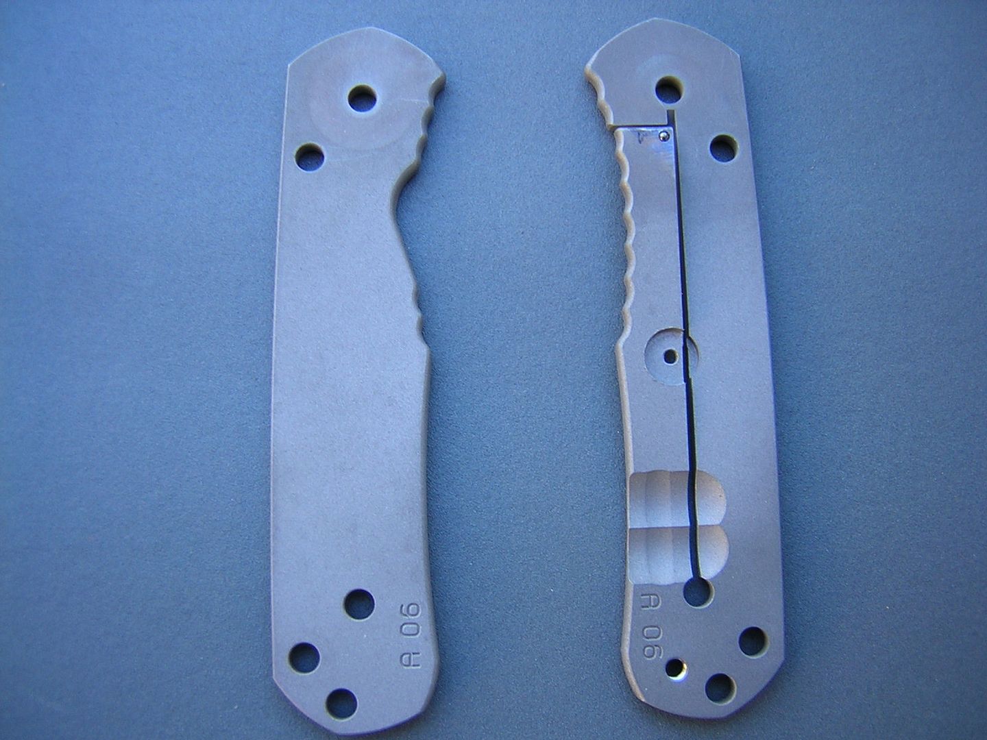

Thank you Kiddo for directing me here, it looks freaking amazing, I can't wait to try it on one of my knives, I have a 25 that it's sitting there all pretty and it might be a candidate for this treatment. My TiLock is supposed to be stonewashed if I'm not mistaken but it doesn't look as good as your tanto, I love it man. Good job! And thanks again, you're one of the few guys that causes me to learn something new about knives with your posts, I like it that you have no fear to try new things but with caution and care, just my kind of thing. By the way, have a happy new year[emoji39]
You don't have to do the knife assembled. Do one half at a time. The locking side use a screw from the hardware store with washer(washers) and nut to protect the ball.
That is how I do it.
KIDCONGO:
Ok here is the setup. Bolt, Nut, Washers.(the bolt is a Torx head#4@42, for a larger hole, get a larger bolt)
You get the nut tight, the lock lug is moved out of the way of contact from the media(or sandblasting), the PB washer area is also covered. Safe!
I sandblast with this setup as well.
Beautiful!
OOH! ME! ME! I HAVE A QUESTION!
I lost it when you said "I put the pivot bushing in it".....
Didn't the rocks beat the hell out of that precision-machined bushing??!!??
