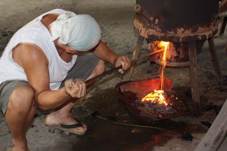

Ok as promised Master Chen has allowed me to show you his incredible process for making swords and Knives ( for the American Market) Many master Sword Smiths in Asia and points east will not share these secrets to anyone but their apprentice. Since Master Chen is self taught he has no master. Ala Pen and Teller he can show us how his magic is performed. However his craft is not slight of hand...
So lets begin..
First Master Chen begins with Iron Sand that he mines himself out of the indegeonous Rock Strata from where he lives...
Into the smelter it goes...this process fires the sand to extreme temp to remove the metal from the sand..

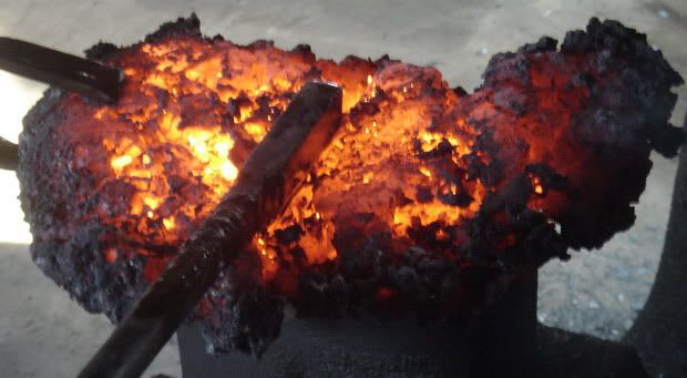

as the smelting process begins the higher carbon steels will stay to the bottom of the smelter. The Slag lower carbon material will float near the top..
in this picture the high carbon steel is being extracted painstakingly from the smelter...
From over ( and maybe Bobby you could jump in here with actual kilo weight) but I believe that over 240lbs of sand a 15lb billit of appropriate usable steel is extracted. Note the molten steel is carefully carried...to...
a rapid quench in cold water...this cools the steel very fast and makes it very brittle...
Thus making it easy to further remove impurities and low carbon impurities..In this picture the billit is now smashed with a sledge hammer and the two colors of steels...dark black and Gray are seperated. Again if Bobby could jump in and say which is which I would appreciate...

the iron sand is removed from the river. i was there when it was delivered. it was wet. i asked mr chen are you going to pay for the water that is mixed with the sand too? he then went into talking down the price to not pay for the water. the iron sand comes from a river in china. i do not know which river. mr chen pays someone with big electro magnet to sorta dredge the river for the iron sand. the magnet will pick up the iron and let the rest stay behind. or that is the plan.
mr chen starts with 65 kgs of charcoal and 30 kgs of iron sand. i know Ren got the 5 minute tour and missed some parts. but i am impressed that he got as much as he did. it only took me a year to get as close as he is now.
if you notice the clay packed in the cracks of the smelter this is to stop any air or charcoal from coming out. the plug in the bottom is also clay. in that one picture you can see mr chen knocking out the clay plug to let the impurities drain out. most people think this is the steel but its the junk being separated.
as for the colors of the bloom ( the steel left after smelting ) it is beat with a hammer and each time it loses more impurities. then it is beat again and again. mr chen will heat it and beat it and each time it will lose more impurities.

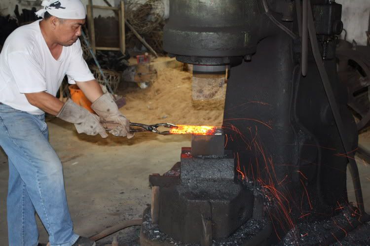

To Continue where I left off. After the billet is cooled and smashed. Master chen begins to seperate the high carbon Steel from the Low carbon Steel. As you can see there is very little left of the original Iron Sand that went into the Smelter. We are getting to the good stuff that makes Master Chens blades.

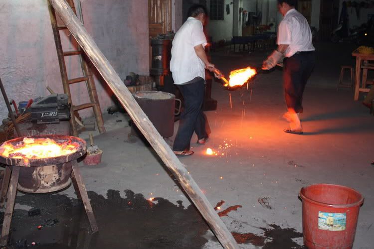

this small billet is then thrown back into the fires of hell and reheated and folded and folded and folded..
and recooled and re heated and smashed and more impurities painstakingly removed from the forming Damascus..
you can see by this picture again that after reheating and folding and cooling and reheating again. only the Highest of pure carbon steel maintains the high metallic sheen where the lower carbon steels maintain the grayish color. Master Chen separates these two steels one for use now one for use later.

i think i can answer this. he breaks it and separates it to get the high carbon and the low carbon.the high carbon will have a silver sheen to it. the low carbon will be a darker color. master chen chooses these by hand and only his trained eye knows the difference. i have watched him do this and they all look the same to me. he will pick one up and say look at this piece.
when he picks these silver pieces up he will do a little dance of delight. that is the best of the best.
i am sorry to say they all look the same to me unless he points it out.
the high carbon will be made into a billet and go into the outer part of the sword and the darker part will be made into a billet go into the center. this gives 2 different harnesses of steel. this will be important later in the thread.

To continue...Sorry for the delay in pics but I have worked about 40 hours in 3 days and am pretty whipped...buuuut...

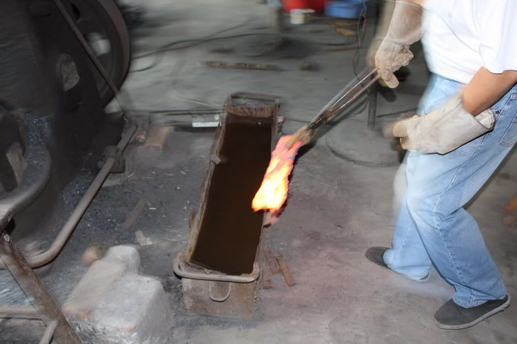

The steel as it is seperated is then reheated in Charcoal fire...
once the billet is heated again it is hammered and folded repeatedly
re heat treat and cooling is continuous untill Master chen is satisfied that the quality of the damascus steel is the finest..

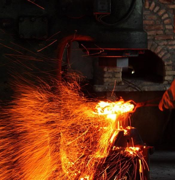

the times master chen does this process is almost ridiculous...note in this picture the size of the billet he is now working with and smashing further to remove high and low carbon elements. Again as Bobby stated earlier only a master sword smiths trained eye can determine the high carbon from the low carbon steel. The billet grows smaller and stronger..
