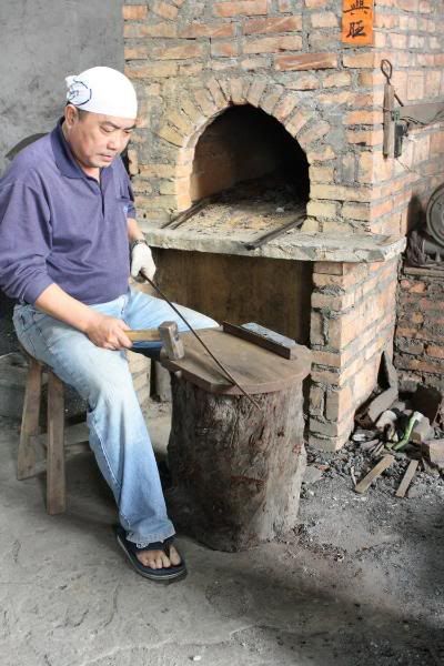

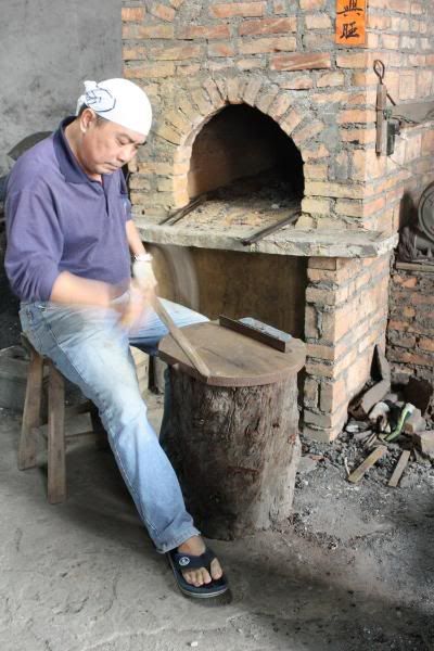

Here Master Chen will hammer the blade straight and shape the tip and blade
he is sitting beside the oven and he will heat the blade a little then hammer it.

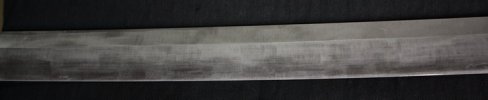

in this photo you can see the hamon clearly now. he will polish each square inch of the sword searching for patterns in the steel. since the blade has 1.3 mil layers he can polish through each layer and expose things like clouds and dragons. mountains and rivers.
the more patterns he can find in the steel the higher the value of the sword will bring when sold.
so master chen will sit for days and polish a sword like this. he will work for 3 to 5 hours and rest some. then do it again. master chen works about 16 hours a day at this
