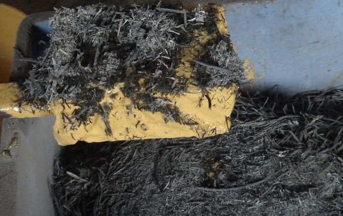

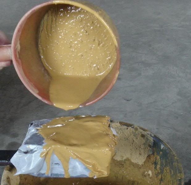

Finally master chen has the steel he is looking for...
layers of High carbon steel
from this Master Chen then forms another billet and covers with clay for heat treating..
and then covered with Grass to add more carbon during the heat treat...from the organic material in the grass.
back into the fire it goes...
thats all for now...Bobby if you would not mind jumping in here and explain more about the grass. I found that fascinating. Also I will be punching out for the weekend....Ill post more on Monday..:thumbup:
the clay coating will alow the billet to be heated evenly. slowly coming up to temp. that is the reason for the clay.
the reason for the grass mr chen says is to keep the carbon. so adding this grass here keeps the carbon level up to the point he wants it.
if all is right when he finishes he will have 1.6 to 1.8 carbon content. if my numbers are right.

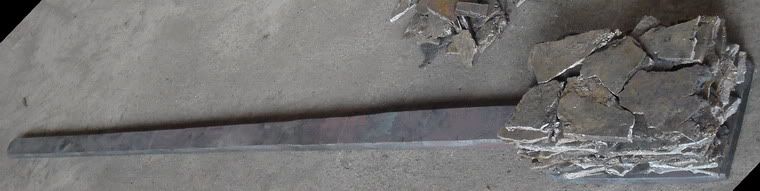

this is the dreaded black pieces of the tamahagane. it is low carbon but we will use it.
the high carbon is used for the outer layer of the sword and the low carbon is used for the core.
this is the low carbon. it will be hammered and folded into a long billet to be inserted in the center of the final billet.
