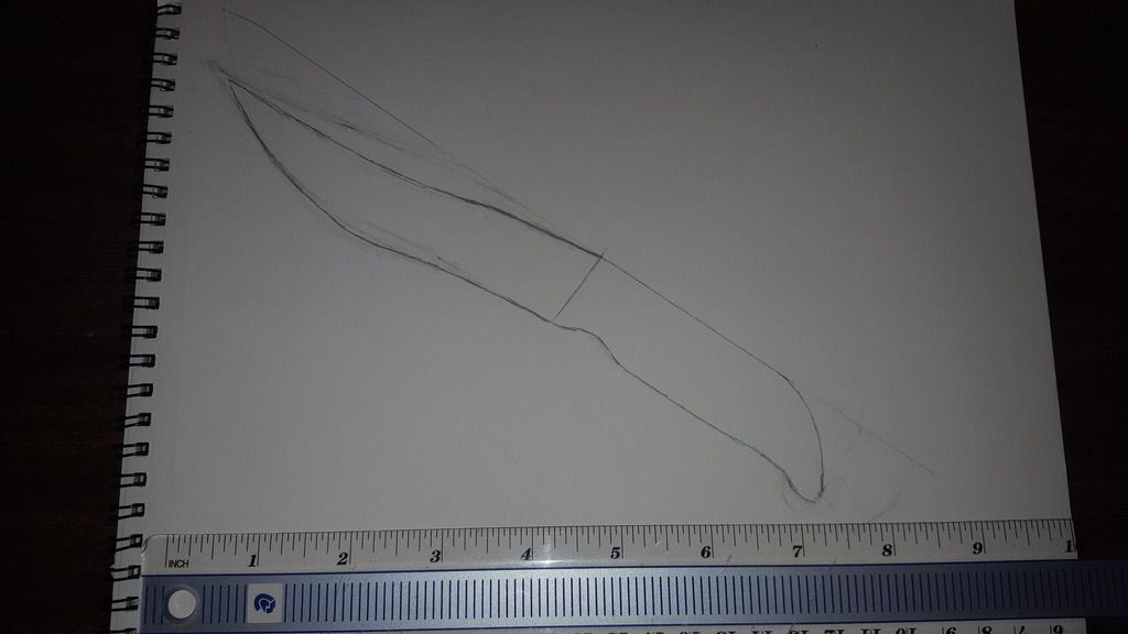

Well.... I did make up some sketches...
They're for more of a defense/tac/holdout knife than the sort of utility/slicer I'd use more. I was just daydreaming about dagger/kerambit hybrids oneday - I'll scan the page and post them.
You're not the only one. I've got an idea for a defensive blade that I either want to make or have made, but I don't have the tools to make it, or the money to commission it. One day I will have the means or money though.
Well, the internet is a magical place. A lot of it seems to be forbidden magic, but it's still magical. This is the design I sketched out. I've looked around and not seen anything quite like it.
Looks sort of Uncle Bill Especial except for the handle. Very similar to the Ultimate Fighter too.
Oh wait, not I see the ruler. Now we're similar to the R series, a bit like the R6 except yours is more pointy. One of the others might be closer.
It's actually based off of my Chassepot bayonet. I like the shape, but the bayonet is a bit large for EDC, so I designed a knife version.
