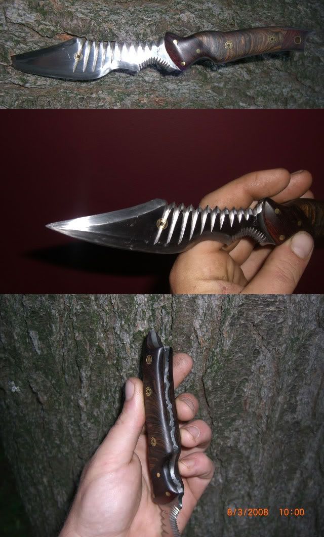

one of the "knifes" in question
WTF :eek:.....so, what happens if you need to apply thumb pressure on the blade? You poke the hell out of your finger?:confused:. I do like the handle work, but the blade shape is really out of the ordinary.
Creative work, but I know for a fact that I would not (and several other people would not) pay over $75.00 for that, and that's probably barely the cost of materials and not including time and effort of making it.
Great potential for future knives, but these first models need to stay with the owner until something more "useful" is put out. Just my opinion, J.

It looks like he couldn't get the bevel quite right on the blade and tried to hide it by attacking everything with a file. Not that my knives have gotten good yet but that one would have been chalked up to 'filing practice' and thrown away... not had good wood and mosiac pins wasted on it.
...that, and I'm pretty sure if you beared down on the blade (assuming you lived on mars where that knife could see EDC use) it would snap pretty easily at the narrow point before the handle.
Wow. and I kept skipping over this thread. Stuff like the the knife posted is interesting and fun to play with, you can even learn from making it. But, even with flawless execution and the best of materials it would only sell to a very narrow market.

I think most people interested in this style of knife don't really care about useful.
I do agree that his designs aren't going to be popular amongst a large group of collectors and that the narrow group who will want that style will want near perfect execution.
