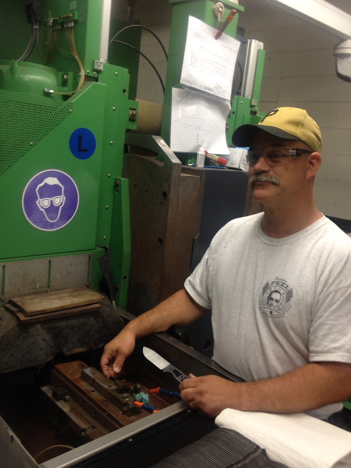

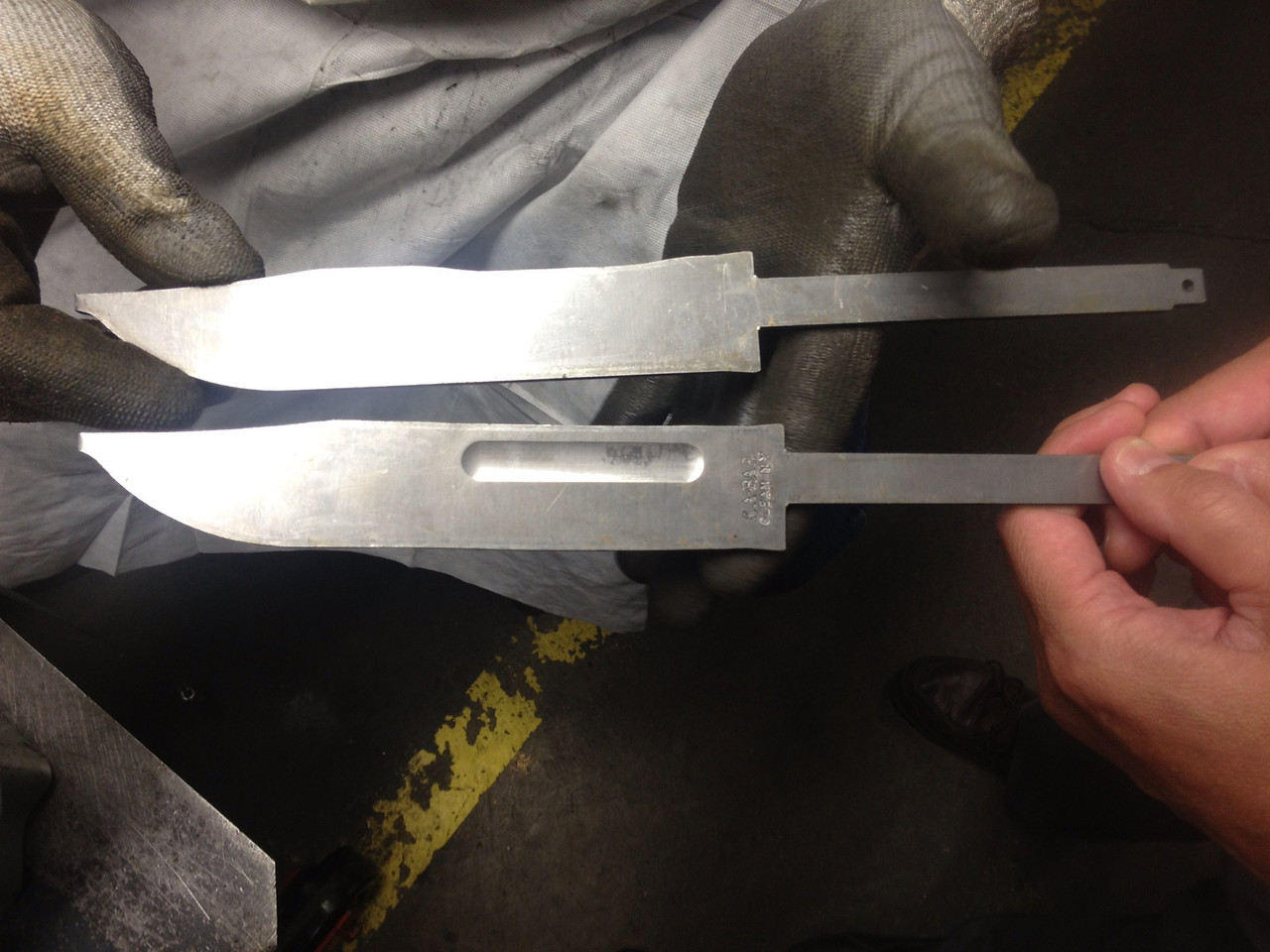

The guy at the top holding th two 1217 USMC Fighting Knives is ROb....He got HIS first KA-BAR the day he graduated Marine boot camp thirty years ago and that blade still lives in his truck.....He spent 8 years in the Corps...... He is a pressman and the press he is using to cold forge thee "blood grooves" exerts 110 tons of pressure..... Note the odd shape of the blade before the hit.... The press moves the metal so you get a finished blade shape....... Tha blanking press by the way, only needs to exert 30 tons of pressure to make the initial blank......

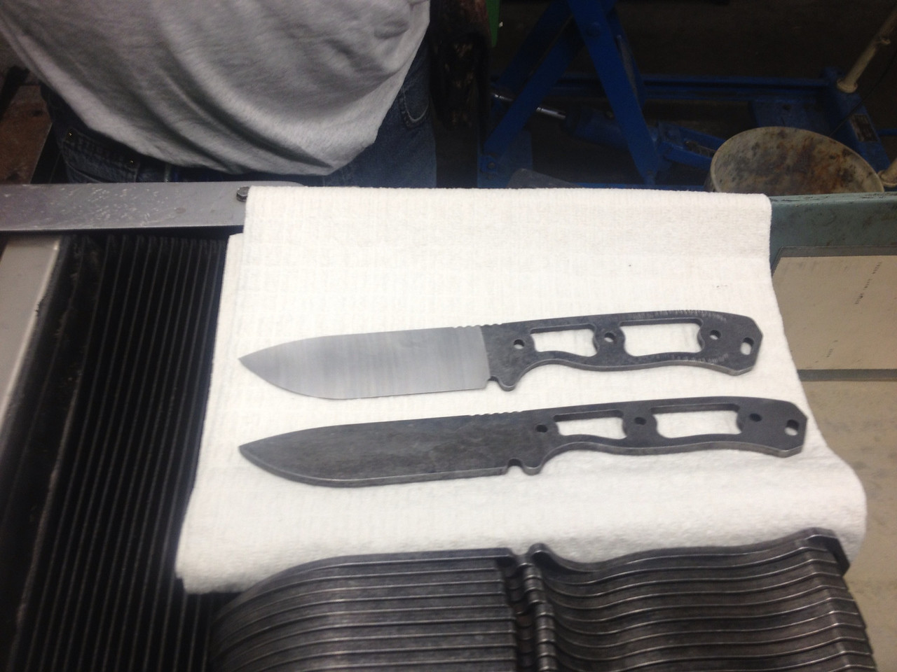

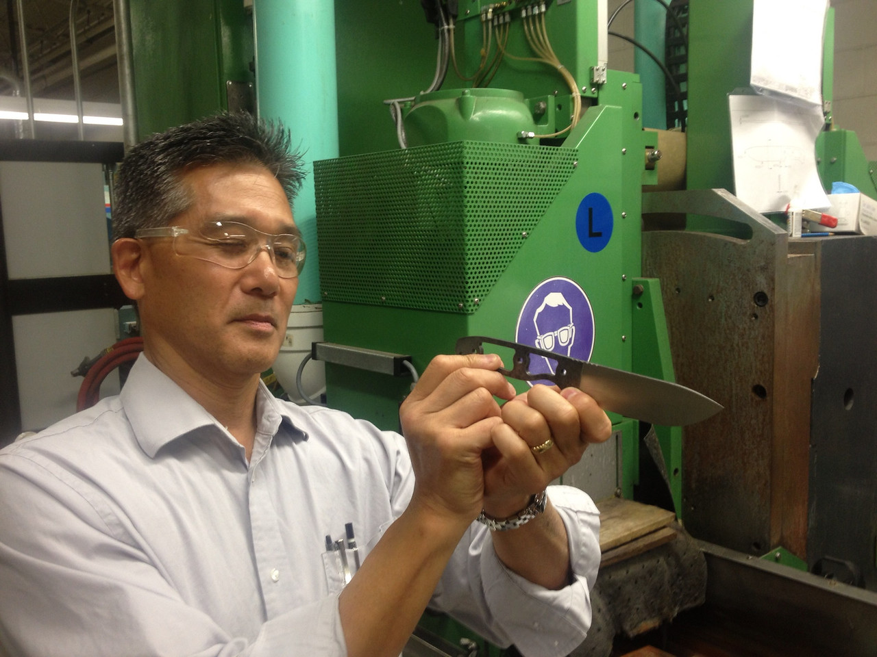

The next shots are of the Sixteens being ground by Joe Crowley who seems to be as nice as his wide smile......Note Tooj's critical eyeballs......The blades looked fine BTW........Joe has been 'at it' at CUTCO for a long time......Things get a little confused as to sequence at this point but, we see Mike one of the two senior Honers ( Miss Connie being the other) putting that great KA-BAR edge on......There is Tooj and Joe Neal(the guy who ramrods the KA-BAR manufacturing group) and more shots of the various machinery it takes to put out the worlds best...... In case there is ANY doubt in your mind the shot of El Tooj and Joe Neal WAS posed and neither of them is likely to get jobs as actors anytime soon....LOL.....

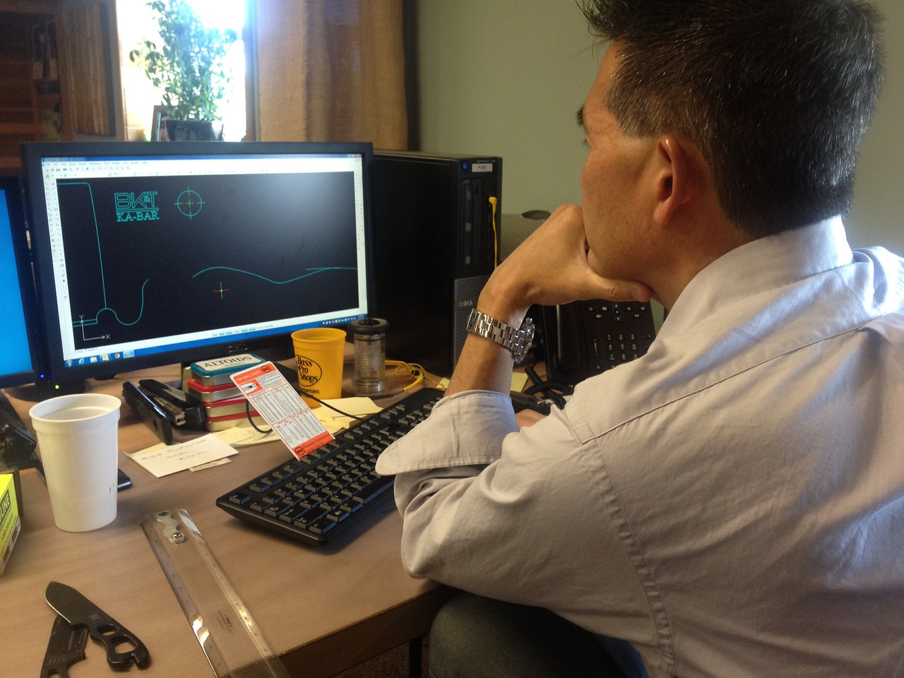

Also note Tooj at the computer working on translating my ideas for a new blade into compusprechenzie(that is compuignoramus for Solid Works)......
Thanks for that, I figured it was two seperate operations but it didn't occur to me that the first blanking would require the odd shape to allow for displacement... makes sense now that I see it. :thumbup:
