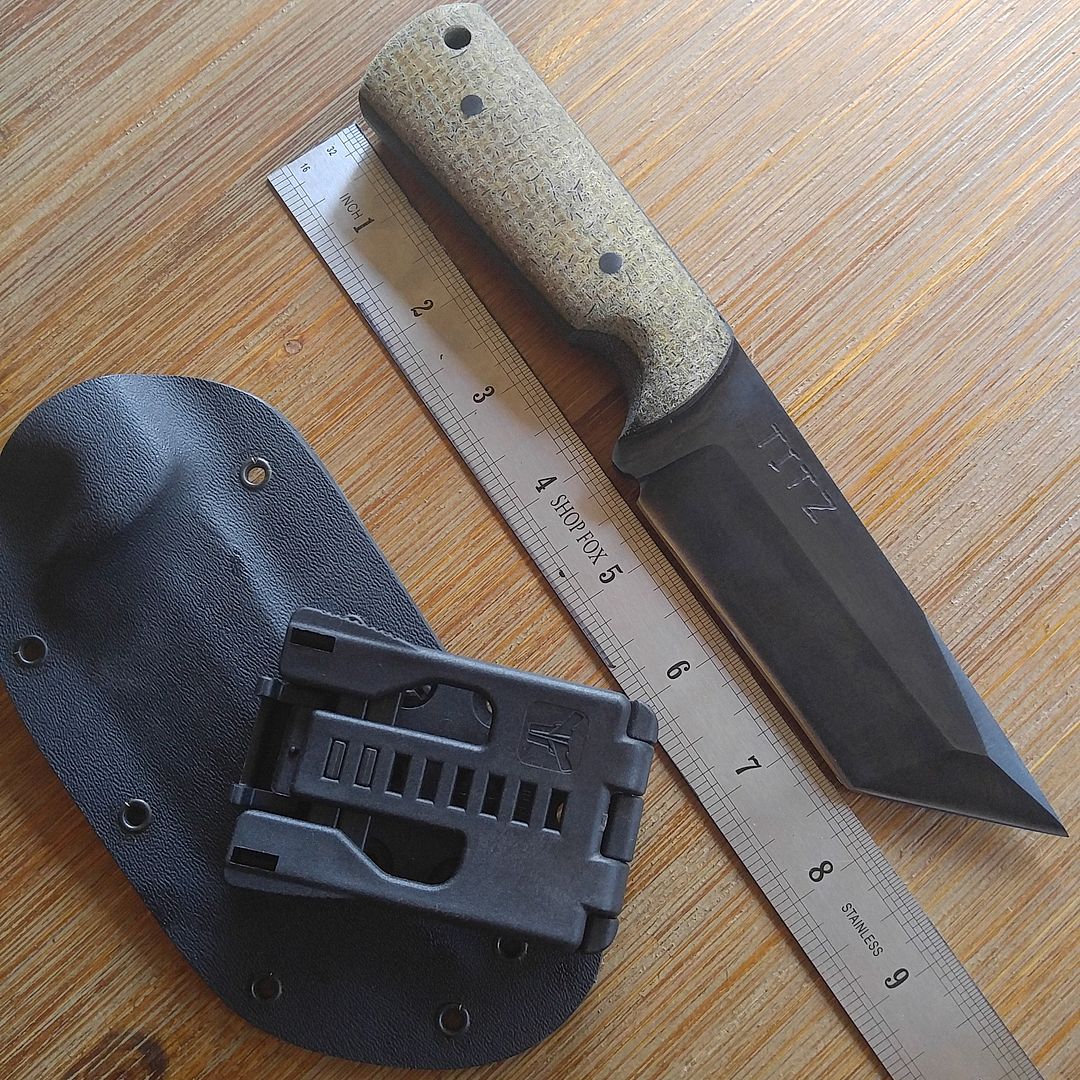

S7 is another favorite of mine. I usually run it at 58 but have done 61 on request.
I would love a large Bowie type knife made of s7. I just think for a shorter blade a2 would hold its edge quite a lot better wouldn't it. Also I just saw your last post and I'm not surprised. You make your knives the way you like your knives strictly business and tough.

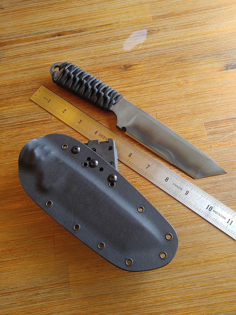

S7 stuff...
This is what S7 can do when thru hardened to 58 Rc with a top HT.
