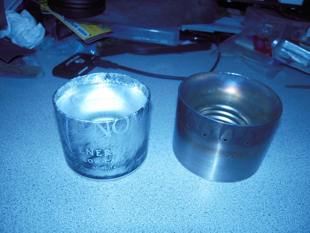

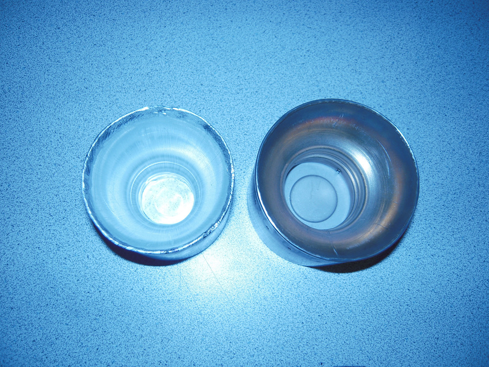

Stainless steel water bottle works, but for an alcohol stove aluminum would be better. Here is mine (on the right) that I made from a stainless steel water bottle.
Aluminum transfers heat better, so the whole thing heats up quicker, which is what vaporizes the alcohol and causes the jets on the sides.
It does however work, so if you want a stainless one, by all means, go for it. Mine is in my kit, and nests inside my cookset, which nests inside my woodgas stove.

Did you crimp/fold the edge on that stove in the pic?
No crimping. I now use 3 pop rivets with a little high temp silicone.
It takes me about 20 minutes to make a stove start to finish this way. They are plenty strong:)
