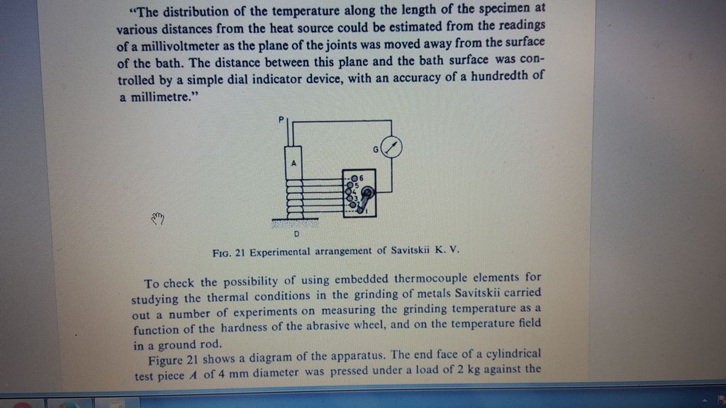

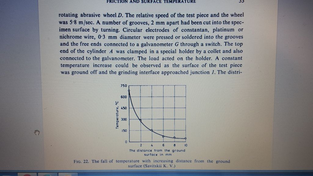

Here is another actual test done using thermocouples. It is basically a steel part ground with a grinder spinning at 19ft/second. A load of 2kg was applied. Unlike a slack belt, a grindng wheel has no give. So a 2kg load on a grinding wheel is considerably more force than what someone applies to a slack belt. Regardless, a good example. The maximum temp attained was 720 degrees Celsius. This is a good argument for being careful when using a belt sander. 720 degrees is a far cry from the 500 degrees above melting point attained by Landes.
So we have a guy on BF that did a test with a belt sander and did not exceed 300 degrees celsius. Then we have another test with a grinding wheel that reaches a temp of 720 degrees. My conclusion(to myself) as of now is that dry hand sanding is safe and will not cause temps anywhere near half the temp listed by Landes on a knife. I state a knife because Razors were mentioned and are very thin steel. I could see the thin steel of a razor getting hot enough to ruin an edge on a belt sander. But by hand? I don't think even a razor could sustain thermal damage by hand.
