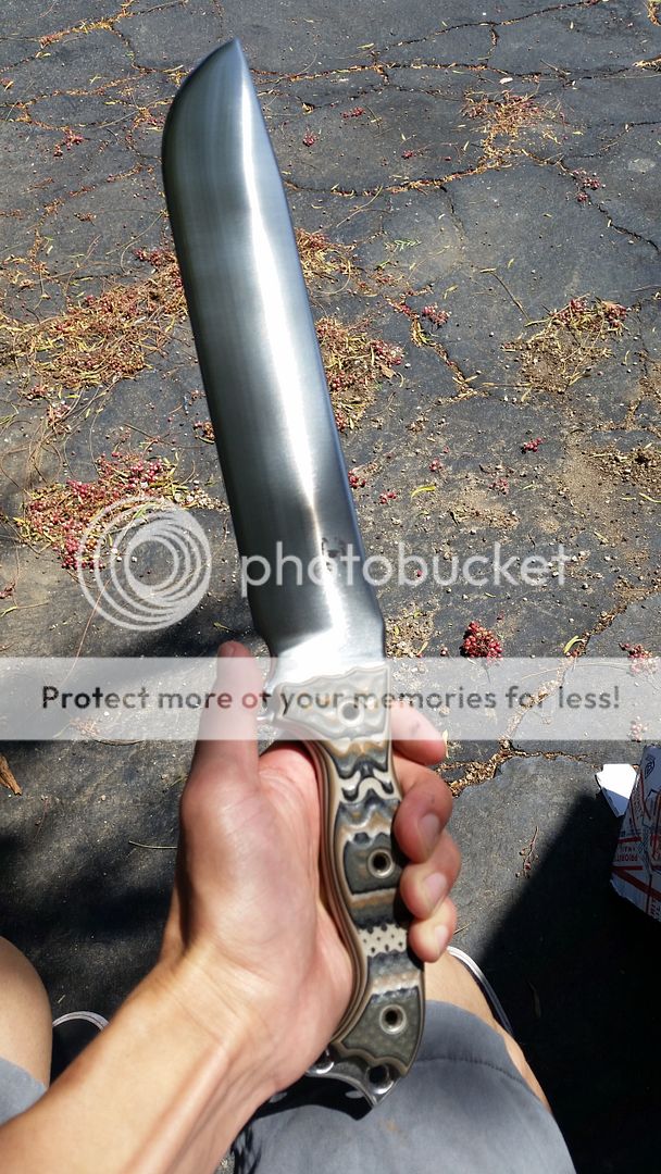

If you're able to, could you post a picture of the tip, showing the damage? Just for my, and I'm sure others, curiosity.
Can only see a beautiful NMFBM from this pic.
Either way, Jerry clearly has you covered.
But really, that's a damn nice looking NMFBM.
I have tried before, my phone camera (only camera I own) will not focus on the tip.
if there are tips (no pun intended) to taking picture of the tip I'd gladly give it a try.
this was a knife I planned on keeping a safe queen, so a broken tip sort of defeats the purpose.
