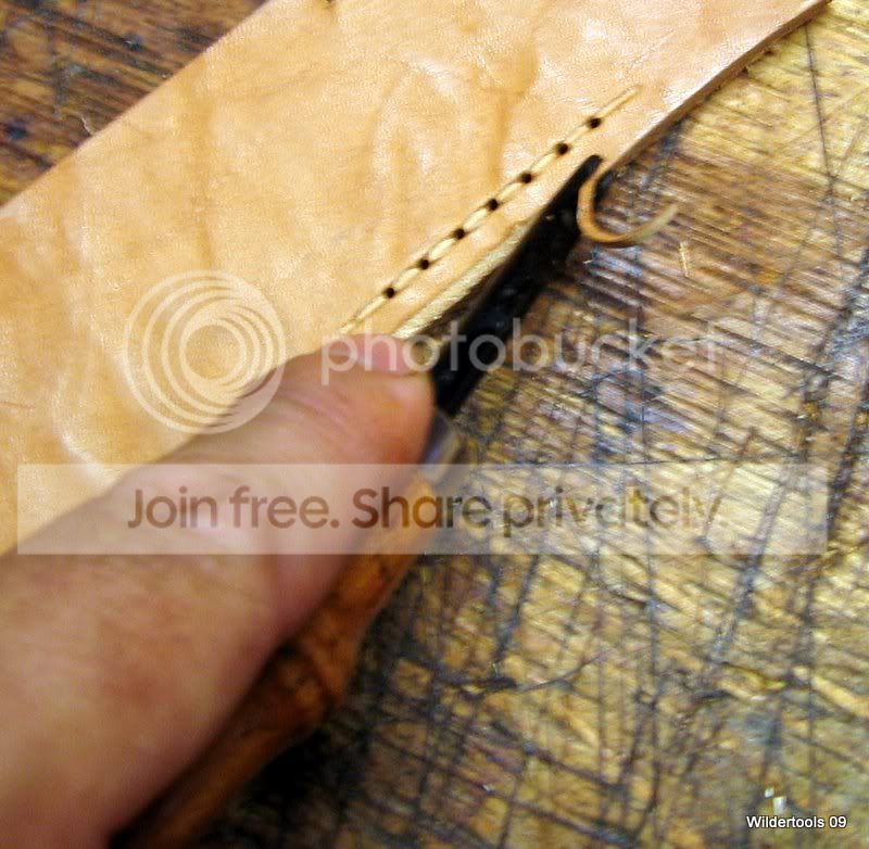

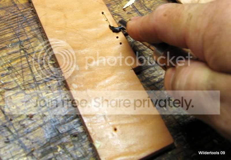

I consider my style to be rough and simple. I use basic tools that help everything line up. Here is a quick overview.. (I'll have to resort to using a scrap piece of leather as I don't have any sheaths on the go right now.)

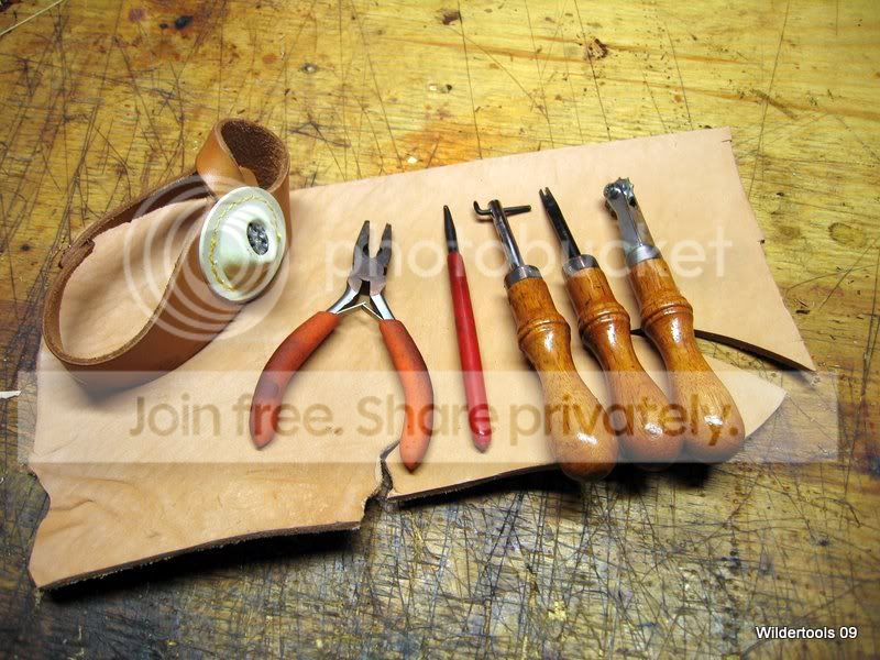

1. My tools from left to right: Stitching palm, pliers, freehand stitch groover, guided stitch groover, edge bevel and an overstitch wheel.

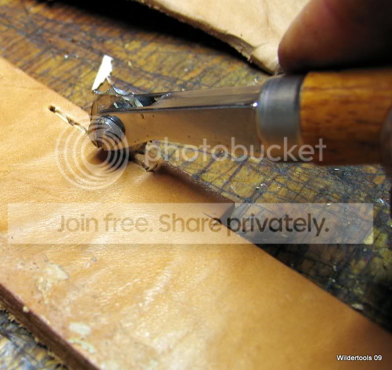

2. Use the stitch groover to set your lines and recess the thread in the leather for protection.

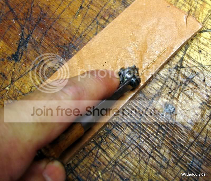

3. Roll your overstitcher to set spacing.

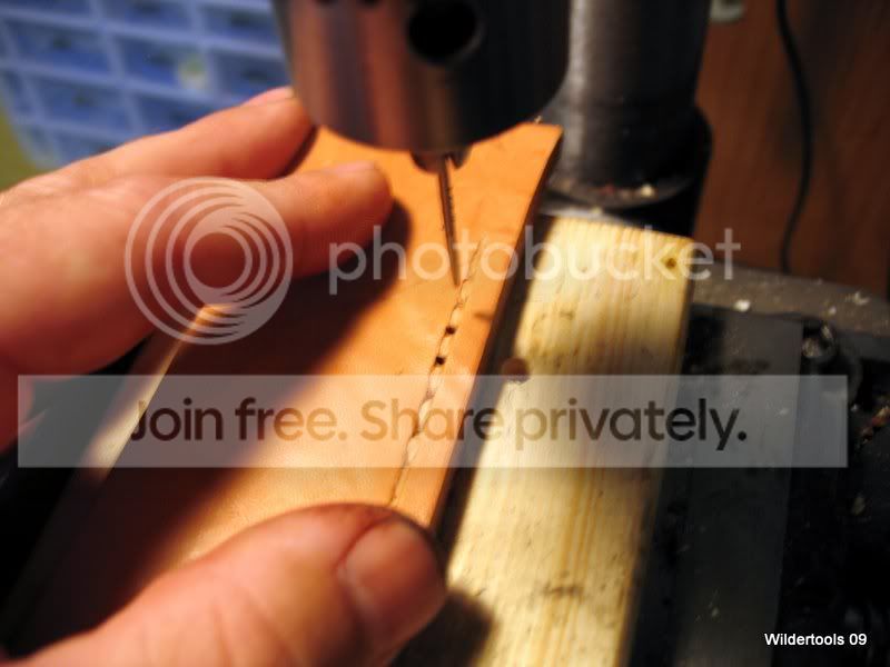

4. Useing a drillpress is much easier than punching through thick leather by hand. I put a polished pin in the chuck that is slightly bigger than my sewing needle.
5. Use the beveler to make the edge nice. (doesn't matter when you do this step)

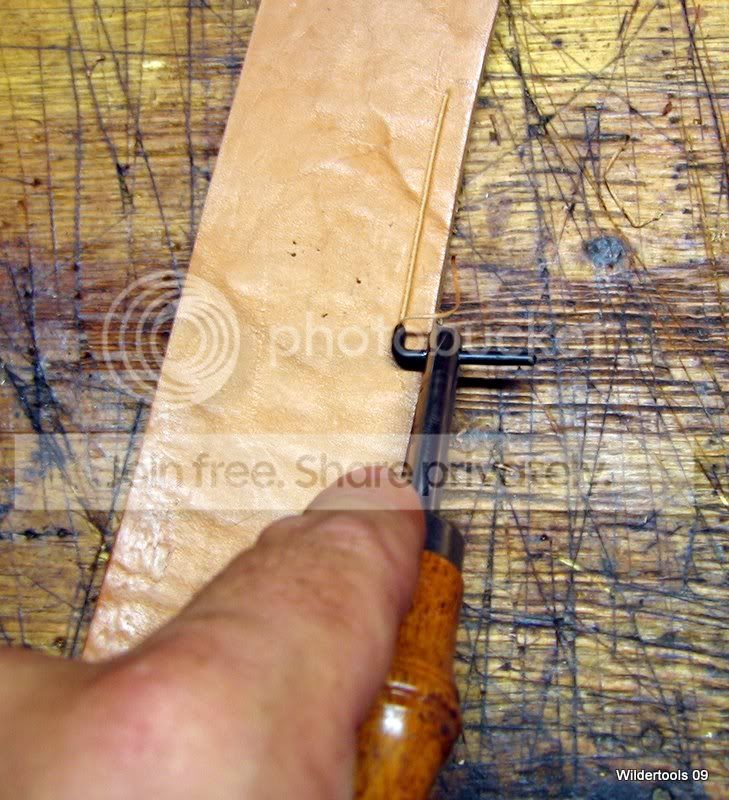

6. On the opposite side, use the stitch groover to "connect the dots".
7. Run the overstitcher across it to line everything up for stitching.

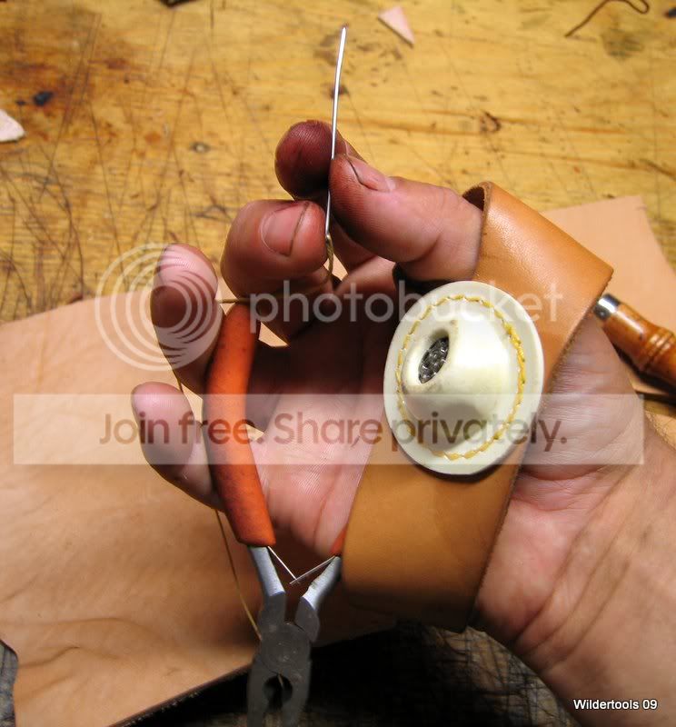

8. My stitching hand is packed full of goodies... the stich palm for pushing, the pliers for pulling and of course, the needle and thread. (sorry about the ugly stained fingers... lol)

Essentially it is a thimble to push the needle through the thick leather.

I do a lot of the things the same except I use a divider set at the stitch spacing to mark the needle holes and I use a small precision screwdriver that I sharpened up to a fine awl point and hammer it through the leather to make the holes. I made myself a leather thimble type thing that is hardened by soaking with a bit of water and heated up.
I use a variation of the 2 needle technique but I only use one needle. I start at the tip and work up one side and back down, over stitch back up the same side one or two holes, thread the needle with the remaining half and do the same up the other side.

How does the drill press hole punch approach work with multiple layers of leather (front, back and welts) all at once? Do the holes stay lined up well and not shift much from front to back? What do you do so the leather doesn't get soiled by the press? (My press is usually a mess!)

I clamp a clean piece of 2x4 in my drill vice to use as a backing. If your pin (some use a finish nail) is straight and sharp, it should go through with no problems. I only have enough pin sticking out to get through the leather and set the drill depth so the chuck doesn't hit the top surface by mistake. I have sewn 4 layers of 13oz leather (about 1" thick) without much wander. You will get it from time to time so drill your holes from the top piece so the good side is up.
I have also predrilled holes prior to assembly when needed. The overstitcher assures proper spacing.... but its risky.
