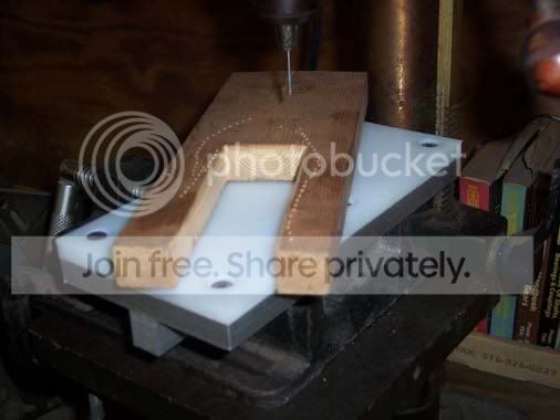

This is a MAJOR weak point of mine right now. Do you guys true up edges on a belt? I've been trying to just cut them straight and it isn't working for me. I also need to get a groover. I'm freehanding everything and it looks like crap.
okzj: Yes, I true up the edges on a belt (sharp one). Then I go to a duller, finer grit one to burnish (burn) the edges....because I don't have a proper burnisher yet and I can't use a fork to do that!
I've been doing the same method as Rick and, with my sheaths, I often go through 4-6 layers of leather and wood(at times). I've noticed that the moment the needle actually hits the leather surface determines if it will wander. If the center of the needle is not directly over the center of the hole, the needle will bend slightly to position itself in the marked depression and therefore bore a new hole canted to the opposite side. If I'm off just a fraction to the right, the exit hole will be slightly off to the left of the intended target.
I just completed a wooden sheath consisting of two 1/4" layers of very hard bubinga, a full leather welt and two additional layers of leather that line the inside. My first 10 or 12 stitches were great and I think I became over confident. After a series of holes gone askew, two quite noticeably, I had learned my lesson. From that point on I took my sweet time and made sure the positioning was perfect before plunging through the layers. Not a problem from then on.

A few tips on using drill presses for this work.First, I use drill bits and sharpen the shanks then chuck them upside down and punch while the press is running.This allows me to size my holes to match various size needles whether I am stitching or lacing.I also made a table for my press using aluminum and UHMW which makes a nice slick sliding surface.I also use cut pieces of 1"x 4" with a notch to accommodate the belt loops.This allows the sheaths to sit much flatter.Be sure to run your press on the slowest speed.
Like said above, I use multiple size bits for threads and laces,typically 1/16" for most threads, 3/32" and 1/8" for lacing 3/32" lace, and 1/8" and 5/32" for 1/8" lace.

Great idea about cutting out a notch in a 1 x 4! :thumbup:
My stitching was coming out lousy because the work wasn't laying flat when drilling the holes.
-Thanks
Great points about making a jig for your stuff to sit in when drilling. I do this with my flatter pieces. I need to make some recessed jibs for my bushcrafter sheaths.
The lesson here kids - is that a multiple piece sheath is easier to get flat (and thus make on a drill press) than a one piece folded sheath.

Just thought I'd mention here that I too was curious if would be ok to use the drill press like an arbor press to push the needle ( bottom of drill bit sharpened to a point) through without having the press running.
End result- Pushed half way through and got stuck. I had to pull so hard to get the sheath off my hands bounced off the table and back up to the needle piercing through my finger beside the nail.

It would work if you made the cross section the same as a hand stitching awl... shallow diamond with spear point... long points 45deg from stitch line. It helps to have a foot over the leather so running the press handle up catches the leather on the foot instead of having to hold it down by hand. Also helps to bees wax the stitching thread when doing that.
