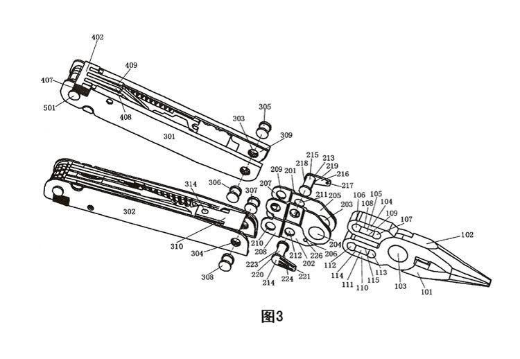

However, I was able to view your patent drawings, and I am very impressed!
The selective 1:1 leverage or compound leverage mechanism is very clever! Have you built any sample prototypes yet, to test the principle?
~Bob

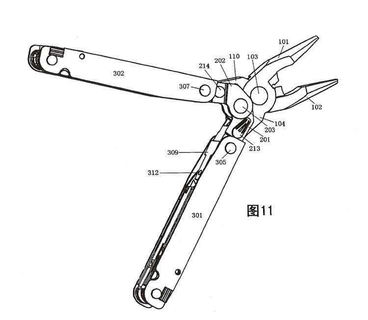

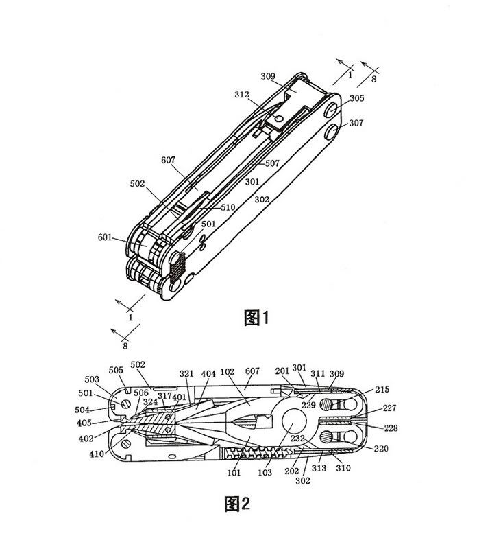

It was quite a chore to get my computer to view the Chinese patent TIFF files though. For those of you who didn't here's a summary:
zhasl's patent is 32 pages long. The first 21 pages are Chinese text. (and I have no idea what it says.) There are then 11 pages of drawings and exploded views, which take some study to understand. Here are three of the pages:
Above, page 22 shows the tool closed up. I think I'm seeing blades that open from the closed position, and blade locks that are sorta like a Vic (gripping surfaces on the outside edges) and sorta like a Blast or Fuse (in that they pivot, not slide.)
Above, page 24 shows the tool opened up. What are those little latch thingies #221 and #216?
See below.
The little latch thingies allow the pliers to switch from 1:1 leverage (Figure 7 & 8) to compound leverage. (figure 9 & 10)
(See it? Note how the plier jaws in figure 9 are extended out further than the jaws in figure 7)

I am sorry I have not any sample prototypes, because it is difficut for me to find a factory.
The locking mechanism is BACKLOCK, but it is different with Leatherman Charge. The locking mechanism have springs for holding the tools (like screwdriver) at colse position.
The #221 and #216 are exserted parts of the little latch thingies for wheeling the latch thingies easly.

I think we missed some words in translation zhasl. I'm going to change a few of your words. I think this is what you meant?
zhasl said:
The locking mechanism is BACKLOCK, but it is different than the Leatherman Charge. The locking mechanism has springs for holding the tools (like screwdriver) in the closed position.
The #221 and #216 are extended tabs of the little latches for rotating the latches easily.
These "latches" hold the plier head in place. Rotate them 90 degrees, and it allows the plier head to be extended out, giving the user compound leverage like a SOG tool.

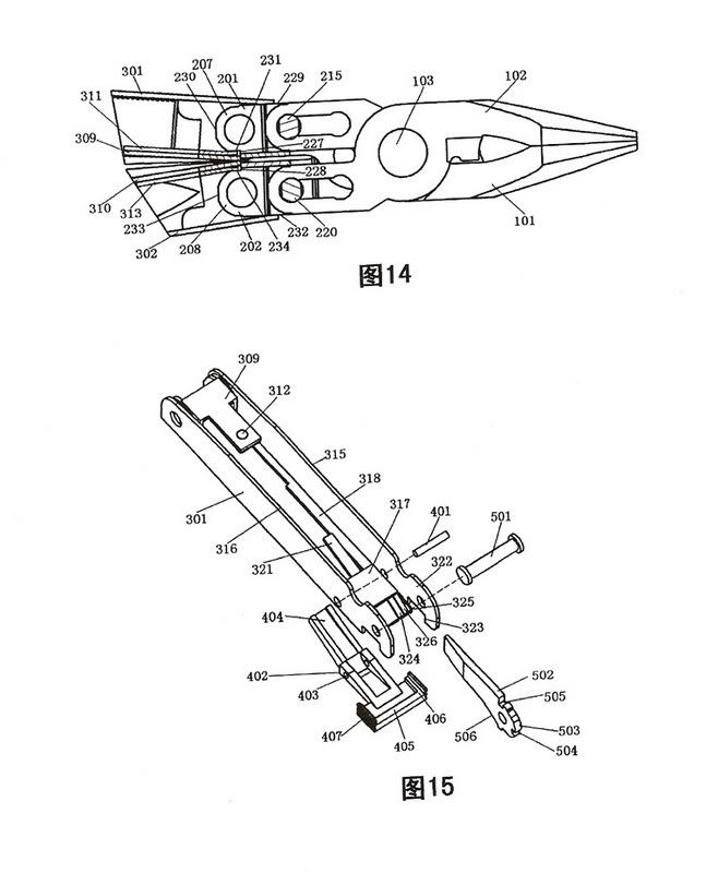

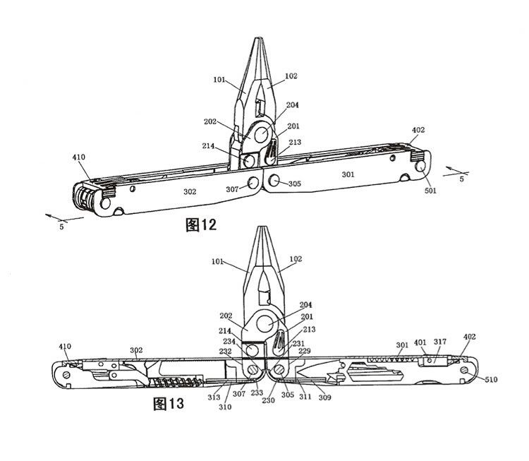

Here are some more pages:
Page 23 above.
Page 26 above.
Page 27 above.
Page 28 above.

The main features are:
1. the switch from 1:1 leverage (Figure 7 & 8) to compound leverage;
2. the locking mechanism can lock the tools at 90° or 180°;
3. the tools except pliers can be openned from outside;
4. the tools locking unit can prevent the handle moving when the users are using the screwdriver.
5. Some tools can be removed, these tools include small screwdrivers, tweezers, toothpick. The removed unit is whistle.
