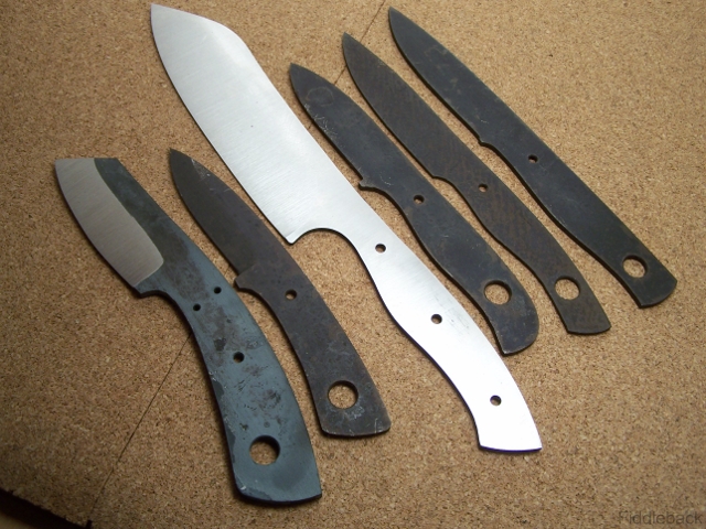

Here is what I want Andy - make the guard as similar to Joe's Terrasaur as you can:
Reduce the guard from top of the spine to bottom of the knife - and then bring it to a dulled point. I want to have a little security - but nothing obtrusive.
TF
I'll reduce the size of the guard again then. This prototype isn't going to be the final design. I was having trouble visualizing this one, so I just made one. I'll definitely be making changes after this.

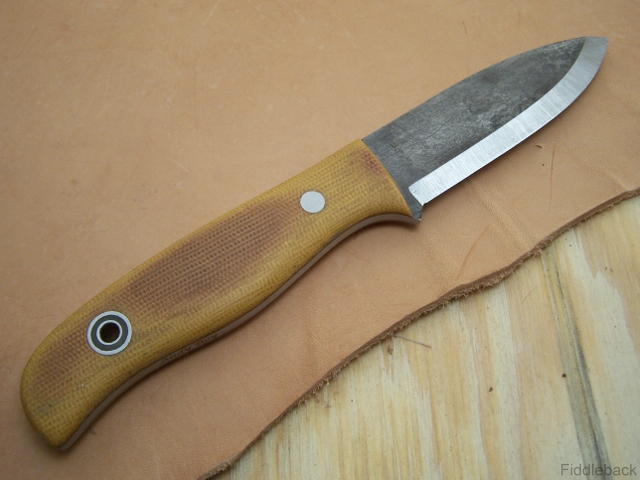

OOOoooooooo: Andy has a prototype ready:
I think the blade is pretty much perfect. The Ricossa and the guard are perfect, the handle outline is perfect - but (and I am sure this is part of the prototype) it looks a little thin and non descriot
I do want you to add a palm swell in the middle of the handle as well as a swelled butt to the knife. I am thinking that I like the Spyderco Bushcraft:
You can swell the front end too - but you have to be careful so you can transition easily to the blade - the Spyderco is a little large in this respect - but I can live with it.
Also, I am pondering having you move the lanyard hole to the rear of the knife and add a second pin to it. If you think one pin and a back bullseye will be enough - then leave it. I want the hole to be in the lower rear of the handle - I think. Thoughts?
With all of that said - can I get my hands on this one to make final changes? I will pay for shipping both ways.
I would love to see pictures of it from the top down - the scales look thin - but I want to get it in hand first if I may.

Yep. This knife is a prototype, so I put on a quick and dirty handle, just so we can get a fee for where we are. Please send me your shipping addy, so I can send it to you. On the final knife, I plan to do a handle similar in shape to the Bushies, or the Terrassaur.
That looks excellent Andy. I'd be tempted to drop the point a touch, but I'm not fussy. I agree with TF that a bit of palm swell would be most welcome. 2 pins would add a nice bit of symmetry to the handle and make the bull's eye more of a feature. In addition, a lanyard might be more comfortable with the bull's eye further back.
I am stoked about this project. This looks like a rock solid user!
Andy - I got the prototype in Saturday - why did you decide to do a 3.3 inch blade. I think this blade would be more spear point if you went out to nearly four inches.
TF
I thought the blade looked a wee bit short, but wasn't certain if it just looked that way in comparison to a bigger handle. I'd prefer closer to 4" myself. 3.99 would be OK too. :D
I've got a Laconico 3.5" bushcrafter and I really like it, but in general I prefer closer to 4". I think the overall profile would be nicer stretched out a bit.
Still, it's a great looking knife.
TF-- how are the ergo's otherwise?
Remember that the handle is going to change contour wise.

I've not recieved the knife back, but the blade will be a tad longer, the handle will be a classic Fiddleback handle, and I believe Tal is sending me a drawing with the knife that will detail how he wants the point.
