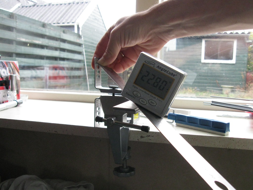

In picture 1, meassure the distance from the top of the liner up to the blue tape. I guess that is about 2"
In picture 2. Follow the direction of the liner and measure the distance up to the blue tape, I guess that is about 4" = 2 " longer distance, this will be around 1,5 - 2 degree differane I think.
Now, put a pencil on the top of the liner and draw a line from side ro side wen you swing the liner. If that line was a edge - you will get the same edge angle on the edge.
This picture shows what I try to explain. My tool Chef sharpens a curved edge and this edge curve fits perfect in distance from the pivot point.

Man, you really don't get it. The ruler in my picture is just 30 cm long but if it would be longer, for example 2" or any other length where it would touch the blue tape, representing the knife edge, it would still lay flat on the box and the edge angle would still be the same.
In your example, the blade is curved and than the angle changes just as it would change in my example if the knife would have a curved tip because the edge than enters another plane.
I hope you will have an Eureka moment and get it but if not than fine, we will than have to agree to disagree because I can not make it any clearer.

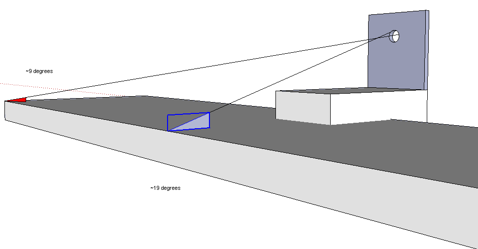

Try to forget everything you have been saying earlier in this thread and look at my pictures again with a clear and open mind.
The distance of the red dot on the floor (pivot point) to the edge (blue tape) obviously changes along the length of the tape but the angle at which the box is positioned and with it, the ruler and the tape placed upon it does not.
I don't mind arguing about this but I think that my pictures prove it.
The box is 40 cm wide so in this example it proves that the edge does not change for a blade that is between 0 and 40 cm long or for any length as long as it is a straight edge.

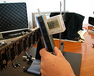

Here are some images I copied from Clay Allison's blog http://tecniques.sharpening.info/2010/08/does-angle-change-along-length-of-blade.html?q=angle+change
I edited the drawing and I hope it makes things clearer.
1. If the distance between the edge and the pivot point change - the angle will also change. Can you agree with that?
If in the picture, the edge would be at another position, for example line C or A would be longer or shorter, than the edge would change and I think that is as you picture it in your mind.
However, once the knife is in a fixed position in the clamp, neither side (A, B or C) of the triangle changes and only the sharpening stone moves along the red lines (pivot arm) and that does not change any of the angles of the edge triangle.
I believe that you think of it like the length of the pivot arm making a change to the edge angle but I hope that at least in this picture you can see that the length of the pivot arm (the red lines) do not make any difference to the edge angle.
The distance of the pivot point to the edge of the knife is not the same as the distance from the base of the sharpener to the edge of the knife (line A in the picture).
The two photo's also show this with an angle cube. The 0.1 degree difference in the two photos are well within the margin of error of the angle cube.

This picture shows what I am talking about.
This is a sort of standing clamp (if the clamp stand up or lay down do not matter). The hight up to the top of the liner are 155 millimeter (mm).
A liner, 30 cm long, are clamped in the middle on the 15 cm mark on the liner. I have drawn 2 pivot points, one in 15 degrees and one in 25,5 degrees.
from the 15 degree pivot point up to the top of the liner on the 15 cm marking is: 159 mm. to the 20 cm marking is: 167 mm, to the 25 cm marking is: 188 mm and to the 30 cm marking is 219 mm. I have also drawn a belly and a tip of a knife blade. To the tip is the distance 205 mm. The edge angle is 15 degrees on the 15 cm marking on the liner. On the other markings the edge angle are lower then 15 degrees depending on that the distance are longer to those points.
From the 25,5 degree pivot point there is a distance up to the top of the liner on the 15 cm mark: 170 mm, then it changes to: 177, 197, and 227 on the 30 cm mark. The tip of the blade have 214 mm distance.
The degrees on the edge (where the pivot point are) do not matter, this rules by the law of physics. you cannot avoid it or go around it - if you have a fixed pivot point.
All sharpening tools work after this principle. EdgePro have a fixed pivot point - but you can move the blade instead of the pivot point - but then the blade is not fixed.
I made also a arc with 159 mm distance from the pivot point. An edge following this arc will get an exactly 15 degrees edge without any changes of the angle.
Lets say that the pivot point can move parallell to the edge (closer to you in this drawing). Then the edge angle do not change at all before you come to the belly. When you come to the belly you move the pivot point back a little to keep the correct distance, (there is a way to do this in a very simple way).
With a moving pivot point anyone can sharpen any edge up to a swords length - and keep the edge angle 100 % the same all along the edge. (I have made a tool with a moving pivot point - just to be able to do just this.
As I wrote above, a short blade gets small changes. If I shall sharpen a Bowie, machete or a sword, the changes in angle will be very big. This is important to understand - in my opinion.
I enjoy precision grinding. My tool Chef can change an edge 1/100 part of 1 degree - and then go between this two surfaces and hit them correctly without changing them. I enjoy this precision. I have now use at all of changing an edge so little - but that is the smallest change I have made with full control of the angle, this means that I can make, for example, 0,25 degrees change also - or any other angle - and that is for me useful. As you se, I am a grinding nerd :)
I have made this drawing in a program named Sketchup. It is a 3D program. You can download it from Google and it is free. If you like to have the drawing just contact me by PM and I send it to you. if you download Sketchup you can then se this drawing in 3D and see it from any angle. It is a very nice program to work with and simple to learn how to handle. You can also check that all distances are correct.
If you are good in math you can calculate in degrees, or part of degrees, the changes are- now when you have the distances.

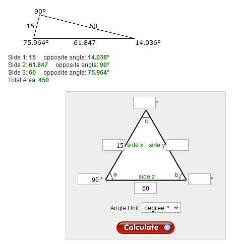

have you heard of the 1/60 rule of estimating angles?
a rise of 1 mm and a run of 60mm is a 1 degree angle
a rise(height) of 10mm and a run(length) of 60mm is a 10 degree angle
with a lansky type system the rise(height, y-axis) is fixed , its the hole in the clamp,
but the run(length, x-axis) is not fixed (it changes), its the distance from hole to the edge
Play with this you'll we what I'm talking about
keep rise at 15 and change the run, as run gets longer the angle gets lower
rise 15 run 60 opposite angle: 14.036°
rise 15 run 70 opposite angle: 9.462°

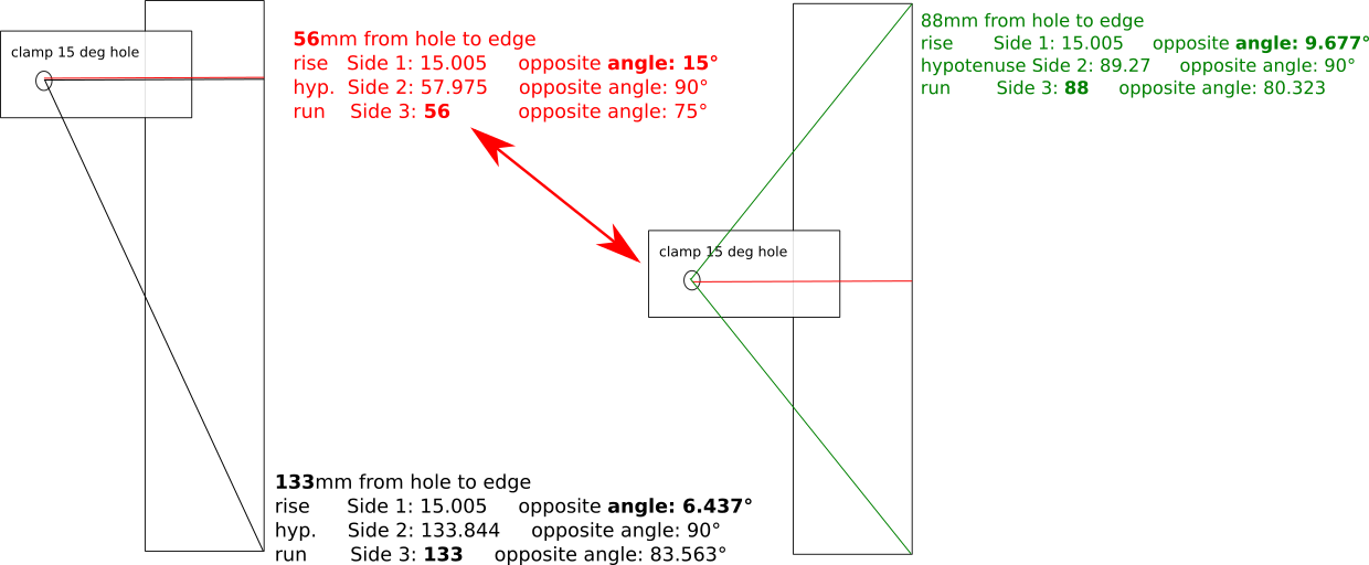

Yes, of course the angle changes depending on how far the edge of the knife sticks out of the tip of the clamp (or run length as you call it).
However..... during sharpening that length does not change anymore the knife is set a a certain position. The rise (hole in the clamp does not change either.
You can have for example a clamp of 3 cm wide with a 10" long knife in it (like a Lansky clamp) or a 10" wide clamp with a 10" long knife in it. In the last case you would have a very wide hole for the sharpening rod but the sharpening angle will still be the same, no matter where in that wide slot your rod is.
Lets assume for arguments sake that you place 10 Lansky clamps side-by-side and clamp that 10" long knife along all the clamps.
No sharpen the knife in segments at lets say the 20 degree setting using each clamp only for the width of that clamp.
Would you agree that the whole length of the knife is now sharpened at a constant angle of 20 degrees?
Lets now stick one of the rods in the 20 degree hole of the left clamp and let it rest at the edge of the knife of the right clamp.
Measure the angle that the rod now has from that 20 degrees hole down to the edge on the right side. Of course (diagonal sloping angle of the rod is much lower than 20 degrees but now you are measuring something completely different, not the angle of the edge.
Look at the triangle as drawn from the calculator from your example.
Now imagine that it is not a one dimensional triangle as in the drawing but like for example a 3 angular wooden beam with a length of 2 meter.
Your angle b of 14.036° as from your calculation would stay the same along the entire length of the beam.
Frans
