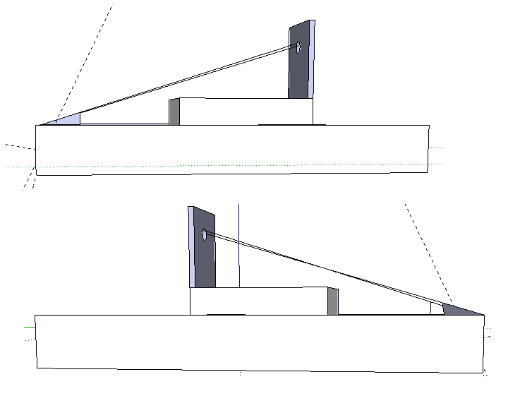

I agree with Franz, and cdwx34. But I took all my math 30+ years ago so I do not propose to try to prove this with math. The dental floss picture shows it best.
If this is equivalent to me saying that "Lansky is wrong" I'm ok with that.
When I first saw the Wicked Edge post a few years back, that the angle doesn't change, I thought, "that's crazy, of course it changes". It's basic trig that most learn... if the distance increases, the angle decreases in a triangle, right?
Long story short, after a bunch of testing, I ended up figuring out, that WE is right. As long as you're in the straight area of the blade, the angle won't change, no matter how far down you go. Take a look at these pictures...
Hope this helps!
Yes, the floss helps :) you guys are right, the angle doesn't change, the floss lines up, same model as in previous picture (where I measured wrong angle) just different perspective, angle must be the same
originally I was only going to comment regarding the angle changing/lowering when you reach curved area of blade(like tip) ... got confused somewhere and started playing with sketchup/inkscape :) and it didn't help my confusion
in my original image I measured the wrong angle, not at 90 degree to the edge , thats why it was different , just had to look at it sideways to see the angle is the same because the floss lines up

The principle is the same for all the clamping systems. As long as we are talking about a straight edge that is clamped in such a way that it is parallel with the back of the clamp than the angle will stay the same along the entire length as illustrated in the previous three photos.
The problem seems to be that a lot of people do not understand the principle and for example only look at the angle of the sharpening stone lengthwise (which changes but that is not the angle at which it sharpens). They do not notice that the stone also has another angle which is sideways and which does not change. It is this angle that sharpens the edge.
In the second photo, the lengthwise angle of the ruler is higher than the lengthwise angle in the 3rd photo where it is closer to the tip but as can be seen on the angle cude, the angle as measured across the ruler sideways (the way it sharpens the edge) stays the same

I don't know if everybody has agreed on this yet. I'm an engineer and know more than a lot about angles and geometry. I use a DMT aligner and proved to myself long ago that the angle doesn't change along the straight part of the blade. I'll make 2 attempts to explain:
from post #25 this image does a pretty good job of explaining. If the wire frame drawing shows 2 planes, one that is vertical representing the blade and one that is angled representing the primary bevel, and the 2 planes meet at the edge. At the bottom of the angled plane is the pivot point for the sharpening device. As the sharpening device swings along the edge it stays aligned with the plane of the primary bevel.
and now I think this was from post #26- If the distance increases then yes the angle between this line and the edge decreases. BUT, and this is the critical point, THIS IS NOT THE ANGLE THAT WE ARE INTERESTED IN. The angle of the bevel that we always talk about is measured perpendicular to the edge. The line that pivots towards the end of the blade, the line that we are saying the angle of which changes, is no longer perpendicular to the edge. So yes the angle of the line changes, but the bevel angle of the edge does not change.

I Hate to say this - Franz, your opinion are correct - and I was wrong.
Thanks for a nice diskussion :)
Thank you for that explanation. This is where I was hung up.
That was the explanation I understood also :)

I think the real key to understanding the fact that the planar angle doesn't change is having the clarification that the stone is free to rotate and slide along the axis of the guide rod. This is the complexity that is hard to envision and that allows the plane to be maintained.
