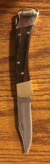

I've been mostly offline the last couple weeks for the holidays, but I caught D DGladden 's excellent thread about his 110 that Buck fixed up. As it happens, I recently picked up a 111 that could use more help than I can give. I don't think this'll sharpen out. It looks like a prior owner used just about every possible surface of the knife to whack on something. At some point, I wonder if Tony ever thought of getting a hammer and slipping his knife back into his pocket. Because, of course, the sheath is gone.
Anyway, aside from the obvious damage, there's a lot to like about this knife. It's my first 111 Classic, and I was surprised to see Buck's name engraved in script lettering near the back pins. Tony's name has some nice engraving as well.
I can't say Cat the Cat was pleased that I used the scratching post to take photos, but we survived.
Ouch that one has seen some better days. I don't think I have any 111 blades hiding anywhere but should be able to re-blade it with a 110. It is difficult to remove the engraving in that area without with out taking off to much material on the scroll work. Please put Attn: Forum on the outside of the package so it will come straight to me and I can take a closer look. It also looks like the main pivot pin might be popped and the scales are bent outward. This might be a challenge. We can discuss the steps moving forward once I have it here. Please also fill out the warranty repair form to send with the 111 so I have good contact information.

Wow! Thanks! The engraving looks like it was done by someone with quite a bit more skill and care than Tony. I don't mind it at all. (I wonder if it was a gift for a someone who didn't value it. Or maybe Tony was actually a wonderful man who took care of his horses and dogs, but got his knife lifted by a neighbor kid. I have so many questions.)

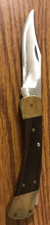

It’s tough to get them cheap enough to bother. I’ve sent in 2 groups. The first above was sentimental.
The second group was because I had a special one with a broken blade. I waited until I accumulated I think 5 beaters. To send in all at once.
I made sure in the end I wasn’t paying over the current list price. You also have to allow for a new sheath.
At the time I was accused of abusing Bucks generous offer to reblade them. But sending in a group saved me and Buck on shipping charges. So I don’t feel guilty.
The reality at the time was I wanted Macassar ebony handles on them. Before they made the deal with the guitar company.IMG_1211.jpeg
The one in the middle is the special one. Someone broke the blade on it when it was new. It otherwise was cherry.
A nickel silver 110 with Macassar ebony is not easy to find. I think I have $30 invested in it.
At least I think its ebony, it looks different than my others. If anyone knows what wood was used on them I would love to know.
BTW. All of the knives I sent for new blades came back in awesome shape. Great job by Buck.
