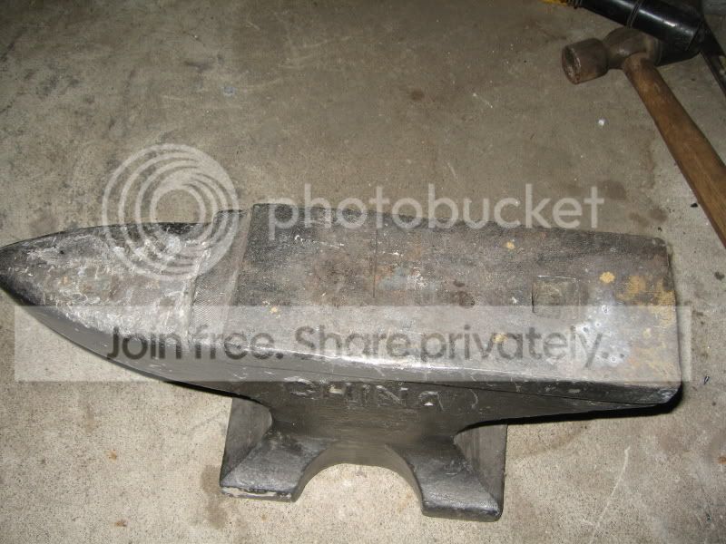

hey guys.....i need an anvil and am having trouble finding one close enough to me that is cheap enough.....i see alot of people build stands out of wood to make their anvils heavier and to lift them up.....can i just build a big base out of wood and put a flat plate of steel on top of it?....if so, what kind of steel do i want to use to take the abuse of consant hammering?....is my idea possible.....thanks for any comments.....ryan
ohh i have also seen i think tim lively using a bucket with a big post sticking out of it.....is this a possibility?....again what kind of steel do people use?
I have one of those, I've used it twice and the edges are breaking off, really soft! It'll work though, but it feels like it'll break in half when you hit it. I'm using a piece of railroad track now and it works pretty well. A lot better than the China anvil except it's not flat. If you go to a rail yard usually the guys are happy to help you. If you watch Harbor Freight they have these on sale for $19.99.

Stay away from cast iron anvils from China. There are several write-ups on the net about them and I even read a book written in 1901 in which the author warns about cheap anvils from China.
Look up the bearing bounce test and go try it for yourself.

The main problem with cheap anvils is they are made of cast iron (as apposed to cast steel). "Cast iron" has a huge amount of carbon in it. Way to much for the iron to absorb and it forms flakes in the casting (for lack of a better description) that absorb the shock of the blows instead of rebounding them. This also makes the corners brittle. This is also why many machine tools and motors are cast iron. Besides welding on a layer of hardfacing you can weld on a "cap" of tool steel.
