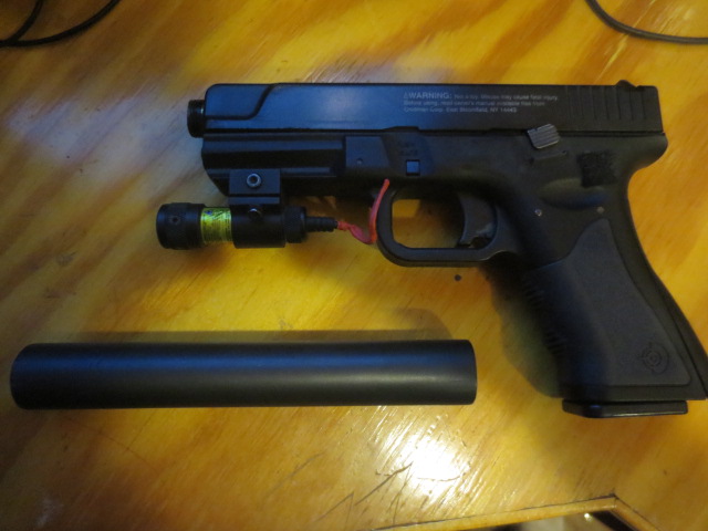

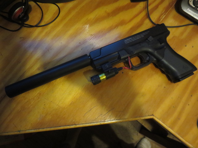

I shoot a Crosman T4 and a chepo PowerLine 15XT. I've got a laser sight affixed to the underside of the T4 as well as a fake suppressor hanging off the barrel. For a 12 gram plinker, it takes out bark rats just fine.

Vortex, that t4 looks like it is a blasst to shoot . Very cool with the lazer.

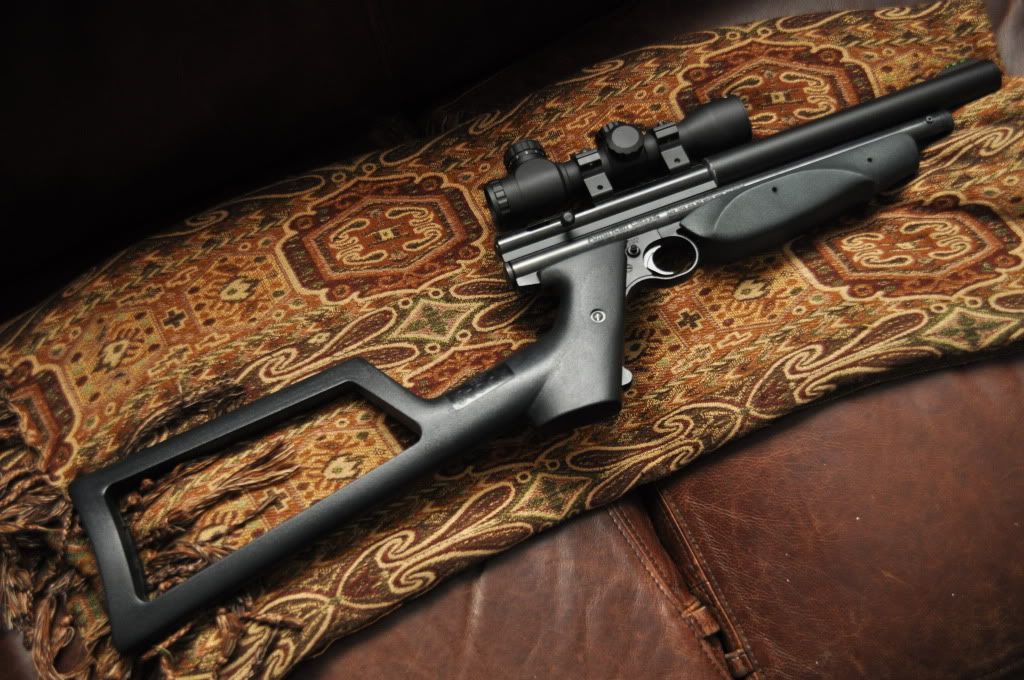

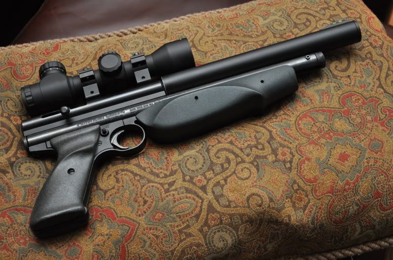

I wouldn't consider myself a "airgunner" but I do enjoy shooting mine whenever I have the chance. I used to have .177 Beretta PX4 blowback which was fun but more for plinking. I have a custom Crosman 1377 that I actually got here on the exchange a while back and love it. It's been converted to .22 and has an aluminum shroud with baffles. I also have a set of RB wood pistol grips and a black Crosman stock which is what I usually use with it. It's all topped off with a matching black forearm and a Leapers illuminated mil-dot scope. Great target shooter.

That is seriously awesome. Any idea what kind of velocities you get from a .22?

The valves have been swapped out to compensate for the heavier pellets so It's shooting around 600 fps with 15 pumps. Not quite enough for small game hunting but if you got a longer barrel, you'd get a good increase in velocity. The actual barrel on mine is pretty short (it stops about 2.5-3 inches from the front of the shroud) since there are baffles in front of it. For yours, some new seals and a .22 barrel shouldn't be all that pricey so I say go for it! There are a bunch of custom part makers online that make 1377 parts so if you ever wanted to go further with the project, there are TONS of options.

I assume the valve/piston are flat top to be pushing 600fps. With proper shot placement, that's enough for small game like small rabbits (cotton tail) and 'possum. If using 14.3gr pellets that's about 11.4fpe! The flat top valve/piston is not needed for the .22 pellets but is nice if you're going to hunt. I have stock piston and valve and am pushing about 420fps which equals about 5.6fpe with 14.3gr pellets. I shoot rats and starlings with no issues.

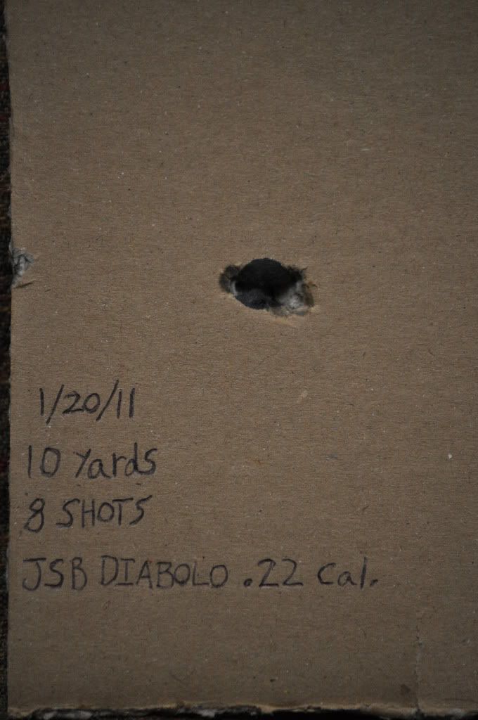

For the 1377 swap to a 1322 all you need is a barrel and bolt. The bolt O-ring is a different diameter and is needed to seal properly. DP1110, that is a pretty slick build! Is the forestock also an RB? I really like that one. Good shooting too! You must have a match grade barrel, or at least have it crowned.

Correct, it's got a flat top piston/valve. I have used it for pest control (squirrels ruining the roof of our garage) in the past and it did just fine but I'm more of a target shooter in general. The barrel is a match grade barrel and the front of the shroud is crowned. Once the gun is zeroed in, it's very consistent. I've found JSB Diabolos (15.8gr) work great for target shooting and as for pest control, I like Predator Polymags. The forearm is not RB, I believe it was a Crosman offering but is now discontinued. I could be wrong on that though.
