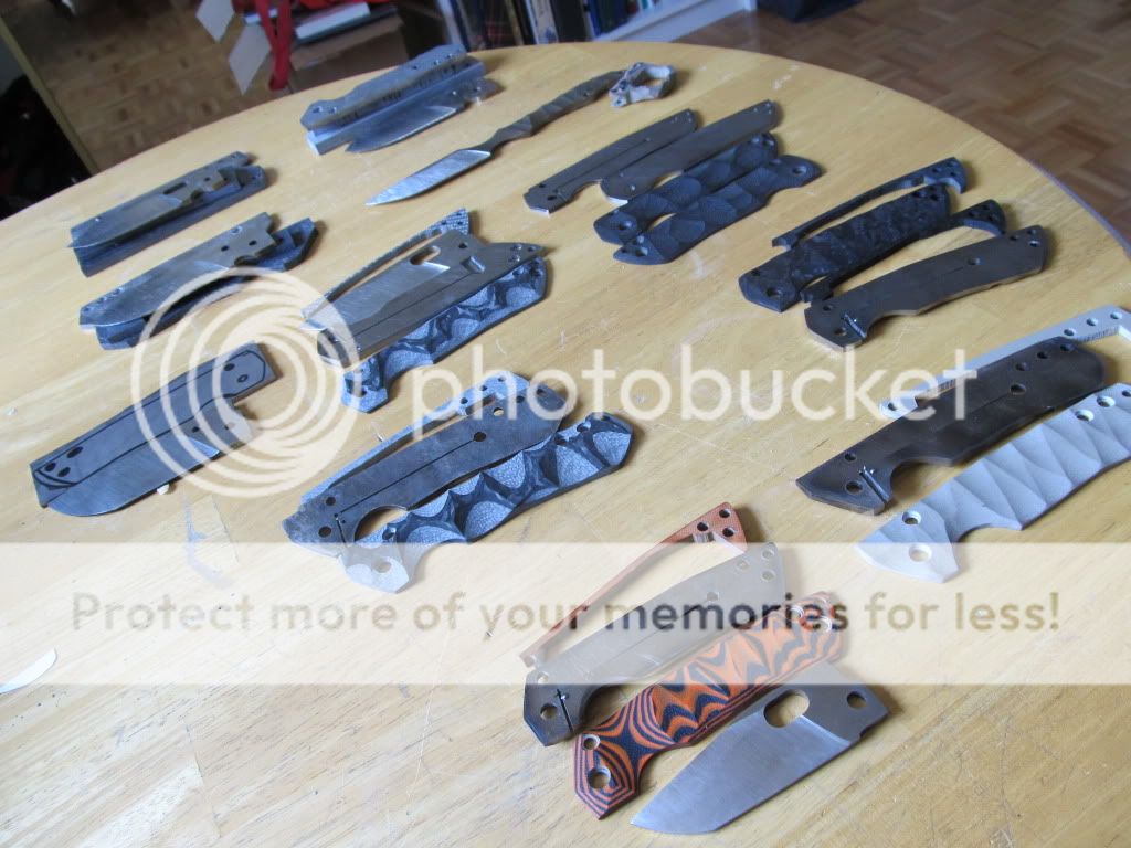

Interesting post by kwackster here at Bladeforums, pointing out the possibility of making a thicker frame lock relief, by broadening it over a larger area http://www.bladeforums.com/forums/showthread.php/619899-Frame-lock-or-liner-lock-strength
@ Cotherion;
You're not the only one thinking about possible improvements on framelocks, Strider for instance already does what you are describing, by broadening the relief as much as possible.
But there is another concept that got my attention, and that's the way it's done on the older Benchmade Pinnacle, not by thinning down the relief, but by hollowing the lockbar out from the inside.
This effectively creates a u-shape which, in my opinion, should withstand buckling forces better than the standard lockbar reliefs which have been thinned down from the outside or inside.
Take a look at the last picture;

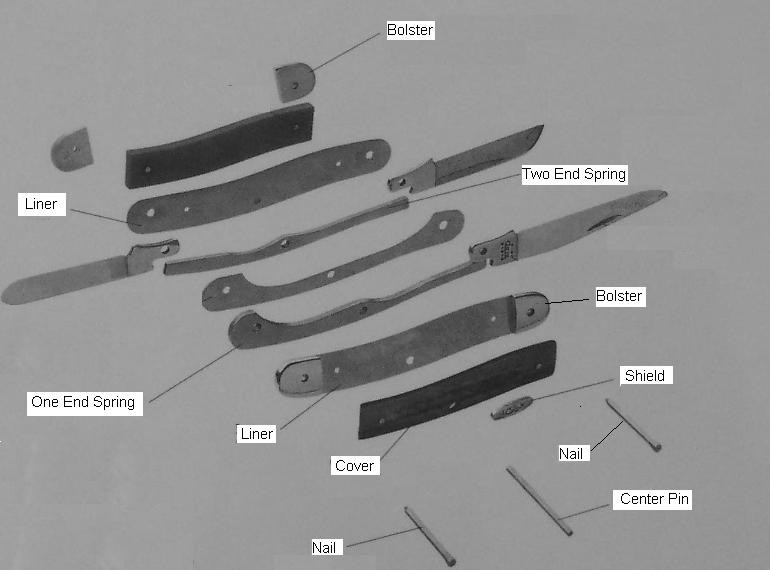

Liner Lock Design:
show_image.php
Liner lock knives have been around since the late 19th century. The Cattaraugus liner locking patent, 825,093 was issued on July 3, 1906. After 1923 when the patent expired, it was used by other manufacturers such as in the common military and lineman's issue two-blade electrician’s knife; the Camillus TL-29 for the locking screwdriver-stripper blade, until 2007 when the Camillus Cutlery Company went out of business.[1]
Liner lock mechanisms are most commonly composed of titanium alloy or steel.[8] The liner lock's locking side liner is split from the top toward the bottom, similar to an automotive leaf spring (also called a lock bar) that butts up against the tang of the blade to prevent the blade from closing.[9] In an interview with Blade in 1988, Walker stated, “This long leaf-spring effect cuts down on stress on the locking mechanism".[9] As the lock on the original electrician's knife was mostly to hold a screwdriver blade open (the knife blade, itself was secured by a slip joint methos), Walker's refinements prevented the knife blade from closing on the user's hand and converted it into a true lock.[8][10]
There are a number of other variations on the liner lock or locking liner, depending on the knife manufacturer. One example would be the frame lock, sometimes called the Reeve Integral Lock and used on the Sebenza. With the "frame lock," the frame rather than the liner acts like the leaf spring/lock bar. Another variation, known as the inset liner lock has the leaf spring embedded into the plastic scales of the handle, technically forgoing a metal liner. Kershaw Knives uses "a pin-and-dimple lock" on a knife designed by custom knifemaker RJ Martin called the "Nerve" to keep the blade closed.[11]
