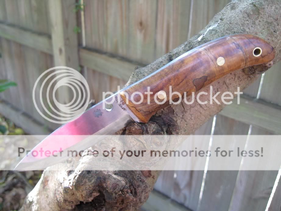

I have had mine for a couple of weeks now. When I got it, there were some small cracks, and the handle scales had some shrinkage. There was visible and tactile evidence of that, the tang was exposed.
I steamed it lightly, which opened the cracks. I then used a good quality CA adhesive to fill the cracks. It took several applications, and in between each one I lightly sanded the wood.
When I was satisfied with that, I used 300 grit sand paper to buff the wood, and then finished it with Min Wax Maple stain. Several coats, each buffed with 000 steel wool, and finally with 600 grit paper. One last coat, and it looks good, the cracks are sealed, and the shrinkage taken care of.
For $90 and some time, it was well worth it to me.
here is what the knife looks like after my working on the handle, and after a rough week in the woods, where I really worked the knife hard. In the field, it performed very well, batoning, cutting, chopping and kitchen chores.
It performed like the $300 knife it really is.
