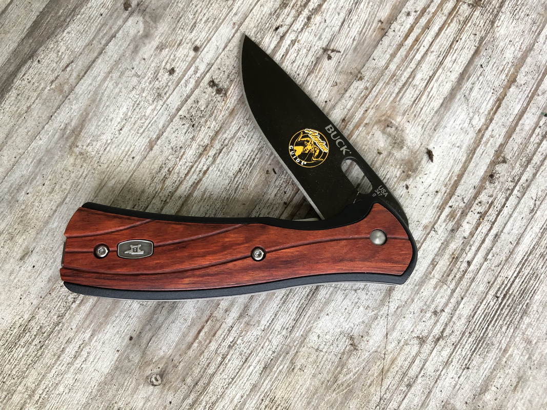

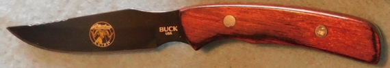

In a word, yes. I knew it would scratch if I didn’t take it slow. It takes a light touch and you need to keep the edge of the razor blade at a pretty shallow angle. I actually scraped backwards with the blade quite a bit too to thin the logo. I then finished it up with some scotchbrite pads and 1000 and 1500 grit wet dry sandpaper. A little WD-40 for cleanup and I was done. I’m satisfied with the results, but I know I could’ve really messed it up if my hands slipped during the process. It’s probably why I haven’t attempted my 110… yet.Were you scared of scratching the cerokote with the razor or would it not do much to it?
