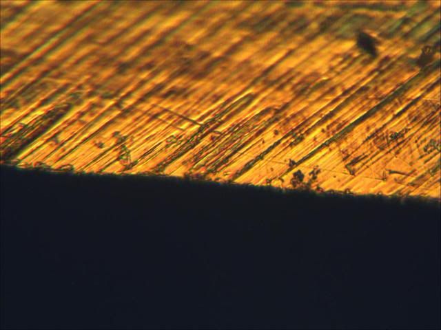

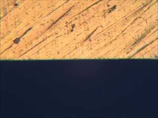

Here are a few that I found very revealing - first is 1095 carbon on a 1200 grit King - backhoned with a fairly thick mud - 1600x (1000x plus digital blow-up). Scale at upper L is 3u. Tree-topping sharp.

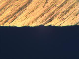

This one is also 1095 on a Spyderco EF followed by flexcut gold (.5 micron to 1 micron estimate) followed by plain leather - could just pass a HHT. This one at 640x - scale at upper L is 7u.

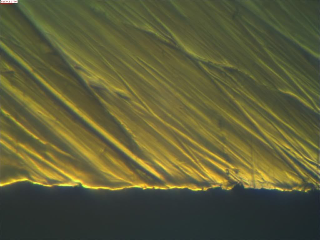

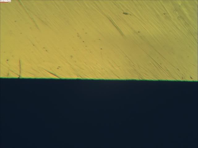

And these two as a pair because I was quite surprised at how much wasn't visible at 640x - the first image is 640, second is 1600. I expected the grind pattern to extend to the apex. This was Aus8 (I think) done on an Ace hardware AlumOx stone, stropped with white compound from Sears (maybe 1-3u?). Edge could treetop hair but just shy of whittling.
There's an awful lot to this - I stopped taking pictures/studying micrographs as I felt my sanity slipping. Now I frequently don't even use my loupe, just good lighting and a few quick cut tests. BTW the burr fold over technique as you describe is a staple of mine - I keep a short length of oak dowel in my bag for just such a purpose.
:thumbup: excellent pics Heavyhanded.
I saw these pictures of yours in 'steeling..' thread (IIRC) before but didn't registered that there are shadows next to the apex of those 1600x pics. Those look like trough/hollow lines, could imply that those edges are sharp but weak - could be interpret that those edges have sub-micron burr/wire. Hollow lines reflect/scatter light away from the receiver - therefore render as shadow, that why I speculate those edges are weak.
Your thoughts?
Edge-leading interaction is more harsh (larger impact force) than edge-trailing. So, in order to have an equivalent thiness/refine edge as edge-trailing, for edge-leading you need to use smaller abrasive in good strong binder that can resist & withstand cut/gash.
A clean thin un-compromising-geometry apex plays important role in a knife performance. It would be great if you or someone would tests & snap a few 1000x+ pics of finished edges using stroke direction.

I chalked it up to an effect from the cedar oil and my inability to master the lighting properly at that magnification. I notice the effect you observe on many blades I micrographed at 1600x, including factory honed razors and those done by other individuals - sometimes visible, sometimes appear/disappear simply by breaking contact with the oil and re-immersing. To get the images as I have I had to run a piece of tape off the back plane of the blade to support the oil drop necessary to focus - the oil is held in a shallow trough instead of being supported on a flat plane with the imaged bevel side. What effect this has on the way light passes thru the oil I can only speculate. I did go back and do the backdrag test as you described - in fact the backdrag test has been part of my SOP for some time. Here are a few others that are "cleaner" but I chalk the difference up to luck when preparing the tape and oil. This one is off an India stone and stropped on AlumOx compound on leather:

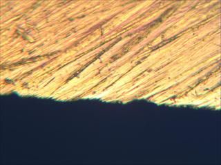

This one from the coarse side of an India stone and stropped on black emery compound
At 640x even if there is a burr, it's generally fragmented along the grind troughs, not continuous (tho appears continuous at 160x or lower). At this point I shrug and reduce the number of images I bother to take at 1000x or greater - instead focus on edge retention as relates to specific cutting characteristics (all informal of course).
As for how weak they might be I can only compare my own to factory edges, edges I have prep'd with various media, and anecdotal edge retention from other members. From what I understand of these, my edges are comparable and (IMHO of course) better than some other results that have been posted with comparable steels. From what I have observed (mostly at 640x but a handful at 1600) presence of submicron burrs or wire edges cannot be detected visually without SEM - optical magnification becomes too variable for untrained folk such as myself. As I said, I stopped pondering many of the variables you have mentioned in this thread as being too dependent on the material to be cut and the expected longevity of the edge, and only include my observations re burr removal and thoughts on how it relates edge leading and edge trailing. If a burr cannot be made to show itself after a backdrag test then it like as not doesn't exist or will have no bearing on performance. Consider the human eye can see the light from a cigarette at 1 mile yet cannot even begin to see the cigarette. From what I have observed, if strong light does not reflect back from a burr/wire edge at 6 or 8x (or even with the naked eye) so as to be seen, it won't be detected optically at any magnification. Of course all results wide open to interpretation.
Thank HeavyHanded:thumbup:
Your assessments are right on and I agree, edges from these 2 new pics are clean, so extrapolate back to other pics must be oil obscured light then.
Note that these nice edges were produced by you - a sharpening expert. Can a novice produce such clean edges with stropping?
If you don't mind and time permits, please post similar pics for:
1) the same blade (1095 fine-grain?) after stropped on india stone.
2) the same blade after edge-leading finished on india stone.
3) another blade with high-alloy steel such as s**v/m4 or vg-10/d2/cpm154, trailing vs leading ended on india stone.
Weak edges can be sub-micron thin or 20 microns thick or perfect but too thin below the apex. Depend on edge purpose/task, roll could instantly destroy its performance.
Later on, I like to examine how 'too thin below the apex' would affect performance for various steels - Leverage data from Ankerson's steel-ranking tests maybe we can shed some light.

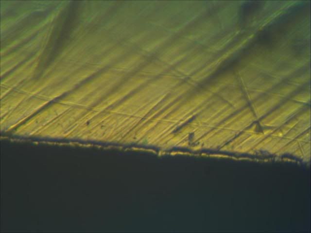

Here is a progression I thought you might be interested in from a test I ran a number of months ago - don't believe I posted it anywhere on the forum. Again not quite part of the conversation but not far off either.
All images at 640x.
First pic (CSV_1) is of an Aus8 blade after being ground on a fine Crystalon (Norton silicon carbide) stone, and stropped on two layers of newspaper treated with the swarf and oil from the stone to deburr. In my opinion this produces the cleanest representation of the stone-ground edge (burr-wise) without substantially changing the grind pattern. The paper was wrapped around the fine side of the stone. Second pic (CSV_2) shows the effects of 40 passes/side, very light pressure on two layers of newspaper wrapped around the fine side of the stone, treated with the Sears white AlumOx compound. Third shows the effect of an additional 25 passes on a single layer of paper wrapped around the coarse side of the stone. Enough pressure was used that I could just feel the stone's texture under the paper - maybe twice the pressure I would normally use and enough that I would be concerned about rounding the edge if I were on a leather strop. I've run similar tests before, but never starting with an edge prep'd at such a coarse level to start. I was quite surprised at the transformation. The process did not raise a burr despite the amount of material removed - resulting edge could just whittle a hair. I believe there is something very different about the pressure spiking associated with stropping on an irregular backing that produces such a difference in abrasive action, but am at a loss to explain it.
...associated with stropping on an irregular backing that produces such a difference in abrasive action, but am at a loss to explain it.
Cool pics & awesome technique!
I've been working on a simple physics model of abrading interaction - dragging along with my head-cold. It's much easier to explain this case/scenario using the model - '..I have found a truly wonderful proof, but the margin is too small to contain it.' || 'A pointy-sharpened hex bolt is an interesting nail'.
edit: It's the conical bumps in the abrasive surface, changed the resultant abrading force vector less upward, more parrallel to spine-apex line.
My speculation is that it increases the upward force of the abrasive but in a more narrow plane - where the abrasive had it been packed shoulder to shoulder on a level field might have spiked the pressure at the apex and rounded it over, instead the blade is supported on a bed of nails so to speak. Each one exerting more pressure individually but incapable of rounding the edge over (at similar pressure overall) due to support from the other points and the sharper let-off of pressure as the edge passes over the low spots. Or something like that....We might be saying the same thing...:confused:
