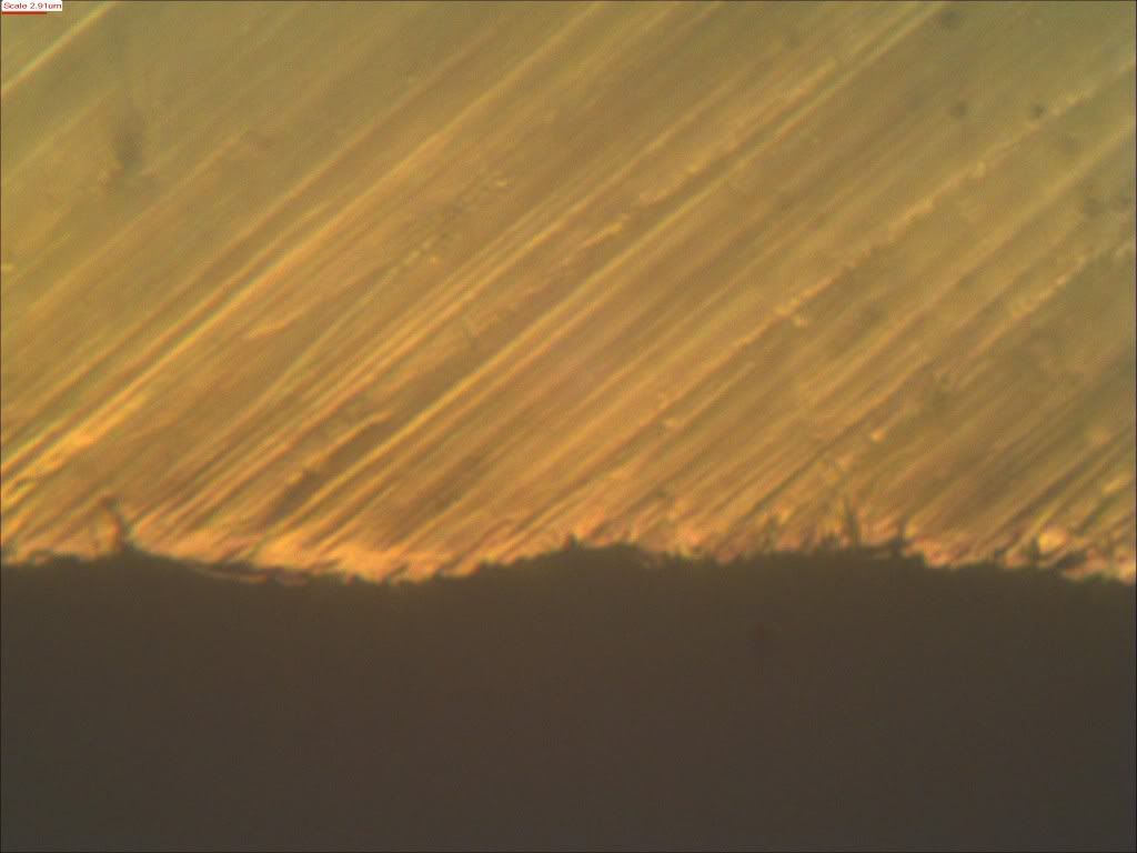

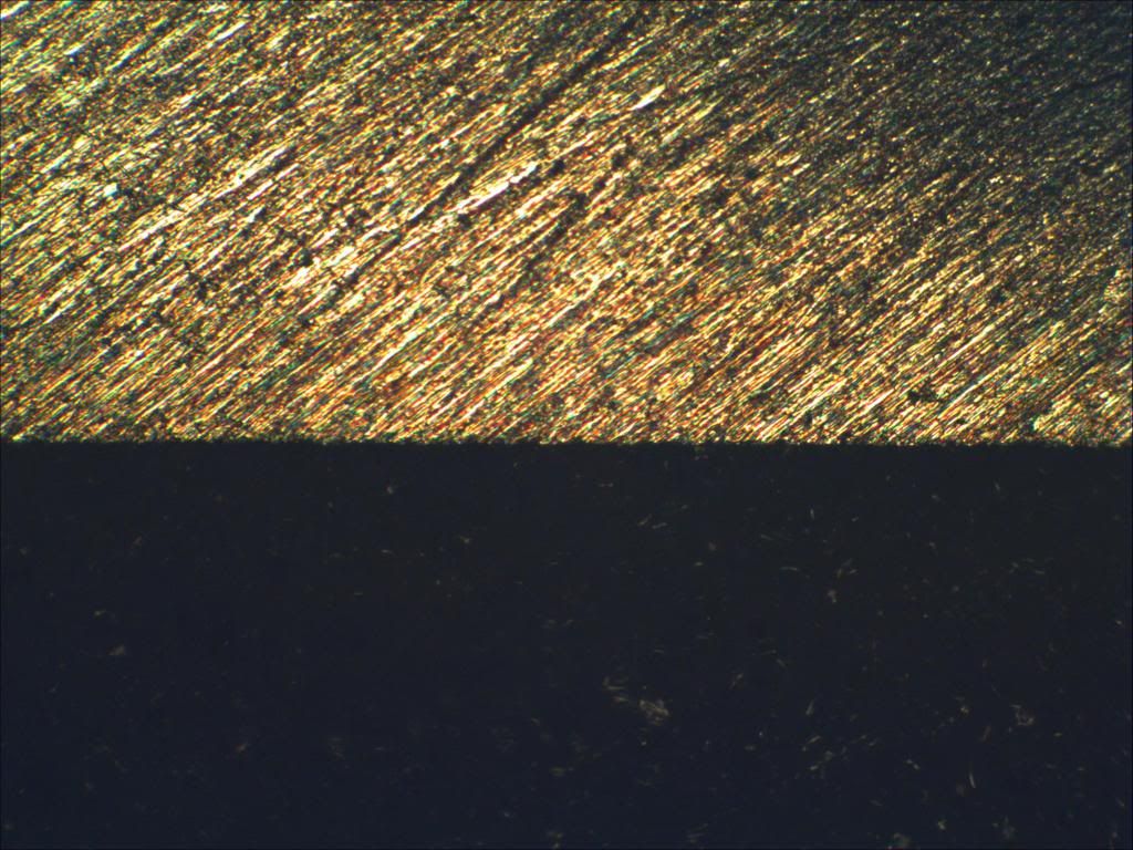

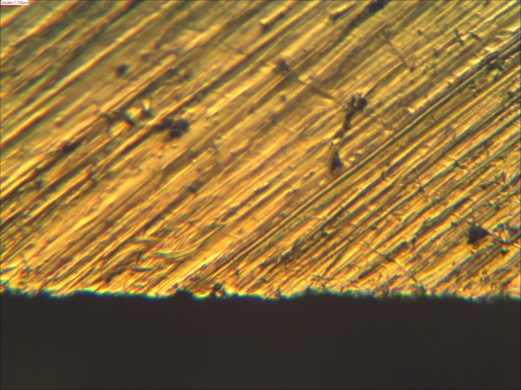

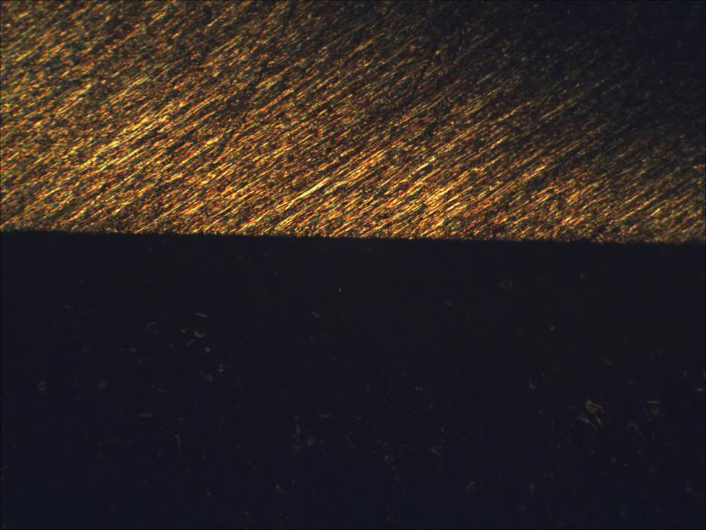

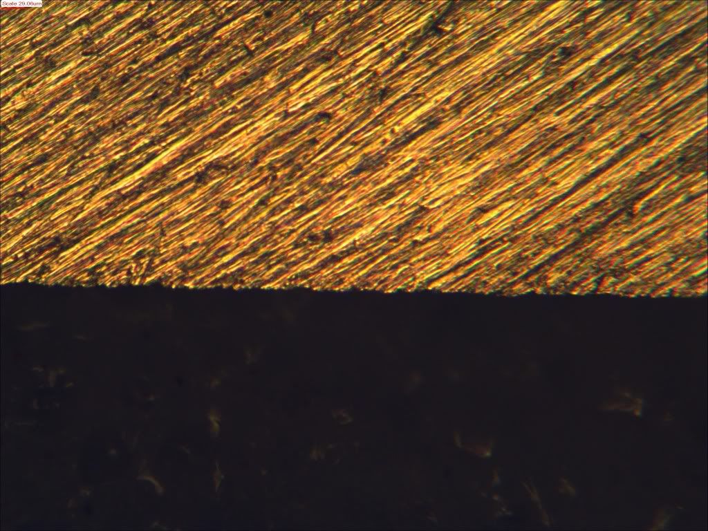

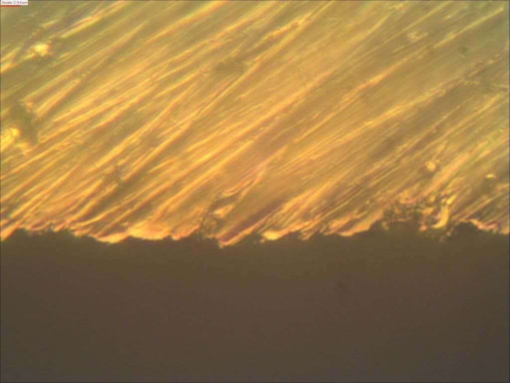

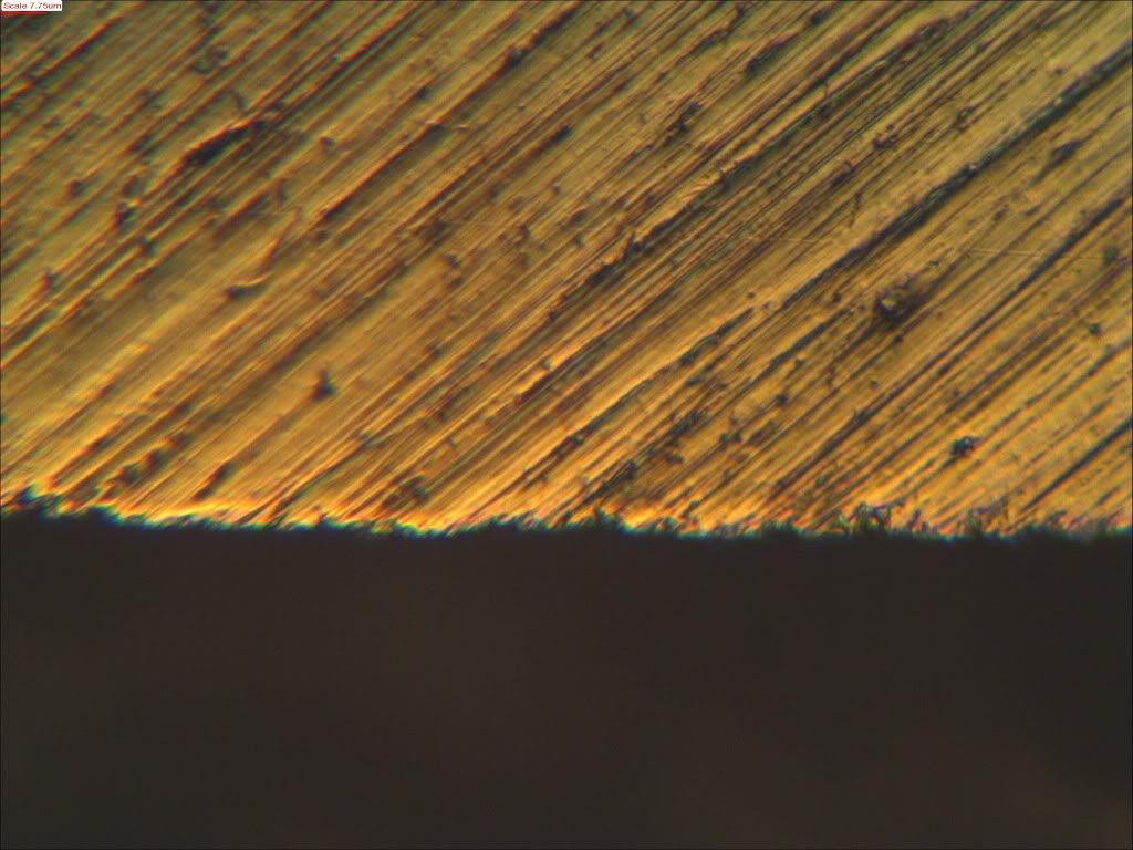

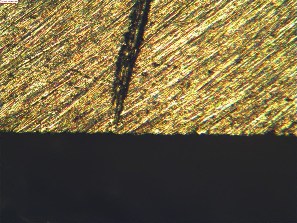

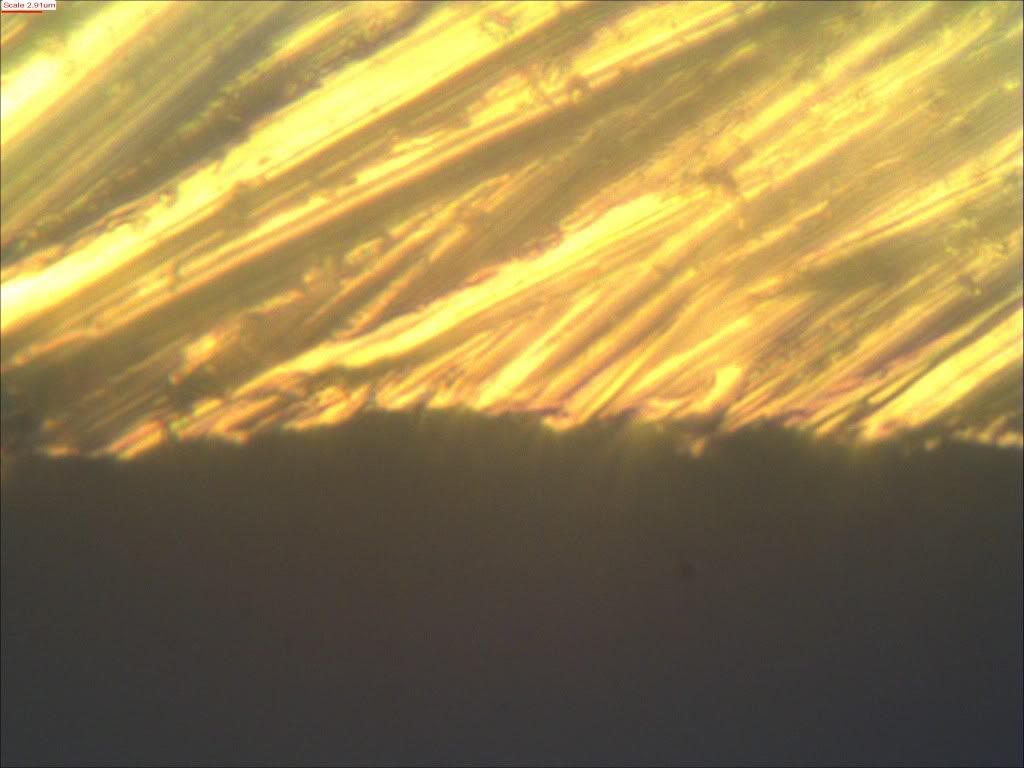

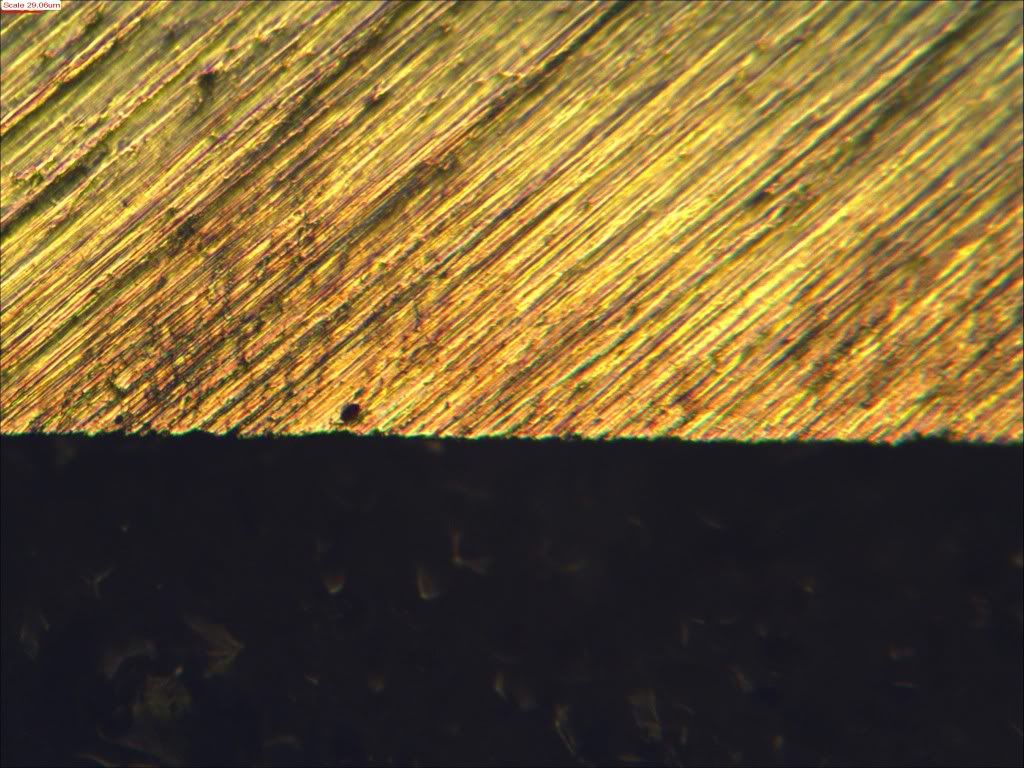

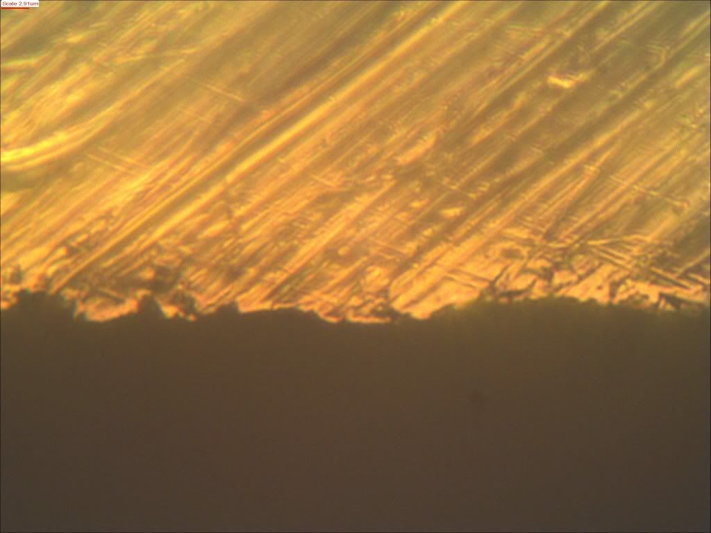

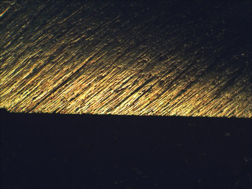

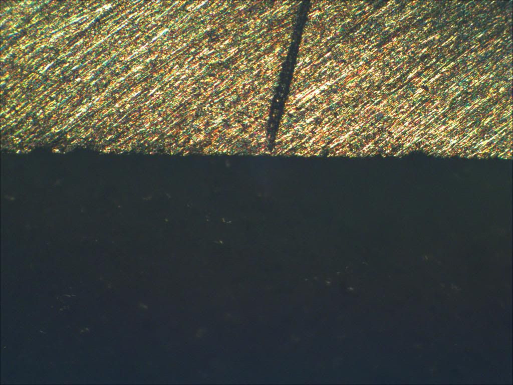

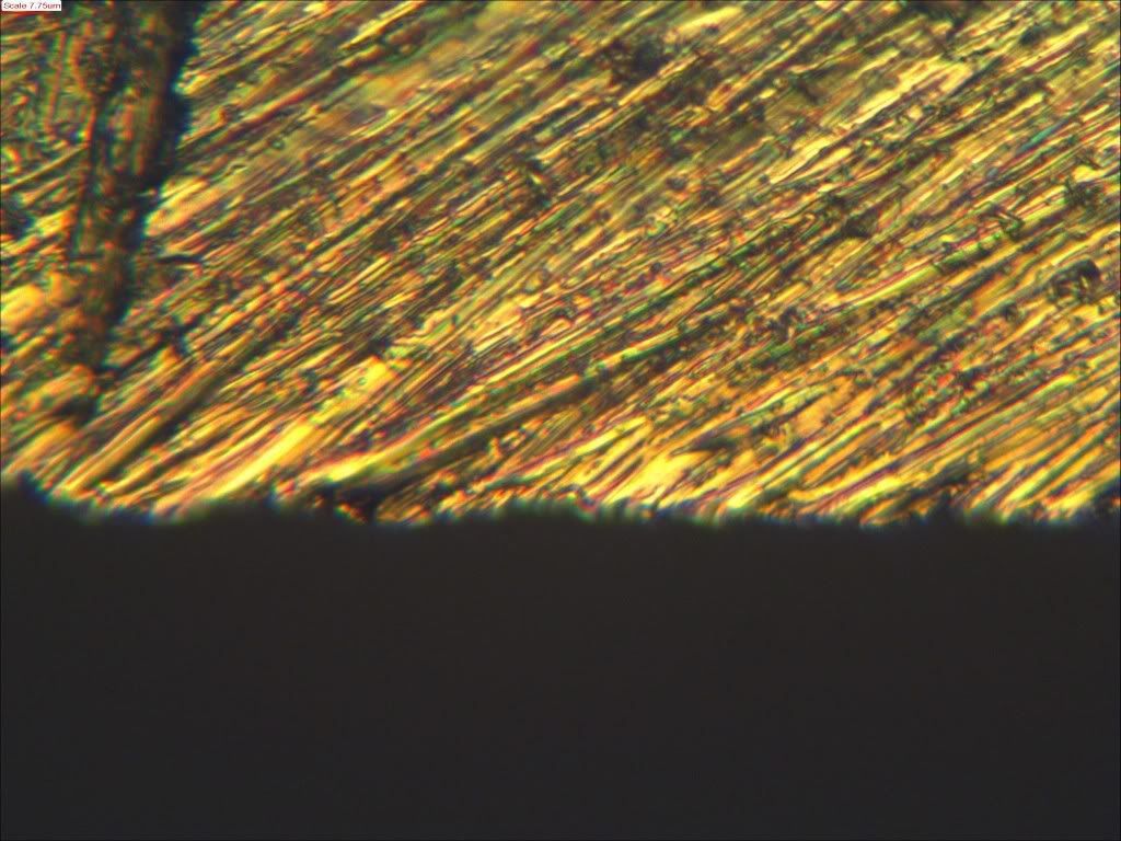

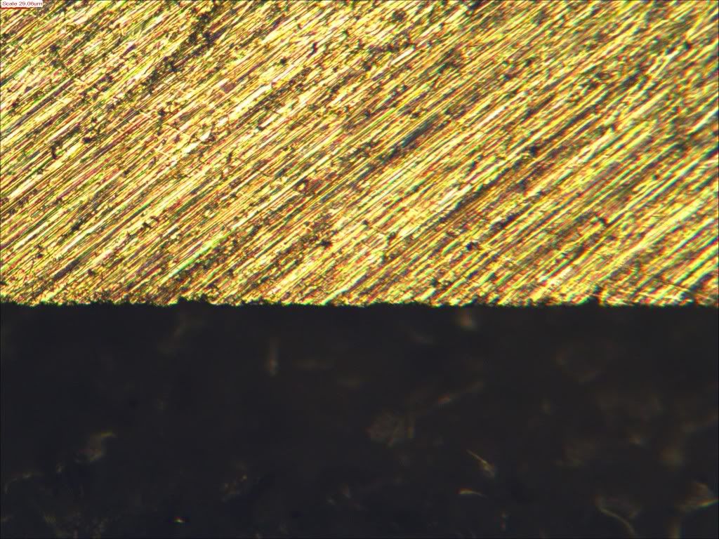

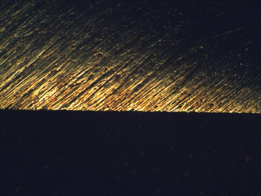

OK, this is about to get picture-heavy. Disclaimer, I really flew thru this - haven't taken a very close look at the images but did make some observations as I went. I have also never taken a close look at this topic.
First, I only used Aus8 on the India stone, and only used it edge-leading. Here's the reason - I was able to more or less completely remove the burr edge leading except for a few small bits hanging out in the low points. As I implied in an earlier post, complete removal of the burr generally involves some form of loose abrasive/lapping action, or the use of an extremely fine fixed abrasive. In the range of an India stone the abrasive is fixed in a block with fixed highs and lows - there is no way to get the abrasive highs and lows to match perfectly from side to side or pass to pass, therefore there will always be low points that have some unsupported steel left over from the last grinding pass, the high points will be relatively burr free. The resulting 'burr' will be very fragmented and feathery and (in my experience) need some form of post-grind finishing to completely de-burr. It is possible to get it down where it will not catch on a cotton ball, shave differently from side to side, catch on newsprint etc, stand only in very small patches when backdragged on wood - undetectable to the naked eye but just visible at 10-15x with strong lighting - not a problem. This is not unique to the India stone, but applies to virtually all firmly fixed abrasive media whether used edge leading or edge trailing (IMHO). Tools such as a waterstone or SiC stone are a bit different in that they shed a bit of loose abrasive that can accomodate itself to the existing grind texture in the steel and hit those low spots - without which some form of conformable media (or submicron fixed abrasive) will be needed. In any event the burrs I'm speaking of are not readily visible at 40, 160, 640, or 1600, but I could find them by shifting my light source at 15x.
Anyway, I attempted to do some edge trailing on the Aus8 steel on the India stone - marked the bevel with a Sharpie and swithched sides/pass - by the time the Sharpie was gone (approx 10-12 passes) a burr had formed that was impossible to reduce or remove (though it was extremely small - still much larger than the tattered micro remnants from the edge leading test. I didn't bother with images as I felt the prep hadn't made it past the starting line.
These are the images with scale for 160, 640, and 1600 - the gouge is a very deep scratch from me correcting the uneven factory bevels with an 80 grit stone:

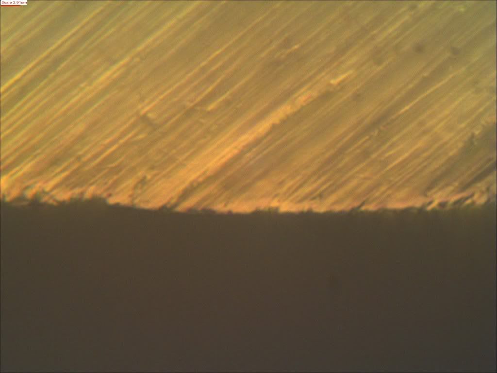

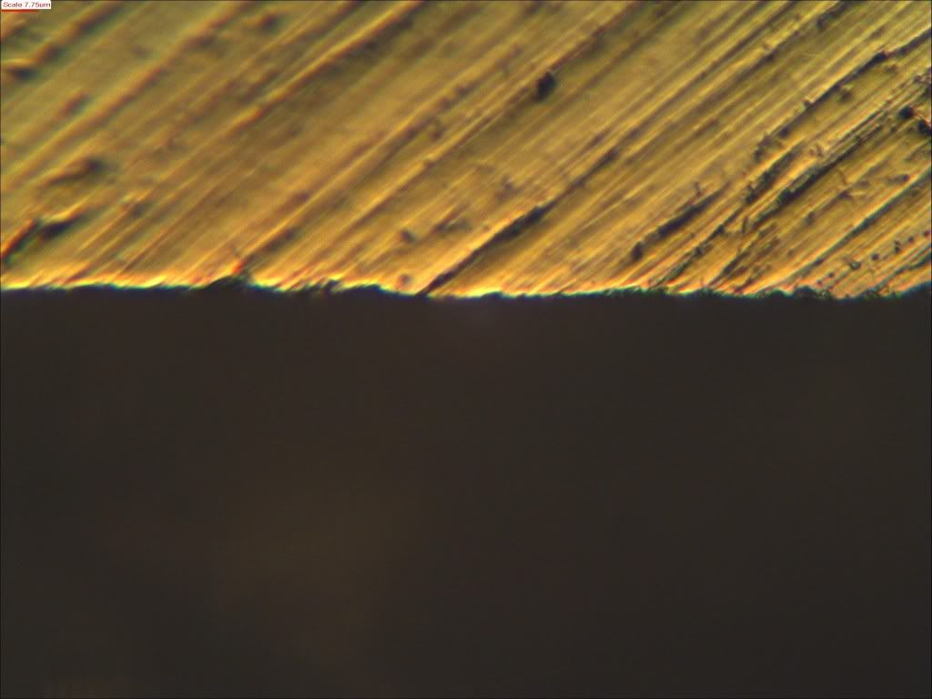

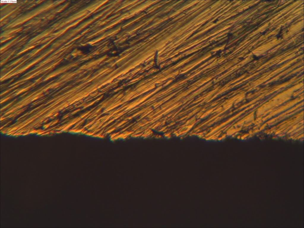

Related - I took images of a Mora Classic that had been sharpened edge leading on a fine Norton Crystalon and finished off with a 500 grit silicon carbide jointer stone, resin bonded - bothe edge trailing and edge leading. This stone is relatively 'soft' - sheds some abrasive and binder as it goes - and can be used to deburr fairly completely. Since the current discussion has come to the differences btwn edge leading and edge trailing I thought I'd include these images as well. Should be noted there was very little difference in how well these edges performed for a handful of cut tests (crossgrain newsprint, arm hair, cardboard). Interesting note - the edge trailing appear to show some unsupported metal on the high points in the grind structure, edge leading appear to show unsupported metal in the low points (including the Aus8 India images). Part of this might be the inclusive angle on the Mora is only 23 degrees or so opposed to the 28 the Aus8 is set at.
First set is edge trailing:
Next are edge leading - same stone:

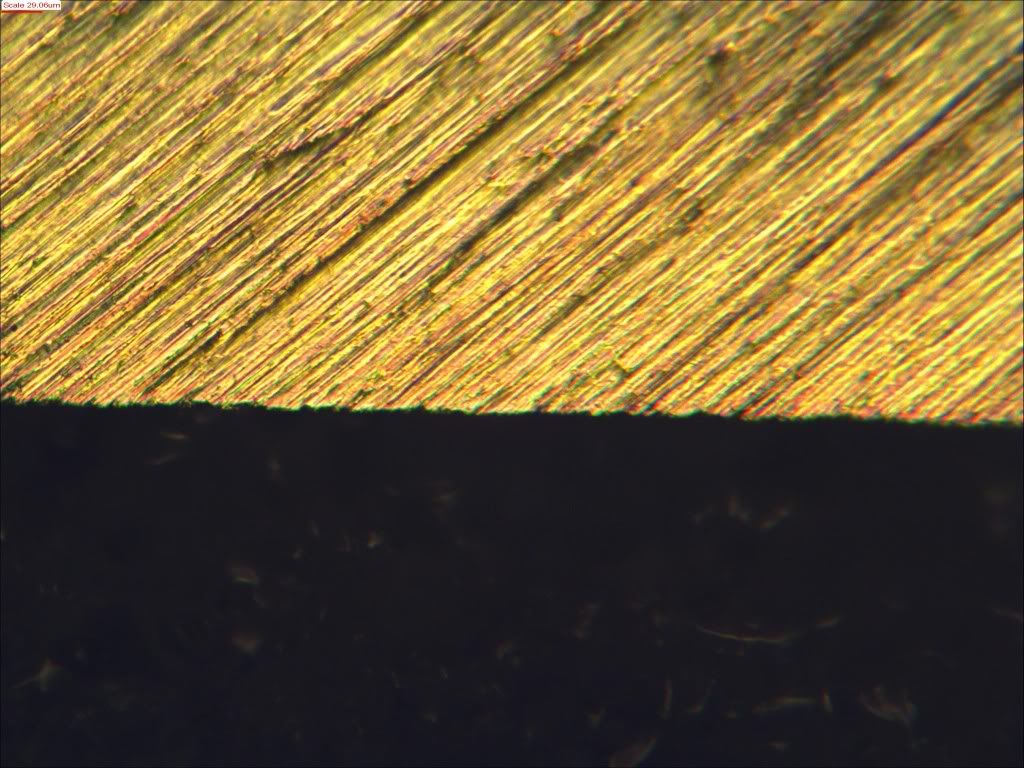

And to add a bit more to the mix, here's the same edge stropped with loose abrasive from the same 500 grit stone applied to a sheet on newspaper wrapped around the same stone.
The apex line appears to be much more unified - less trace of any unsupported steel.
Finally, the same edge stropped with white compound on newspaper - a bit more unified still. Not as big a visual improvement over the previous as one might think, tho a noticeable improvement in how well it tree-topped leg hair:
One thing I notice is that edge trailing on a firm stone seems to make the apex less uniform than going edge leading. Other thing is that stropping (at least with an abrasive) even on a surface as firm as a single sheet of paper wrapped around a stone, results in a large increase in apex uniformity.
what im getting from this is that i need to get better at maintaining consistent angles while sharpening. (i freehand on stones, dont have a guided rig or a strop).
still, this satisfies that geeky part of my nature. thanks!

Couple thoughts to add - because the edge leading had no post grind finishing its impossible to tell if the 'lip' architecture you highlight mightn't be present but concealed under some loose metal. That is, the highlights from your three 'lip' details are not consistent along the length of the bevel. They appear to wind over and presumably shift to the backside where they are no longer visible from the front. This could easily be present but not obvious on all the samples and would actually make sense - not surprising one might have micron swaying back and forth along the line of the theoretical perfectly straight apex as viewed edge on. Along this line of thinking ---
Additionally, among those samples there are a number of highlight areas that progress along the upper edge of a grind ridge and do not dim or fade as they link to the highlight on the apex - bridging the low point on the lip - yet its doubtful the bevel thickness or focal depth could accommodate such a combination of seemingly opposite characteristics. There are also some darker low areas that proceed straight to the apex with no change even where they should be climbing the lip and coming back into a highlight region. There's a reason most serious studies of edge geometry do not rely on optical microscopes, even metallurgical ones - preferring the SEM even at modest magnification levels. Controlling for the lighting becomes very tricky at higher magnification.
That said, even if there is a swaying of the apex to one side or the other at this scale, I cannot find any evidence this leads to a weaker edge in use. My stropped machetes and hatchets amaze me at their cutting performance and ability to keep cutting well even after much abuse, all of them stropped either on a waterstone or abrasive impregnated paper.
I have no idea at what grit value a burr could be removed by backhoning on a hard stone, but my experience is that it might not be possible. I do believe one can polish an already clean edge by backhoning on a very fine stone, but a quick check of some of the straight razor forums will make one very dubious of this technique - at least on a firmly fixed abrasive (tho even they would not consider a blade shave ready until it had been stropped). My guess though, is that if I were to take this edge up to a fine Spyderco ceramic I could polish backhoning on an EF. Not sure if this is where the discussion leads tho. As a side note Verhoeven did no cut tests - anyone familiar with most varieties of waterstones will be rather emphatic re the benefits of finishing with some edge trailing.

Rapid loop through each abrasive, each time the same knife will be forced dull by gentle slice into a rock. Test when ready - 5 slices to newsprint/catalog-paper at 20-45* cross grain determines pass/fail sharpness for each attempt. multiple torns = fail.
Endura vg-10 is known to have tough burr, let's see how this test turn out.
Anyone - Interested/thoughts/suggestions?
