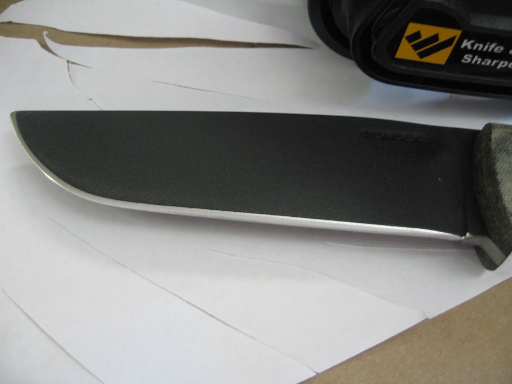

Well, just found a work sharp that I had been given as a gift a few years ago and was hiding away. Tested it out on a couple of cheap knives Did not want to destroy a Busse. Seemed to do a decent job on the Condor. Paper cutting sharp and shaving sharp just not super polished sharp but it is sharp and will shave all the hair on your arm if you kept going.
Could see where it would be useful to re-profile a damaged edge. The plastic edge guide is a little flimsy .
Going to get the KME and give it a try. Spoke to them and they said up to a 10" blade on the KME
