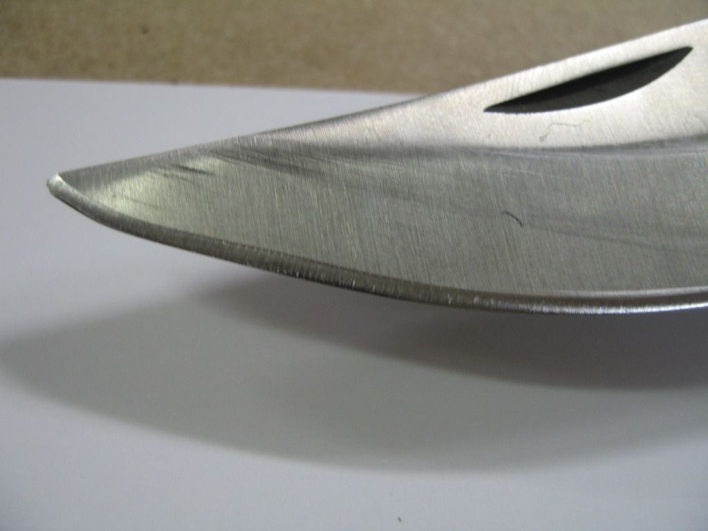

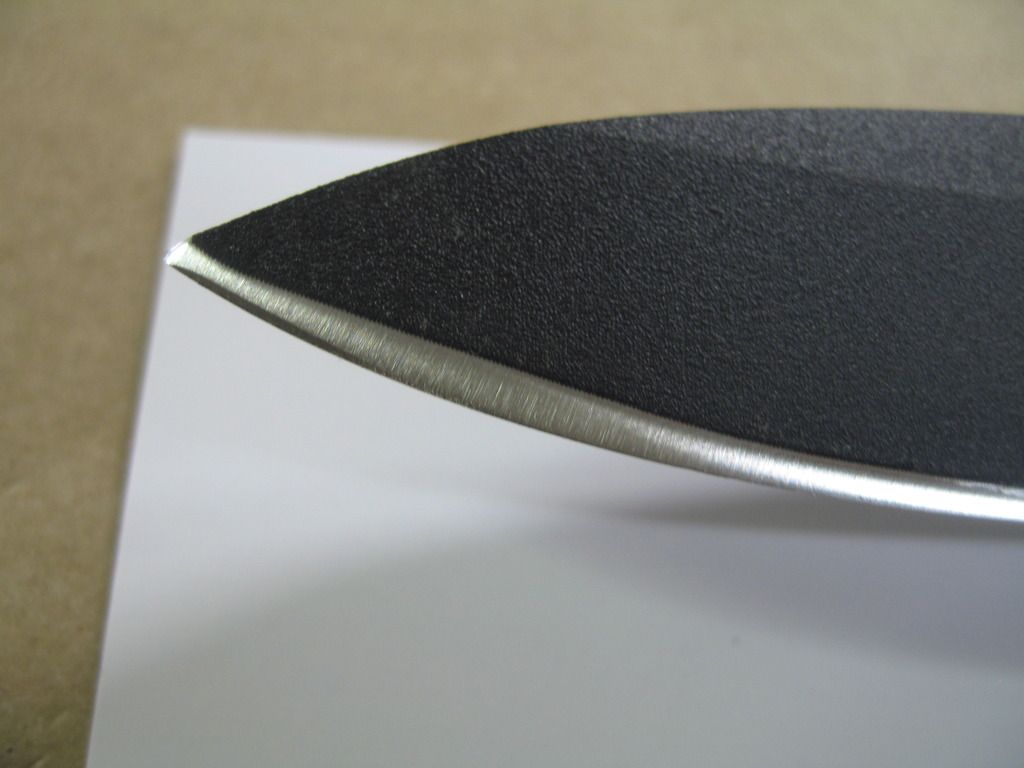

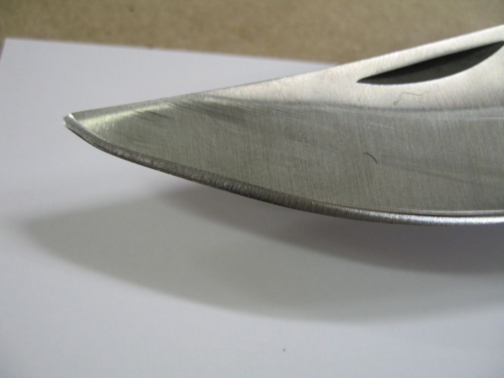

Sorry to hear that. I had the same problem today with the tip. Luckily I was using cheap throwaway chinese pocket knives. I really chewed one tip up badly. Don't think I am going to let my Busse anywhere near this Work Sharp until I have mastered it a little better and may just wait for the KME to arrive.
One chewed up tip on the junker folder and one sort of chewed up tip on a cold steel cheap model 80 true flight thrower.
The only one that worked well was the Condor. All knives are shaving sharp.

Looks like it recurved the tip!
What you could try is to tilt the blade as you get towards the tip so that a more obtuse angle is ground in.
Due to variance in blade width from heel to tip, most tips will be more obtuse relative to the rest of the edge because the taper from spine to edge is not as wide there, and you are grinding onto thicker steel.
If the angle of work is kept equal, you will have to grind a lot more at the tip. If you adjust with the taper, you will have an edge that is aesthetically even but accommodates variance of thickness in the grind.

Thanks! This sounds good👍 Will give it another try tomorrow, getting late😴
I did not round the tip on the worksharp, that was from stabbing another knife.. Not the greatest idea

Appreciate the help. I did tilt to follow the curve to the tip but that work sharp guide is a little flimsy and something must have gone wrong in the process. Going to give it a try on a couple more cheap knives. That is what those cheap knives are best at, sharpening test dummies.
