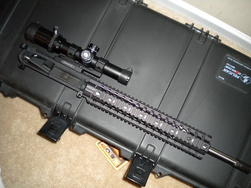

I've built 2 uppers...you definitely won't save any money, but you get it exactly like you want it. I used VLTOR uppers on both, BCM 16" midlength barrels (1 in 8" Stainless and 1 in 7" CHF), VLTOR gas blocks pinned using a mill, Battle comp 1.0 on both, 11' Centurion arms rails on both, BCM bolt and LMT bolt. I have them both on S&W lowers that have G&R lower parts kits. Softest shooting uppers I've ever shot, but pretty heavy especially since I run 1-4x scopes on both most of the time. Good luck building. I had a lot off fun building these. I will say that I shoot my Noveske carbine more than any of these two, but mainly because of weight.
w/ stainless barrel other one looks exactly the same except CHF barrel.
